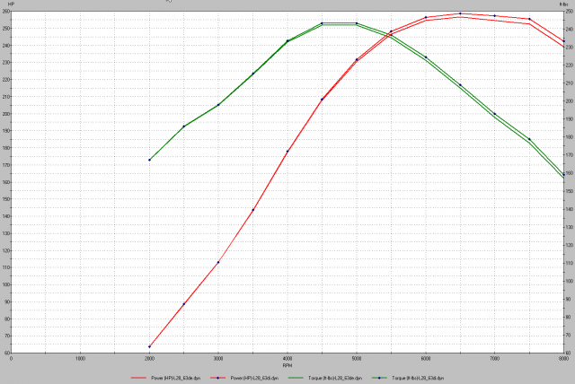

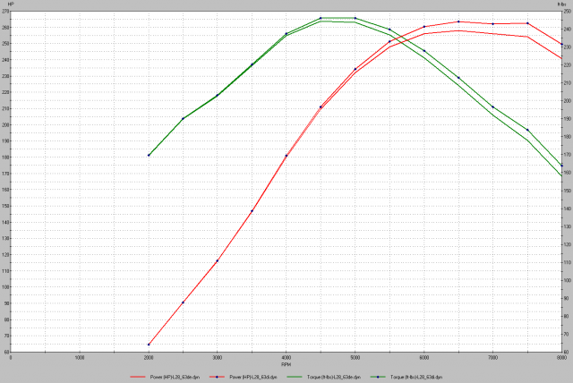

theczechone Posted May 30, 2018 Share Posted May 30, 2018 Talk with Dave if you are thinking of going with his cams, he's quite helpful. As far 540 or 480 lift the difference will be negligible unless you have done quite a bit of porting. And it's a small gain for a lot of added complexity. I just got the 480 cam because i am doing an amateur port job and just learning as i go, plus less than $500 for cam regrind, lash pads, springs, and rockers resurfaced... tough to beat that. BTW this is plotted on 87mm bore 79mm stroke L28 with 10.5 static CR n42 stock flow n42 ported flow Quote Link to comment Share on other sites More sharing options...
turbogrill Posted May 31, 2018 Author Share Posted May 31, 2018 On 5/30/2018 at 5:19 PM, theczechone said: Talk with Dave if you are thinking of going with his cams, he's quite helpful. As far 540 or 480 lift the difference will be negligible unless you have done quite a bit of porting. And it's a small gain for a lot of added complexity. I just got the 480 cam because i am doing an amateur port job and just learning as i go, plus less than $500 for cam regrind, lash pads, springs, and rockers resurfaced... tough to beat that. BTW this is plotted on 87mm bore 79mm stroke L28 with 10.5 static CR n42 stock flow n42 ported flow Expand That's some cool graphs. How did you calculate them? Did you estimate the 0.50" lift? Quote Link to comment Share on other sites More sharing options...
JMortensen Posted May 31, 2018 Share Posted May 31, 2018 (edited) What are these graphs supposed to show? HP and torque with the .480 vs .540 cams on stock and ported heads? If that's what it's supposed to be, I have to say I don't think they're very accurate at all. My takeaway from these graphs would be that porting is a waste of money, but my personal experience and the experience of a lot of the people on this and other forums is that the L heads benefit A LOT from porting. Put in a couple grand on porting and looks like you're estimating 7 hp and 7 lb ft return. Same on the camshaft itself. If going with .060" more lift nets you 7 hp, I think the larger cam profile is leaving something to be desired. As to the original question of which cam to use, I think .480 is right in that zone where you have to do the work anyway (needs different valve springs and retainers and stem seals to prevent coil bind and prevent the retainer hitting the seal). If you're going that far, I'd spring for the bigger cam. And if those cams only have 5 hp peak difference between them, find a better larger cam. Edited May 31, 2018 by JMortensen Quote Link to comment Share on other sites More sharing options...

theczechone Posted May 31, 2018 Share Posted May 31, 2018 On 5/31/2018 at 3:16 PM, JMortensen said: What are these graphs supposed to show? HP and torque with the .480 vs .540 cams on stock and ported heads? If that's what it's supposed to be, I have to say I don't think they're very accurate at all. My takeaway from these graphs would be that porting is a waste of money, but my personal experience and the experience of a lot of the people on this and other forums is that the L heads benefit A LOT from porting. Put in a couple grand on porting and looks like you're estimating 7 hp and 7 lb ft return. Same on the camshaft itself. If going with .060" more lift nets you 7 hp, I think the larger cam profile is leaving something to be desired. As to the original question of which cam to use, I think .480 is right in that zone where you have to do the work anyway (needs different valve springs and retainers and stem seals to prevent coil bind and prevent the retainer hitting the seal). If you're going that far, I'd spring for the bigger cam. And if those cams only have 5 hp peak difference between them, find a better larger cam. Expand If you have some port flow numbers for stock and ported heads I’ll gladly update my plots. But this is the numbers I was able to find. keep in mind that larger cam will make less torque but peak will happen at higher engine speed therefore generating higher horsepower. Big cams benefit from high compression ratios, 10.5 is relatively low. So unless you’re changing other components the net benefit of a larger cam is low and kills drivability. Quote Link to comment Share on other sites More sharing options...

theczechone Posted June 4, 2018 Share Posted June 4, 2018 On 5/31/2018 at 12:27 PM, turbogrill said: That's some cool graphs. How did you calculate them? Did you estimate the 0.50" lift? Expand You can generate them with DesktopDyno it's a simple math based program but it can show trends. It's not perfect but you can learn a lot about the effects of changing components on your engine. Quote Link to comment Share on other sites More sharing options...
JMortensen Posted June 4, 2018 Share Posted June 4, 2018 (edited) Fair enough, I can see how just a peak flow wouldn't be sufficient. I think something that is fairly instructive though is zredbaron's first stroker build which IIRC has had a small cam and no porting and made something pitiful like 160 whp vs his current one with the ported head and very particular cam profile that puts out 270 whp. He's a details guy, might PM him and see if he still has the rest of the specs you need on those flow numbers. Edited June 4, 2018 by JMortensen Quote Link to comment Share on other sites More sharing options...
