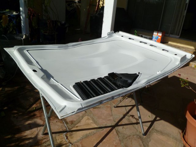

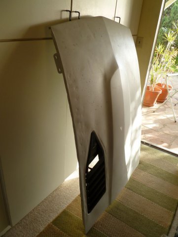

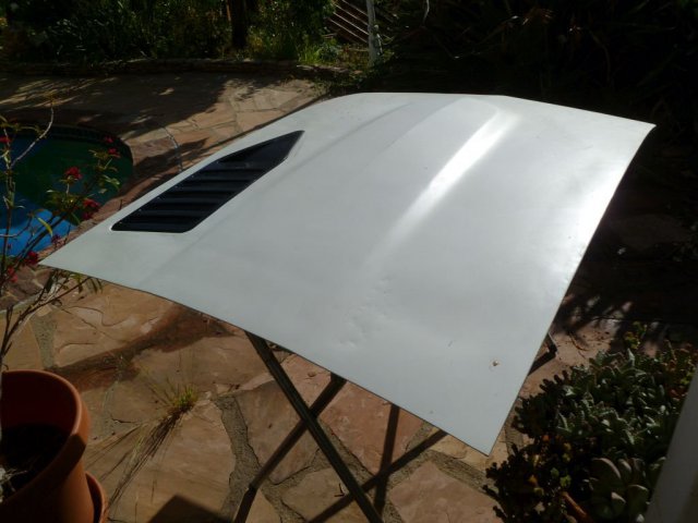

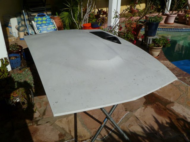

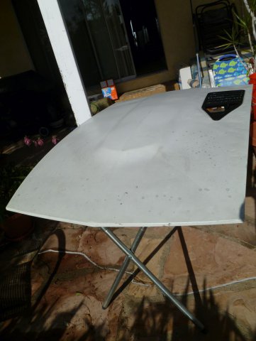

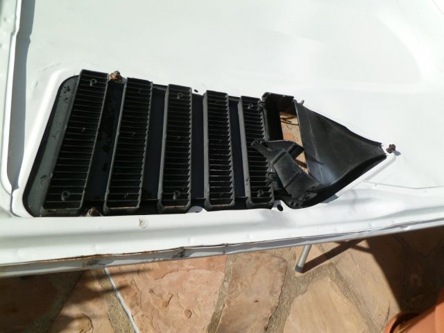

Nelsonian Posted June 26, 2018 Share Posted June 26, 2018 (edited) Originally I was building a pretty stout L28et and had purchased both the drivers side Naca duct and regular passenger side vent from a 280ZX being parted with the intent to weld onto my stock 240Z hood. I had the sellers cut a little extra metal border so that I could retain the factory beveled contour and weld these in to look flush and as if the factory had made it. about half way through plans changed and I sold all my L engine parts and went with a Toyota 2JZGTE which has the turbo and intake on opposing sides. I think the 280ZX style ducted/vented style hood would be beneficial for all L series engines (turbo or NA) allowing cooling air on the drivers side in and at slow to idling speeds venting out hot trapped air on the passenger side. Just my 2 cents worth... Edited June 26, 2018 by Nelsonian Quote Link to comment Share on other sites More sharing options...

rooger82 Posted June 26, 2018 Author Share Posted June 26, 2018 16 hours ago, Nelsonian said: Originally I was building a pretty stout L28et and had purchased both the drivers side Naca duct and regular passenger side vent from a 280ZX being parted with the intent to weld onto my stock 240Z hood. I had the sellers cut a little extra metal border so that I could retain the factory beveled contour and weld these in to look flush and as if the factory had made it. about half way through plans changed and I sold all my L engine parts and went with a Toyota 2JZGTE which has the turbo and intake on opposing sides. I think the 280ZX style ducted/vented style hood would be beneficial for all L series engines (turbo or NA) allowing cooling air on the drivers side in and at slow to idling speeds venting out hot trapped air on the passenger side. Just my 2 cents worth... So a 280zx vented hood on the S30. Maybe with the 2 vents for the sake of symmetry. Quote Link to comment Share on other sites More sharing options...
