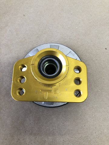

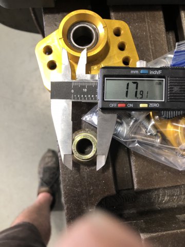

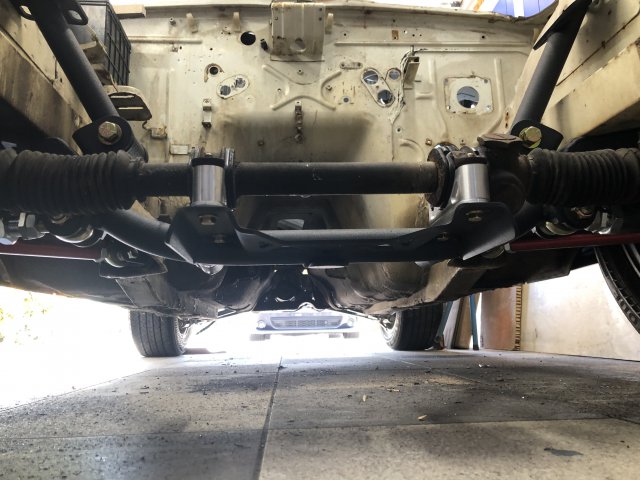

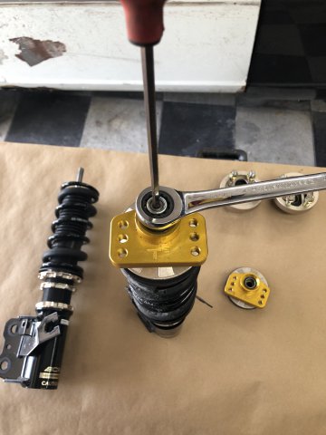

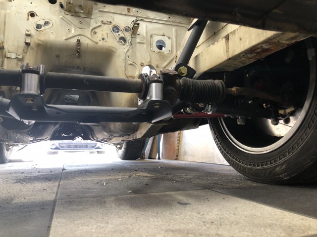

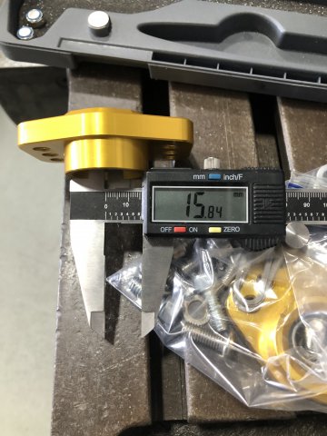

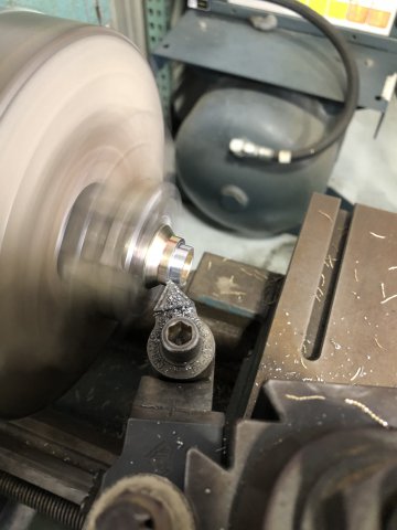

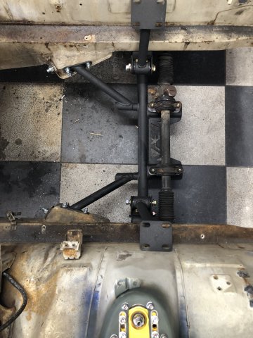

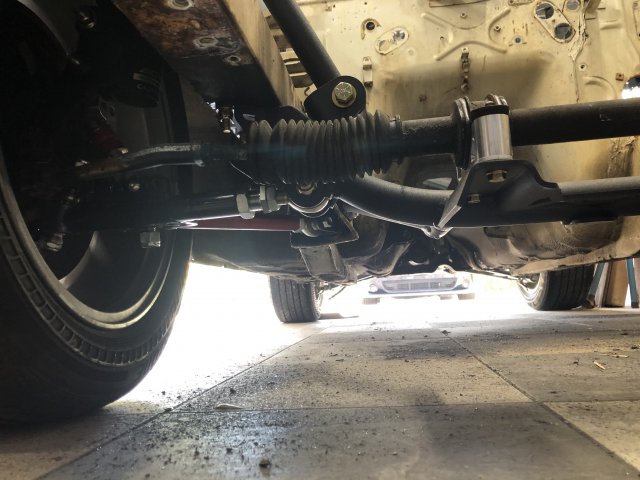

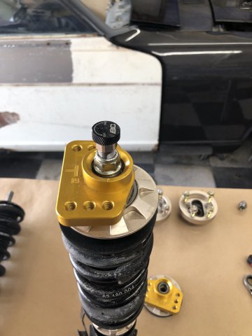

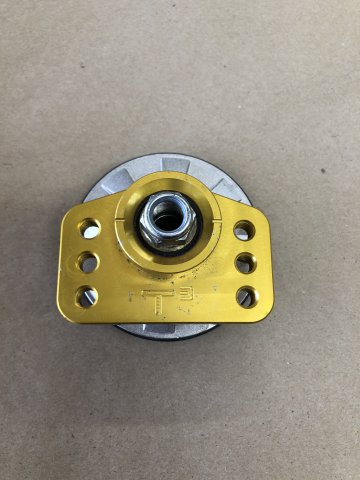

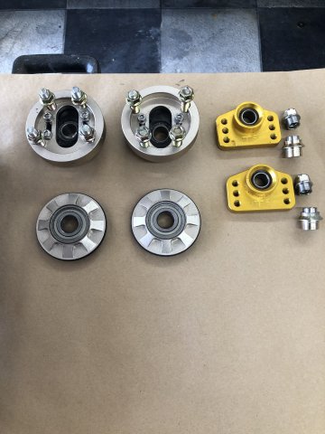

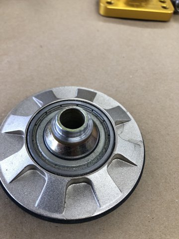

Jethoncho Posted March 1, 2019 Author Share Posted March 1, 2019 Okay, the project for today was to finish mocking up the front suspension. First, I removed the OEM crossmember and installed an Apex Engineered crossmember with tension rod stiffeners/braces. I can’t say enough good about this component assembly, it fits and looks good doing so. Next, I cut the top of my strut towers and welded in my T3 camber plates. The T3 camber plates are not “out of the box” compatible with my BC Coilovers and the hardware T3 supplies to allow the use of their camber plates with the BC stuff is good but I wanted to use the BC hardware so it had to be modified. I put the strut nuts and upper locator bushing on the lathe and turned them down so they would fit in the T3 camber plate (BC was 17.91mm and inner diameter of the T3 camber plate bearing is 15.84mm) once the nut sleeve and sleeve on the upper bushing was turned down to 15.75 they fit snug. Then I reassembled and reinstalled the BC Coilovers and did a rough alignment to ensure I was able to get specs...I have plenty of adjustability and I’m sure once this stuff finally gets installed permanently and put on an alignment machine we will get well within specs. I’m still waiting on Apex to supply my custom outer tie rods, then I will remove the rack (again) and clean it up, repair as necessary, paint and install new inner tie rods, boots and the new Apex out tie rods. Quote Link to comment Share on other sites More sharing options...
