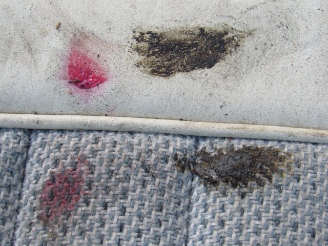

grannyknot Posted August 14, 2018 Share Posted August 14, 2018 I have a can of Brakekleen and the old seat covers I just replaced so maybe I'll rub some grease into them and then try to get it out, I'll post some pics. Brakekleen smells exactly like the old dry cleaning fluid they used before it was banned. Quote Link to comment Share on other sites More sharing options...

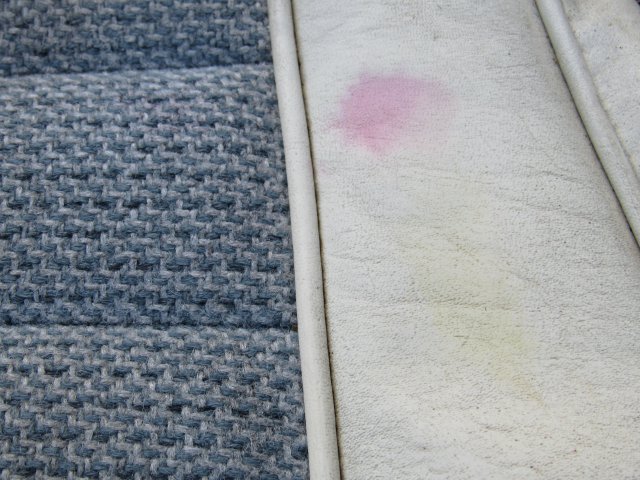

grannyknot Posted September 15, 2018 Share Posted September 15, 2018 I thought I would give it a full month to let the grease soak in, the red grease is Redline assembly lube, the dark grease is from wiping my finger around the ball joint of my DD. The fabric came out much better than I thought it would, there is still a light stain from the dark grease and the Redline is almost certainly just the dye in the lube. If these were cleaned off soon after it happened I'm sure you would see no traces. This was done with clean white T shirt cotton and Brakekleen, keep rubbing until the cotton comes away clean. 1 Quote Link to comment Share on other sites More sharing options...
jhm Posted September 16, 2018 Share Posted September 16, 2018 Thx for the "acid test". I believe you are correct that Brakeleen is similar chemical composition as dry-cleaning fluid....I believe that is what originally turned me onto it for cleaning interior stains. I had spilled gasoline on an interior carpet, and Brakekleen was the only product that actually cleaned it and removed all gas odor....nothing else I tried removed the odor. Quote Link to comment Share on other sites More sharing options...
