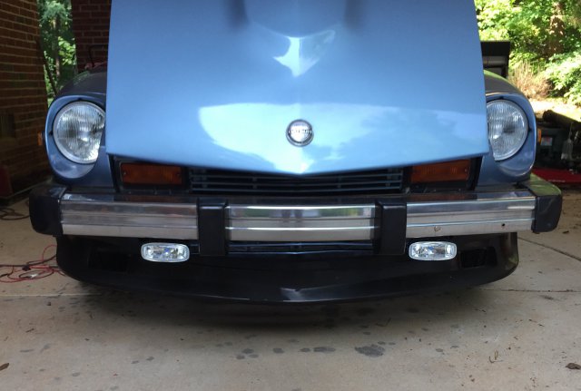

D9inger Posted March 22, 2019 Share Posted March 22, 2019 On 3/22/2019 at 4:30 PM, Sandy455 said: Thanks for all the suggestions. One thing I didn't mention above is that due to the fact I track my car regularly, I have installed plastic headlight covers to help my aero and prevent flying debris from taking out my headlights at over 100 mph. To that end, new high tech headlights would still need to beam through these scratched covers which also fog up a bit during the winter. So I'm really only concentrating on adding fog lights with protective plastic covers. Expand I put these on my Z, they're not LED yet but I've been looking for an LED replacement bulb that will fit. http://www.piaa.com/store/p/71-2100XT-Fog-XTreme-White-Plus-Halogen.aspx Quote Link to comment Share on other sites More sharing options...

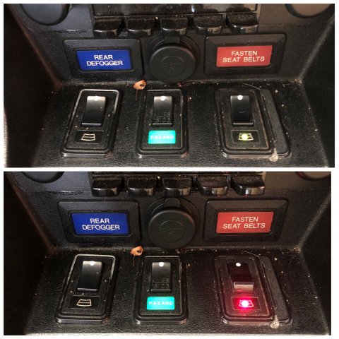

Sandy455 Posted March 23, 2019 Author Share Posted March 23, 2019 On 3/22/2019 at 8:57 PM, D9inger said: I put these on my Z, they're not LED yet but I've been looking for an LED replacement bulb that will fit. http://www.piaa.com/store/p/71-2100XT-Fog-XTreme-White-Plus-Halogen.aspx Expand Very nice. Did you install an on/off dash switch to turn them on? Or do they go on when your headlights go on? Quote Link to comment Share on other sites More sharing options...
D9inger Posted March 23, 2019 Share Posted March 23, 2019 (edited) I bought a used rear defogger switch off eBay to control the relay that came with the lights and put it in the spot that looks like where power window switches would go to the right of the hazard switch in the center console. They can come on with just the parking lights and stay on with high and low beam. Green LED is off, red is on. Amazon has the light kit for ~$200 so don't order from PIAA. I saw somewhere online that Datsun made a foglight switch for the S30 but I never could find one for sale. The lights get very hot when they're on, they are metal and glass so nothing gets damaged except your hands when aiming them. I'd really like to find an LED replacement bulb that would fit. Edited March 23, 2019 by D9inger Quote Link to comment Share on other sites More sharing options...
