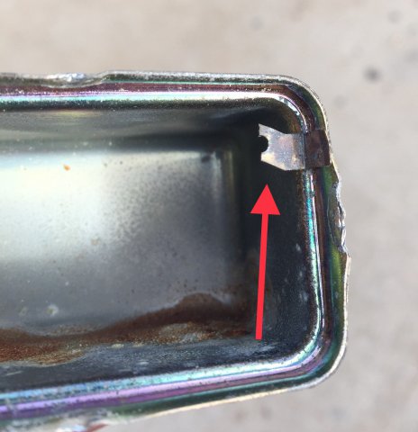

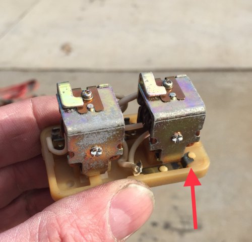

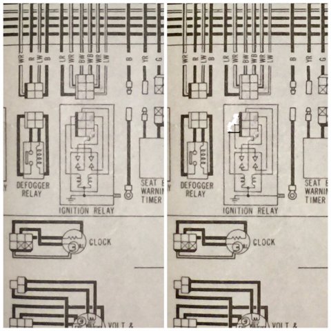

D9inger 2 Posted June 7, 2019 I had the same issue, it turned out to be the ignition relay. and the 1978 FSM is WRONG this is corrected Quote Share this post Link to post Share on other sites
D9inger 2 Posted June 7, 2019 (edited) This is what I found. The Ignition relay gets its ground through the mounting bracket and was intermittent. Edited June 7, 2019 by D9inger Quote Share this post Link to post Share on other sites

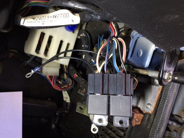

D9inger 2 Posted June 7, 2019 I couldn't find one so I just replaced it with two modern relays. Quote Share this post Link to post Share on other sites
