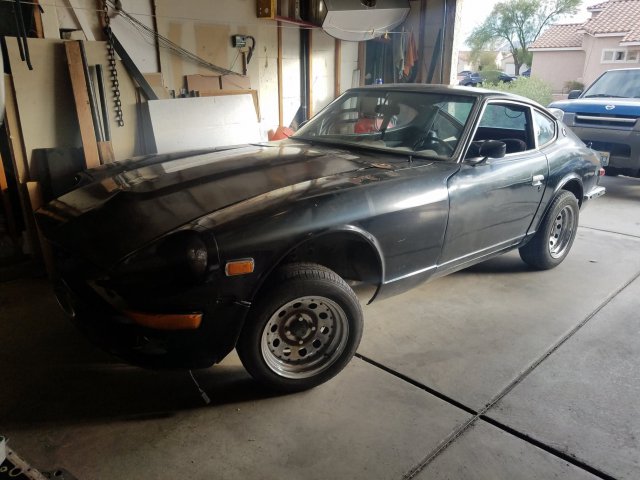

Meechum Posted June 19, 2019 Share Posted June 19, 2019 Good Evening, I have a 73' 240z that i plan on swapping in an Acura V6 Jseries motor in. I come from a Honda background and have always been intrigued with the motor. They come in 3.2, 3.5, and 3.7 Litre platforms in many "economy" vehicles from Honda and Acura. Anyways, Has anyone ever swapped one into theirs? I did the measurements and the motor will sit right behind the front strut towers. I plan to mate it to a CD009 trans and S550 Ford 8.8 (3.15 FD) IRS differential. Before any flak, I want to point out i bought the car as a rolling shell with pretty much nothing in it except the old r180 Diff. Rust in all the normal places, including the floor. Quote Link to comment Share on other sites More sharing options...

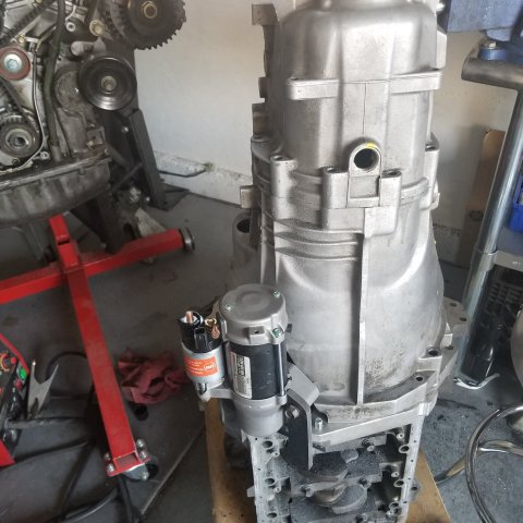

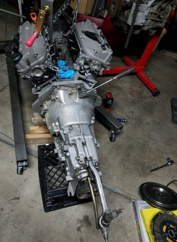

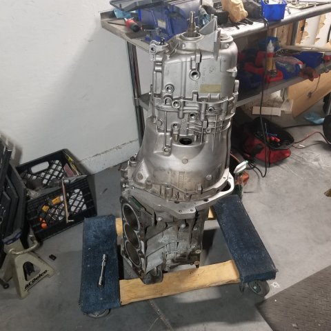

Meechum Posted June 19, 2019 Author Share Posted June 19, 2019 2 hours ago, JMortensen said: Sounds like a badass swap to me. My understanding is 325 whp is pretty easy to do NA. If you start thinking that isn't enough power, turbo it and make ridiculous power. BeastieHatch has a J swapped Civic and it's putting down 600 to the front wheels (now has electric motors on the rears too).https://www.turnology.com/features/beastie-hatchback-the-v6-turbo-powered-civic-to-end-all-civics/ If you know who Aaron O' Neal from English Racing, he is with his high horsepower Teal civic, Turbo Jswap 1/2 Mile drag car, him and i talk all the time. He occasionally comes down to Vegas to tune the evos and have a few beers. 1 hour ago, Neverdone said: You gonna be using something like this https://www.holley.com/products/drivetrain/bellhousings/bellhousings/honda/parts/RM-4096 Or, does someone make an adapter for the CD009 to the J series? As soon as you get the transmission sorted, I wouldn't see how this would be any more or less difficult then most of the other ridiculous swaps we come up with. Not quite. I've been talking with Bill Hincher for quite some time. He's been designing an adapter plate that seats the starter on the transmission side since there isn't really any place on the engine side besides under the oil pan, which i absolutely will not do. Here are some pictures of what i've been up to. I'm also designing my own dry sump setup along with a RWD config rear sump oil pan. The flange is 1/2" thick with all the mounting holes spot on. The kick out bracket is conceptual for a mechanical oil pump. I've mated a BMW ZF 5 speed trans to my current adapter plate. It uses a Honda B Series Flywheel and Clutch setup with a custom ACT clutch disc i contracted to have made. I've put that project on hold and just want to use the CD009 trans since I plan on turbo'ing the car. Pic of datsun is the day I got it. It's now somewhat torn down and i've built a chassis table so i can tube frame the car. Quote Link to comment Share on other sites More sharing options...

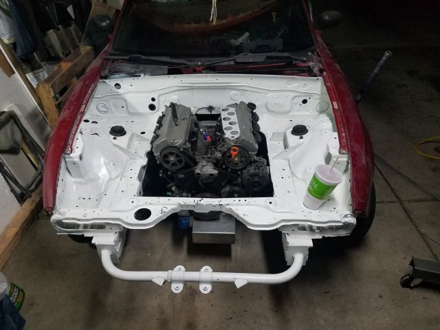

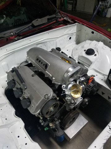

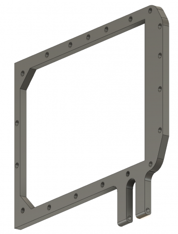

Meechum Posted June 19, 2019 Author Share Posted June 19, 2019 Sorry for the clutter, here are some more pictures of what i've been up to. Cardboard designed 5 qt rear sump oil pan for the Jmiata guys. I had an acrylic template made to show proof of design of my flange that the mounting holes fit for the dry sump or wet sump oil pans i'll be making. And 2 pics of the chassis table and my poor welding skills. Quote Link to comment Share on other sites More sharing options...
