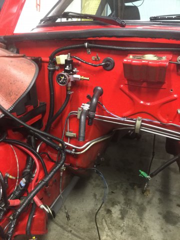

FPR is after the the tail . I could split the batch. I have the hot running to the fuse box , just got lazy because MS said it was okay to run all 6 with one hot. Need to get sequential going , but this should work unless the demand can’t be met with a bigger engine . I do have some kind of oil issue from a seal or something . Maybe get away with swapping intake valve guide seal on #6 will help
