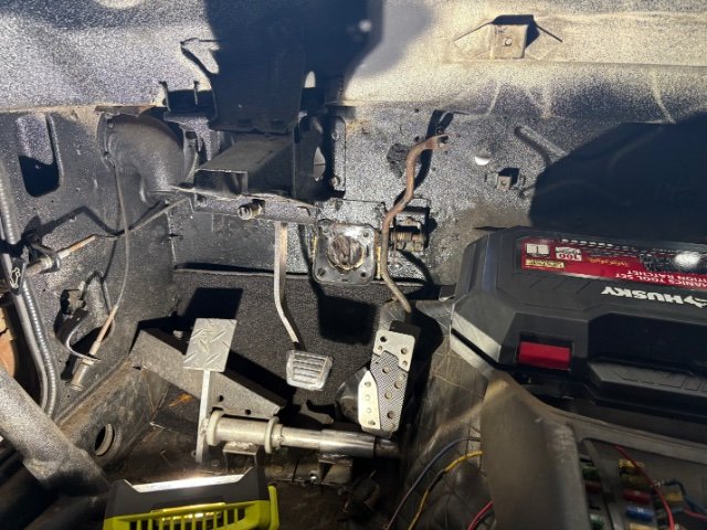

FastFloridian Posted May 10 Author Share Posted May 10 I’m hoping to get some work done on the car this weekend. So close to being done with tearing stuff down and ready to add stuff. Just got this dual master cylinder kit that I hope I can make work. It’ll let me adjust front/rear brake bias in the car. Quote Link to comment Share on other sites More sharing options...

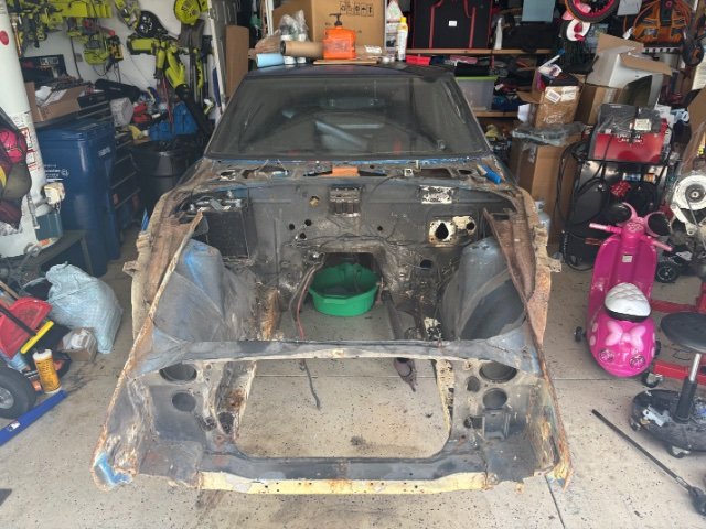

FastFloridian Posted Saturday at 06:00 PM Author Share Posted Saturday at 06:00 PM (edited) Got the front suspension and sway bar off today. Fought me a little bit, but impact helped a lot and had to take a sawzall to the toe arms, but it’s all out. Edited Saturday at 06:01 PM by FastFloridian Quote Link to comment Share on other sites More sharing options...

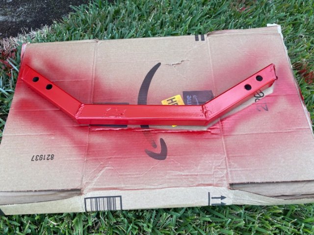

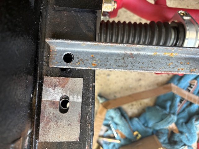

FastFloridian Posted Tuesday at 08:49 PM Author Share Posted Tuesday at 08:49 PM On 5/12/2025 at 7:15 AM, 74_5.0L_Z said: Do you plan to do any chassis reinforcement? Cage? Car had a cage already when I bought it. I’ve got a front strut brace that also ties into the firewall (apex), and braces on the inside of the fenders I’ll be welding on soon (apex also). Debating whether I need to beef up the frame rail or not since I’ve got the cage. Below is a pic when I bought it last year that shows the cage a little. Quote Link to comment Share on other sites More sharing options...
