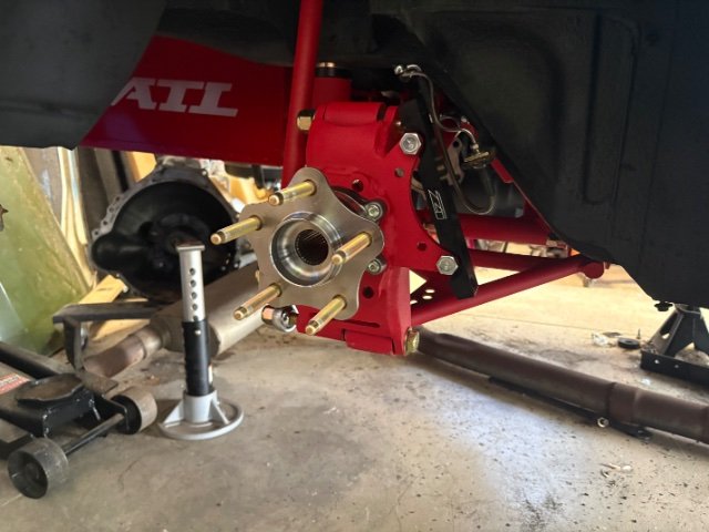

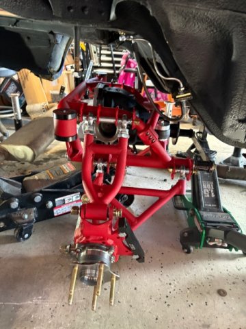

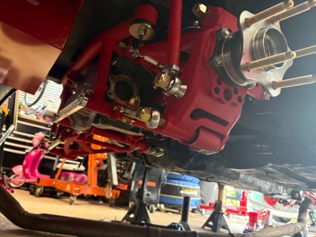

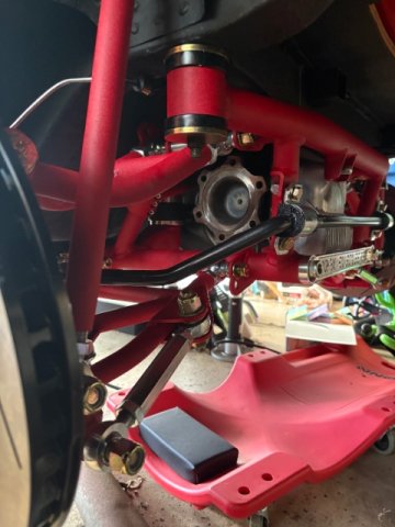

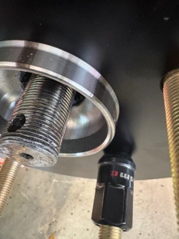

FastFloridian Posted November 15 Author Share Posted November 15 Got a lot of the rear track attack kit put together today. It went together pretty well, their videos are very helpful. Only minor issue was these lock washers being too big, just ground them down a bit. 2 Quote Link to comment Share on other sites More sharing options...

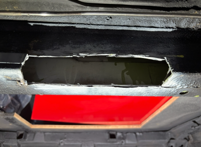

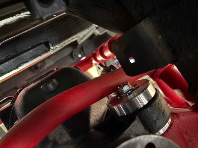

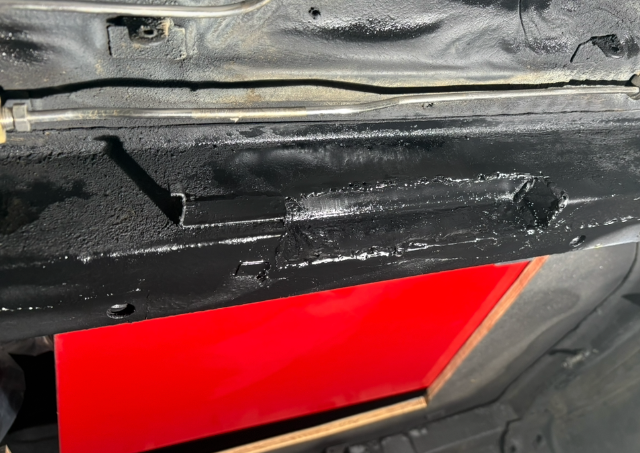

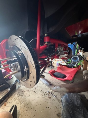

FastFloridian Posted November 27 Author Share Posted November 27 Waiting on a few parts, but worked on the rear suspension. I cut out a rear strut bar that was welded in and started prepping to install the rear shocks. Also test fitted the rear differential, almost ready to bolt up. Quote Link to comment Share on other sites More sharing options...
jhm Posted November 27 Share Posted November 27 Wow, great progress! I love the cantilever design on the rear suspension. A few guys here have previously designed their own custom cantilevers; but AE is the only vendor that I'm aware of that has ever "mass produced" a system like this. Really interested to hear your feedback on how the whole TA package works once installed. Is that the final resting place for the fuel cell? If so, are you going to have a way to isolate it from the rest of the driver's compartment? 1 Quote Link to comment Share on other sites More sharing options...

FastFloridian Posted November 27 Author Share Posted November 27 2 hours ago, jhm said: Wow, great progress! I love the cantilever design on the rear suspension. A few guys here have previously designed their own custom cantilevers; but AE is the only vendor that I'm aware of that has ever "mass produced" a system like this. Really interested to hear your feedback on how the whole TA package works once installed. Is that the final resting place for the fuel cell? If so, are you going to have a way to isolate it from the rest of the driver's compartment? Thanks. That’s the fuel cell that came with the car, it’s too big (20 gal) and I don’t like it mounted on top of hatch floor. Going to explore Black Friday deals, thinking of going with an ATL because of the bladder and other safety features and I’ll recess it down as far as I can, hopefully it’ll sit flush. Trying to decide if I should go with 10 gal or 12 gal, 12 gal is a little cheaper for whatever reason. I should burn approx 5 gal a session at Sebring, the track I’ll frequent most. 1 Quote Link to comment Share on other sites More sharing options...

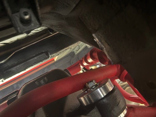

74_5.0L_Z Posted November 29 Share Posted November 29 (edited) I have the ATL 12 gallon cell in mine. I also use the ATL Black Box sump with pump. The fuel return dumps into the top of the Black Box. I can use pretty much every drop of fuel in the cell without fear of starvation. My cell is below the rear deck and offset to the right for weight distribution reasons. You can just see the bottom of the cell in this picture: Edited November 29 by 74_5.0L_Z 1 1 Quote Link to comment Share on other sites More sharing options...

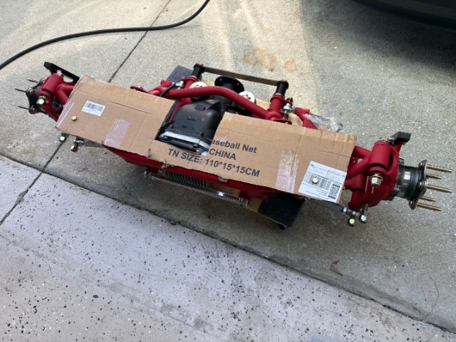

FastFloridian Posted November 29 Author Share Posted November 29 (edited) I replaced the stock 370Z diff cover with a Nismo one, and got it bolted and torqued to the subframe. Edited November 29 by FastFloridian 1 Quote Link to comment Share on other sites More sharing options...

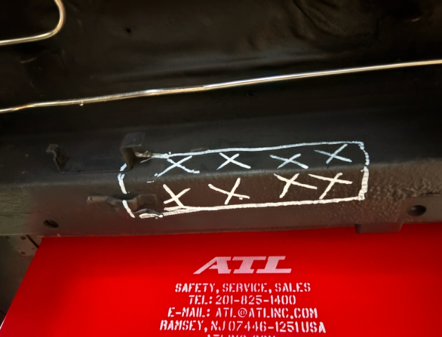

FastFloridian Posted Sunday at 05:05 PM Author Share Posted Sunday at 05:05 PM I got a little bit of garage time today. Removed the old fuel cell and got the new one in. I still need to build a frame for it, but it can sit here for a while. Rear subframe bushings came in yesterday, I’ll try and get the rear end mounted next weekend. 1 Quote Link to comment Share on other sites More sharing options...
