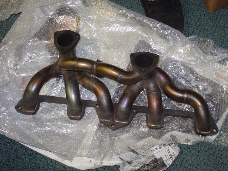

Alright, talking with a buddy of mine, we were messing around with speed options that were pretty insane...until i threw out a plausable idea...twin turbo L31, i know its nothing new, but the turbines I'd want to use are....
Forced Performance Big28, they're a T25/28 hybrid that can push out 325rwhp with max boost @ 3200rpm and a 22psi eff. rating (these stats are from an SR20)
Two of them on a 3.1L ....would it be a casket on wheels? or would someone want to/be able to fab up a manifold with proper flanges?
