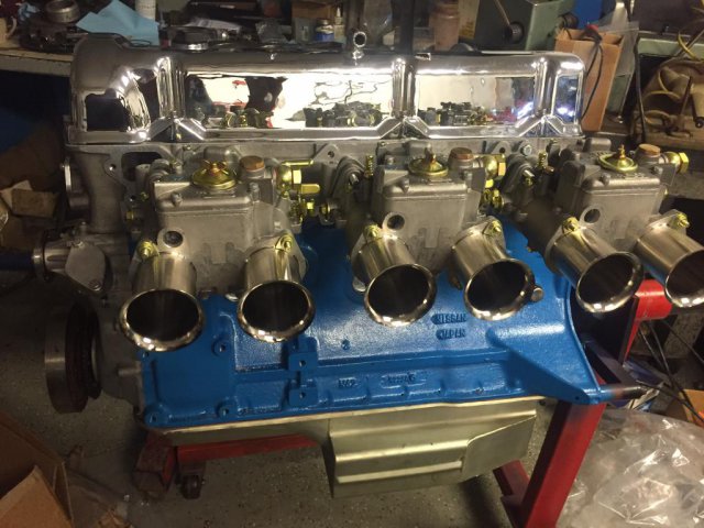

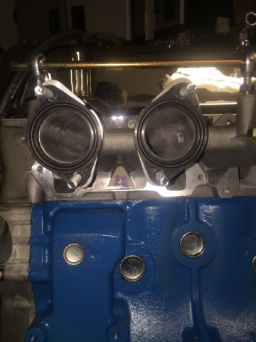

zredbaron Posted September 19, 2016 Author Share Posted September 19, 2016 (edited) Final assembly pics before engine dyno. Getting close! The second pic shows that Joe "pinned" the intake manifold to the head to ensure the ports are aligned. (The purple marking.) Pretty slick. Perhaps that's a technique commonly found in comparable engines... but it's the first I've seen it? Edited September 19, 2016 by zredbaron Quote Link to comment Share on other sites More sharing options...
Leon Posted September 19, 2016 Share Posted September 19, 2016 Final assembly pics before engine dyno. Getting close! The second pic shows that Joe "pinned" the intake manifold to the head to ensure the ports are aligned. (The purple marking.) Pretty slick. Perhaps that's a technique commonly found in comparable engines... but it's the first I've seen it? Looking good, is that a Mikuni manifold? Rebello pinned my intake as well, it's pretty common in the race engine world. Quote Link to comment Share on other sites More sharing options...
JMortensen Posted September 19, 2016 Share Posted September 19, 2016 Seem to recall it's a Cannon manifold, has the cast balance tube integrated. Quote Link to comment Share on other sites More sharing options...
zredbaron Posted September 19, 2016 Author Share Posted September 19, 2016 Yes, both are identical Cannon manifolds (except for 40/45mm respective port matching). Quote Link to comment Share on other sites More sharing options...
Leon Posted September 19, 2016 Share Posted September 19, 2016 Yes, both are identical Cannon manifolds (except for 40/45mm respective port matching). Interesting, it looks much shorter in the photo, must be the perspective. Quote Link to comment Share on other sites More sharing options...
