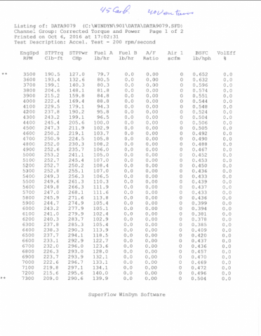

Leon Posted October 10, 2016 Share Posted October 10, 2016 Great stuff guys. I'm curious, when you swapped to 45s did you also swap intake manifolds? Where the intakes match-ported to the head, carbs, or both? Very interesting to see the huge difference going to 45s makes (keeping venturi size constant). Really nice data here! Quote Link to comment Share on other sites More sharing options...
toptechracing Posted October 10, 2016 Share Posted October 10, 2016 I don't know the history of marks 40 MM setup. I ported and matched the 45 set up and pinned it to the head. They both were cannon manifolds but I took a lot of material out of the one I did. Quote Link to comment Share on other sites More sharing options...
Leon Posted October 10, 2016 Share Posted October 10, 2016 I don't know the history of marks 40 MM setup. I ported and matched the 45 set up and pinned it to the head. They both were cannon manifolds but I took a lot of material out of the one I did. Nice, thanks Joe. Quote Link to comment Share on other sites More sharing options...
zredbaron Posted October 10, 2016 Author Share Posted October 10, 2016 (edited) Haha, I forgot about your understeer comment at the dyno, Joe! And thanks for entertaining my desire to collect and share data. I didn't know it going in to the engine dyno, but I now agree that the real value is breaking the motor in and having a nice and safe general tune before digging in for the real deal. My original purpose was primarily to collect data, but that only partially worked out. Worth every penny for unexpected reasons! Yes, Leon. There are two complete triple weber assemblies with their own throttle linkage, their own air horns, and their own Cannon intake manifolds. Both are port matched, otherwise it wouldn't be much of a comparison. Previously, the 40mm Cannon manifold was port matched to the head and to the 40mm DCOEs. Joe received a brand new Cannon manifold. All Cannon manifolds are 40mm and are very crude and rough. Joe opened up the 40mm to 45mm on the carb side and port matched the intake to the head side. So in the comparison of 36mm venturis in 40DCOEs to 45mm DCOEs we are really comparing two main differences, the air horns and the exit diameter of the carb and the long intake runners' nozzles: The 40mm short air horns and the 40 DCOE's 40mm exit, which nozzles to 36mm via the Cannon manifold. The 45mm long air horns and the 45 DCOE's 45mm exit, which nozzles to 36mm via the Cannon manifold. I would have preferred that both carb sets utilized the short air horns, but alas, only half of my data collection went according to plan. Again, more on that to come. Edited October 10, 2016 by zredbaron Quote Link to comment Share on other sites More sharing options...
toptechracing Posted October 10, 2016 Share Posted October 10, 2016 Actually so we are clear the manifold for the 45s was fully ported from the head side to the carbside. I missed the memo that we wanted to test crap... the cannon manifold in raw form is a real piece of junk even on a street motor.. Quote Link to comment Share on other sites More sharing options...
zredbaron Posted October 10, 2016 Author Share Posted October 10, 2016 Thanks Joe... now *I'm* not clear! LOL. By "fully ported from head side to carb side" you mean both ends of the new Cannon manifold were port matched, correct? And the full length of the runners were therefore conically ground out to match, removing a ton of material, correct? The Cannon manifold isn't junk once it's been opened up... Clearly, we're all speaking *slightly* different English. I feel for the texting-Generations Y and Z behind us! Quote Link to comment Share on other sites More sharing options...
toptechracing Posted October 10, 2016 Share Posted October 10, 2016 Correct. The manifold I did is fully ported and flows very nicely after my work. Quote Link to comment Share on other sites More sharing options...
JMortensen Posted October 10, 2016 Share Posted October 10, 2016 Did one for my 44s back in the day. Took A LONG time to port the entire length of the manifold, and I agree, the casting is really crappy quality out of the box. Quote Link to comment Share on other sites More sharing options...

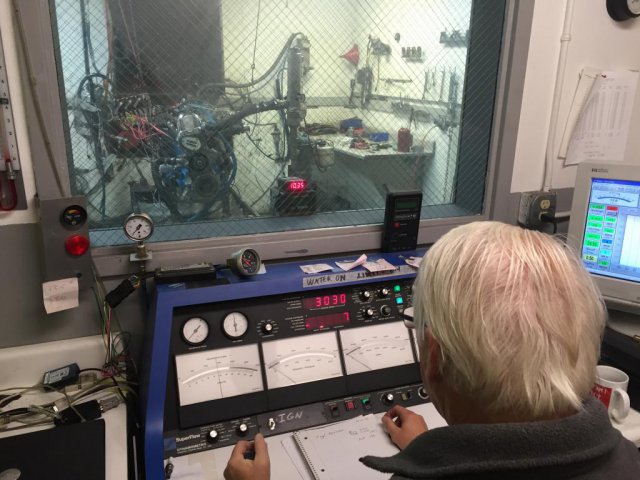

zredbaron Posted March 22, 2017 Author Share Posted March 22, 2017 2 of 3: The Dyno Shop and The Tuning The Dyno Shop: www.loyningsengineservice.com Arnie Loyning and his shop have a long racing history. Legacy, in fact, which is part of why I chose to step aside once I was there in person. I marveled at the age of this man (80?), his continued relevance in the sport and observing the arrival of his personal racer coming back to the shop (a 50-year-old Lotus that inspired the Mazda Miata). The techs joked that the boss man gets pretty grumpy if they don't get him on the track regularly. There were fancy heads and hi-tech intake manifolds and throttle assemblies (one piece, same function) everywhere. Clearly a ton of money coming into this place, and a ton of automotive pride going out. Respect aside... it's 2016, not 1986, not 1996, not 2006. I was very disappointed that he had a wide-band O2 sensor hooked up for instantaneous display purposes but he didn't pay for the add-on to his dyno software. The dyno and its controls were built in the 1980s (insert Weber book publication date comparison!) and the computer was easily over 10 years old. The black and white printout I received was printed from an ancient inkjet printer and it's hard to read in person, let alone the scanned image. I drive an old car! By definition I can appreciate old, IF it’s no slouch or is "kept original for vintage reasons." No one uses vintage PCs for modern use and says "they just don't make 'em like this anymore!" This might seem nitpicky, but it’s also attention to detail. If the attention to detail is only in the rearview mirror, who’s driving? Yesterday’s winner, says me. Granted, you might suggest the modern cars are fuel injected and the onboard computer is a part of the dyno tune. Correct. Except for the vintage racers like myself and the owner. The shop is named "Sidedraught City" for cryin' out loud, not "Fuel-Injection City!" He doesn’t have that for his own tune? Wow. At WOT only, he might not need it *as* much. I do. And every build benefits. Respectfully, I strongly feel he is riding out decades of success and doesn't care to evolve in this direction anymore. He displayed some stubborn traits and seemed to "tolerate" his job/role rather than enjoy it. That's ok, but I don't take my child to doctors that "tolerate" what they do for a living. He's earned his lot in life, again, full respect. Just so we're clear... his fee was well worth it and he provided a service. He simply won't be earning my dollars again for the same service. All chassis dyno experiences I've had (3 locations), by contrast, provided an A/F graph, provided a color printout that's readable, and offered the raw data files if you brought a USB stick. (You can download reader software from Dynojet, for example.) Even in rural Arkansas this is true, but here at the heart of racing in downtown Portland with multiple tracks in the region… here at “Sidedraught Central” evidently “what we’ve always done” trumps all. Jon noted that the printouts Arnie selected are not what Jon remembered seeing on screen at the end of the day. He just wasn't "present." Have I made my point about lack of attention-to-detail and disregard for the value of data? Curiously and enigmatically as far as I’m concerned, Arnie was very interested in a table printout which included BSFC (pic below). (https://en.wikipedia.org/wiki/Brake_specific_fuel_consumption) When I asked him about A/F ratio, he pointed at the BSFC he was so interested in and explained how I might calculate A/F ratio from the BSFC. I asked him several times, in disbelief of what I was hearing. Maybe I’m missing something, but in my opinion he has a gross conceptual error. One cannot possibly know how thoroughly fuel/air burned by watching the fuel consumption rate. You could have the ignition off, for example, and mechanically draw out this number with a reciprocating set of pistons. That said, the number is exceptionally useful when modifying port shapes, intake shapes, exhaust shapes, etc. and striving to maximize volumetric efficiency at every RPM. Less fuel for more horsepower is equally advantageous in a racecar and a Prius, albeit for different reasons and goals. To me, the efficiency or inefficiency is quite set in stone given my manifold and carburetor selection are a done deal, as is the head work and my camshaft. If I can’t adjust it and I have no intention to… it’s not worth much beyond “neato” and noting which RPMs the engine might vary efficiency… but my throttle pedal can tell you that range also. Like I said… “Neato.” (Anyone know what I’m missing?) I do intend to circle back to this after the build is complete. In the end, his shop has a reputation. He has repeat customers. Apparently they win on track, which is what matters. Some rent his dyno for a week. If I were experimenting with camshafts, port shapes, intake manifold or exhausts that fit, then I would value this facility for these purposes. This shop would be amazing for such experimentation IF AND ONLY IF fuel injection was used. None of these applied to me, so this shop did not meet my expectations or needs in terms of my expressed R&D intention and investment. In short, I would still do it all over again just for the engine break-in, especially if I had no other shop to choose from. I do not feel Arnie’s legacy experience offered my engine one single improvement detail -- this was my engine and Joe's engine; Arnie only participated in the break-in. In a way, I’m really glad I got to take my engine to a legacy shop so I can pat myself on the back for being there and giving my engine a royal break-in. That said, I'd like my money to be green AND understand when it is not. I'd like to be able to pay people to help me go the direction I want to go, not pay people to go the same direction they've gone for decades and convince me otherwise. I'd like vendors and service providers to be honest and speak up if goals and/or capabilities are not aligned. I told Arnie on the phone before any of this that I'm coming expressly to collect A/F data and I received the response of "oh sure, my dyno has that." No, actually, you have a gauge mounted near your controls but your dyno has no idea it’s there. (Pic below... the gauge is behind the glass -- red LEDs). In my opinion, good sir, you have a mentality that you know everything that is knowable and this mentality prevents new things from being discovered and prevents dialogue with sufficient understanding. I sincerely believe I told him what I wanted and he recalibrated my words silently into “you just want to come break in your engine and see what the gauges show.” Communication is a two way street, and I own up my half for not micromanaging the conversation and ensuring I spoke the correct lingo to interact with his mind. Trusting the expert and respecting my elder cost me two days of pay (I took time off during the week), plus the cost of the dyno day, plus the permanent loss of not attaining what I [believed I had] purchased -- a priceless and scientific R&D experience exploring new territory. Arrogant or not, my conclusion is that vintage racers might continue to expand the envelope in vintage ways, but not all vintage racers share the same idea of modern tools or sufficient communication. Full respect to men like Arnie, but my path is my own. Again, it was a really neat experience and I’m glad for it. Food for thought for all you enthusiasts out there The Tuning: Joe, maybe you'd like to chime in here, but the impression I received from observing you and Arnie is that you also were deferent to Arnie's experience and the fact that we were in Arnie's shop and Arnie's hands were on the controls -- It was The Arnie Loynings Show. It seemed to me that Joe was also reading Arnie to see what he might learn from Arnie’s decades of experience. Neither Joe nor I consider the engine tuned beyond "a decent start." Joe knows carbs very well also; I observed him ask questions of Arnie that I myself knew the answer to, so I figured he was probing Arnie to see if any unanticipated fruit would fall out of the tree. None did. Arnie did make an impression on me regarding orientation of the aux venturis, so I did reinforce a good habit, but it was more like "hey it's easy to mess this up" than performance insight. (I already knew how to orient a venturi.) I felt 50% like a guest and 50% like a customer. A welcome guest! …which is nice, but confusing when paying for services. I was in my right to ask them to swap parts and spend more time, but I feel that's the only thing that I as a paying customer had influence over. I felt I was wearing out my welcome just by being a customer with custom goals (same root word, even, go figure). Really odd! This is likely a common, upside-down result of supply and demand when supply (of comparable shops) decreases. The dollar just doesn't mean much after that, people get set in their ways, and eventually “it's my way or the highway because I have more customers and experience than I can shake a stick at.” I can list a few restaurants that meet that description but offer lousy food or service and the economy still inexplicably pays them. The people at the shop were in no way rude but rather very friendly; the owner’s mentality simply resulted in a closed door for this specific customer’s purpose. No disrespect, they treated my engine very very well and broke it in wonderfully. Worth every penny. I simply thought I was coming for a different reason. Since I took time off of work to accommodate *their* work preferences, it further cost me two days’ pay to come be surprised and disappointed with what I thought I was purchasing. Ouch is right. I sacrificed a lot. Again, I own my half and do not assert blame... but I do feel my money wasn't green at the shop. We humans affect each other’s lives more than we know. It would have been nice if the other parties joined me in the desire to communicate precisely or openly. It would have been nice if I was given the CHOICE to be ok with limited R&D... instead it "happened to me" against my knowledge. And Joe, just so you and I are clear... none of this reflects my opinion and trust of you, sir. Arnie and his business alone. I do not feel you mislead or ill-advised me in any way! To the contrary. It was fabulous advice to come break in the engine at this shop. That was your advice. It was my desire to conduct R&D. That's on me. As always, if I am missing something, I'd love to be wrong and retract my harsh perspectives... Quote Link to comment Share on other sites More sharing options...
