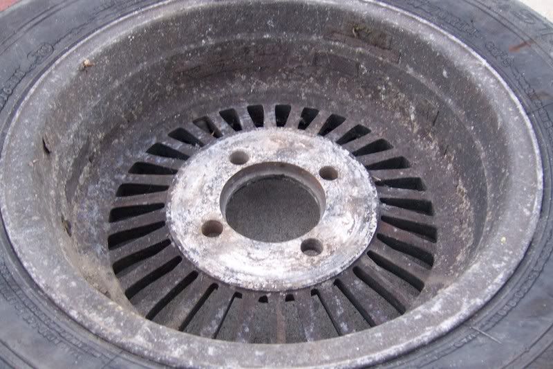

Silver Mine Motors Posted March 11, 2008 Share Posted March 11, 2008 i installed the s12+8 non vented caliper setup on my car today and it fit perfect under the stock 260z wheels. so if you don't want to get new rims the stage 3 kit will work for you. here are the pictures of the rim i tested since i'm not sure if the 240z and 280z rim is different. Link to comment Share on other sites More sharing options...

Soundmasterg Posted March 24, 2008 Share Posted March 24, 2008 I did the rear disc brake conversion today, and put new stock parts on the front for now. The stock 240Z rims do not fit over the rear brake setup. These are the 14 inch rims with the ugly press in hubcaps that the Z came with originally, and they hit the caliper. Too bad I don't have your 260Z rims! So anyone in the Portland, Oregon area have some cheap 15 inch rims that will fit a Z? I need to find some ASAP. I don't care about condition as long as they will fit the 240Z 4 bolt pattern and the tires mounted to them will hold air. (i.e. wheel not bent) Greg Link to comment Share on other sites More sharing options...
280Z Turbo Posted March 24, 2008 Share Posted March 24, 2008 I did the rear disc brake conversion today, and put new stock parts on the front for now. The stock 240Z rims do not fit over the rear brake setup. These are the 14 inch rims with the ugly press in hubcaps that the Z came with originally, and they hit the caliper. Too bad I don't have your 260Z rims! So anyone in the Portland, Oregon area have some cheap 15 inch rims that will fit a Z? I need to find some ASAP. I don't care about condition as long as they will fit the 240Z 4 bolt pattern and the tires mounted to them will hold air. (i.e. wheel not bent) Greg Those rims that he posted are not 260Z rims. They're old aftermarket wheels. 1981 turbo snowflakes fit over the Modern Motorsports setup. Those can be had for cheap. Link to comment Share on other sites More sharing options...
Silver Mine Motors Posted March 25, 2008 Share Posted March 25, 2008 Those rims that he posted are not 260Z rims. They're old aftermarket wheels. are you seriouse? i thought they were 260z rims. can you show were you got this information so i can be sure. Link to comment Share on other sites More sharing options...
