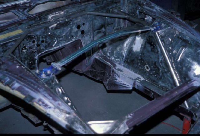

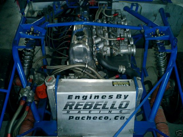

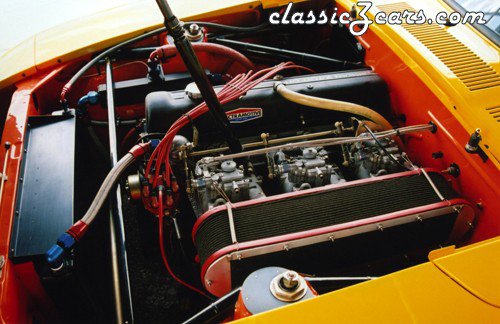

OlderThanMe Posted June 22, 2006 Share Posted June 22, 2006 the classiczcars one you could do. It looks like supports on the drivers side strut. I don't know about the other one...maybe a little extreme You could put a downbar from the strut tower top. Quote Link to comment Share on other sites More sharing options...

olie05 Posted June 23, 2006 Share Posted June 23, 2006 how about something like these gussets? Quote Link to comment Share on other sites More sharing options...
Guest ON3GO Posted June 23, 2006 Share Posted June 23, 2006 that might help and work, just would have to be abit more low profile, the turbo might hit it and or the piping... thanks olie Quote Link to comment Share on other sites More sharing options...
