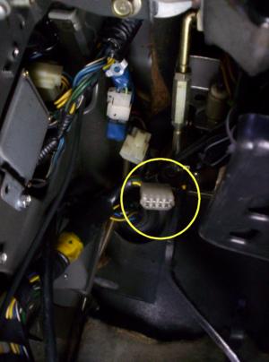

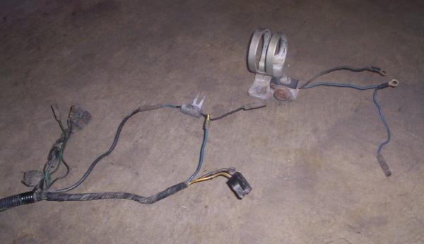

AE2ZX Posted September 25, 2006 Author Share Posted September 25, 2006 witch wire goes where ? we got yellow , white , does white go to green ? i remeber what you said to do .i will need to run the na temp wire to the temp sender as well so my gauge will work .but what color is that wire white or yellow ?And are the left over wires just taped off ? now in this spot next to the fuseable links box .there are NO PLUGS for blue and white wires ..i color matched the others yellow to yellow green to green black white to black white .is this right? .. but what of the blue and white wires ?? Quote Link to comment Share on other sites More sharing options...
AE2ZX Posted September 25, 2006 Author Share Posted September 25, 2006 check page 15 of your swap http://www.zdriver.com/forums/showthread.php?t=15653&page=15 you have the white wire unhooked did you ever figure out what it was ? why does mine have two wires unhooked ? what is the blue with red striped wire ? and can i get way with it being unhooked ? Quote Link to comment Share on other sites More sharing options...

AE2ZX Posted September 26, 2006 Author Share Posted September 26, 2006 got so much done today pretty much fully wired still working on a few things . bleach where you at ? Or anyone THAT KnoWS what thAT BLUE WIRE WHIT THE RED STRIPE GOES TO ?? Quote Link to comment Share on other sites More sharing options...
BleachZee Posted September 26, 2006 Share Posted September 26, 2006 Yes white is the temp sensor (top) Green to yellow. This sounds right from what I remember. My Z is tucked in for the night and i'm about ready for sleep too. My factory wires were already cut and spliced in. I cut that part out and re-did them so I had to test fit to see what worked. I'll double-check tomorrow and post at work. As for the plugs by the fusable links, the white wire is some kind of control for the auxilary radiator fan that the turbo has. it tells the dash harness when to kick it in. Well, we don't have that feature. Just tape it off. My 1982 car had the blue wire but honestly you should be ok without it. I can check on it later though. then when running that band of wires from the NA harness (from the driver's fender) yes one wire goes to temp. The other wires include power for the NA dizzzy and other crap. Just cut it all off. I cut mine back (never gonna use it again) and ended up only having one single wire running from the fender out to the plug. The rest taped up and tucked inside the fender tunnel behind that plastic cover that is behind the coil. Two of those wires in that bundle were for the power and ground to the coil of the NA car. Re-use those. Tie those into the power and ground of the turbo coil. Those will already be turned on with your key! Then, run the one single wire (yellow?) to the ECU, blue goes to POWER from your NA harness, black goes to ground. Look at your NA setup if its still there on the coil. I believe blue wires were power. That should be right. for what its worth wires cut and simplified to just 3 I took these pics but failed to get final pics of what I made! I'm looking through the albums and there's nothing really good of the wiring. on my turbo parts car I cut this plug off the dash harness. This is the dash side (turbo) of the plug that goes into the ECU/FI harness right above the ECU. I did this so I could find the correct wire, tap the one coil signal wire into it and then just 'plug' it into the harness. I like to have that removable connection. You probably have that page with the sloppy notes on what these wires are...? some other link I gave you I think. then under the dash this is the plug it goes into sorry for the delay. I've been busy with my own project. I'm trying to get my Pulsar on the road before the end of the month so I can drive that bad boy through the winter and finish up the Z. Quote Link to comment Share on other sites More sharing options...
