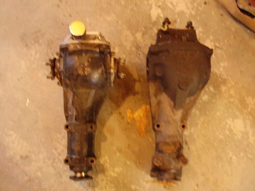

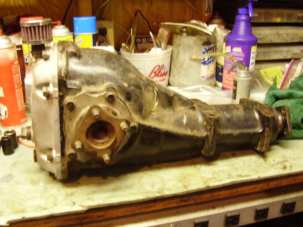

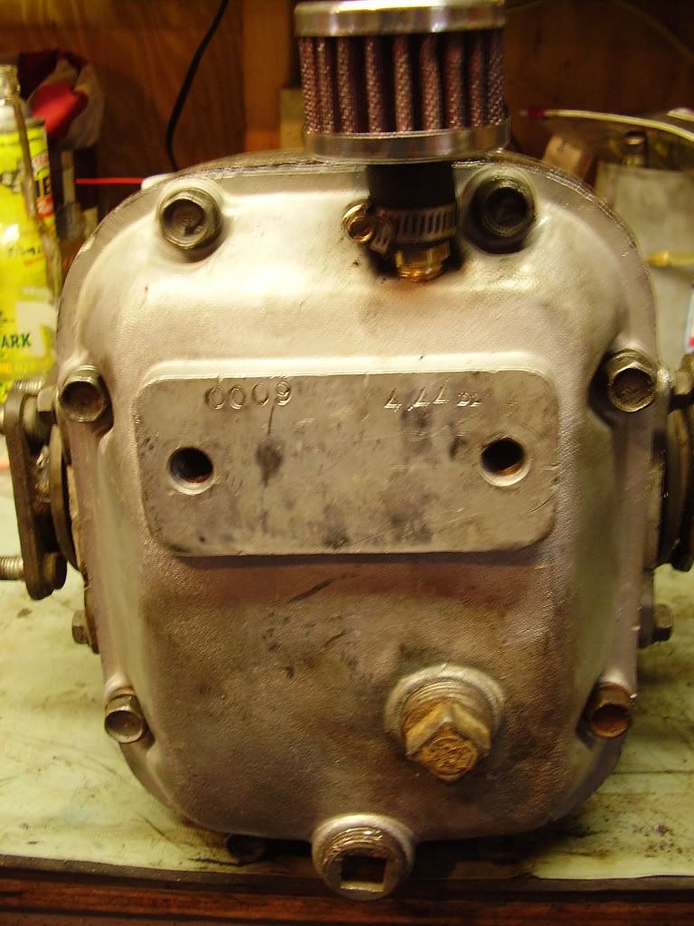

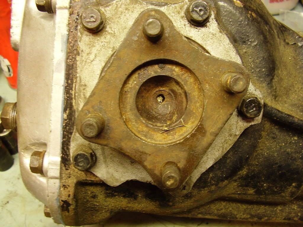

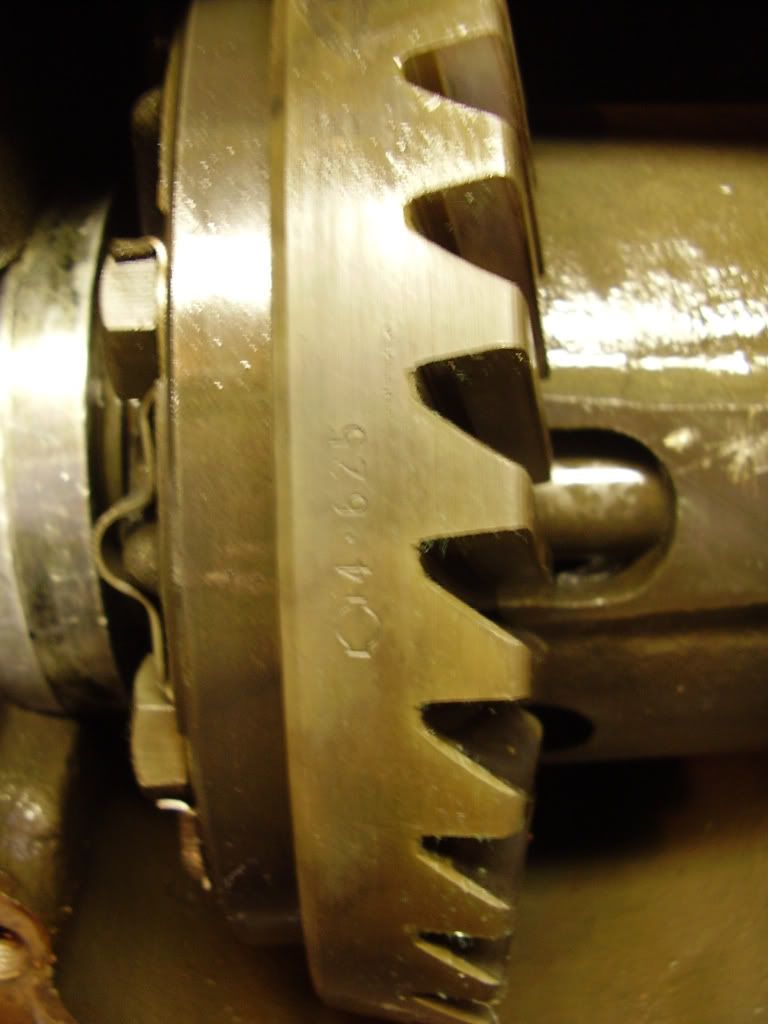

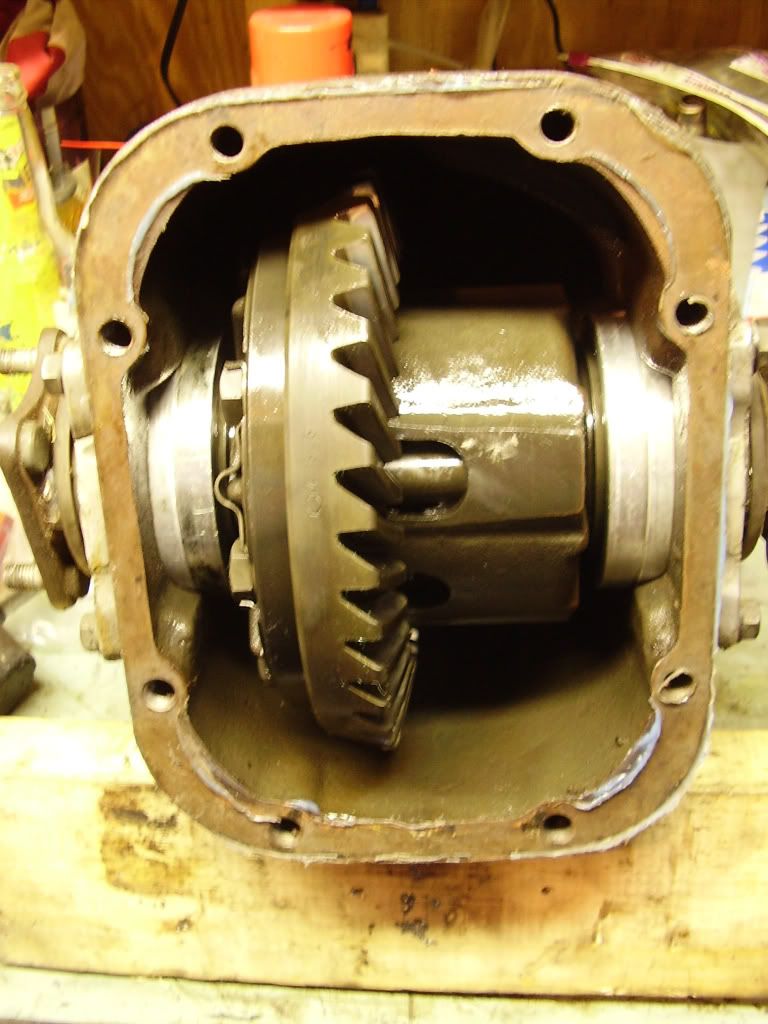

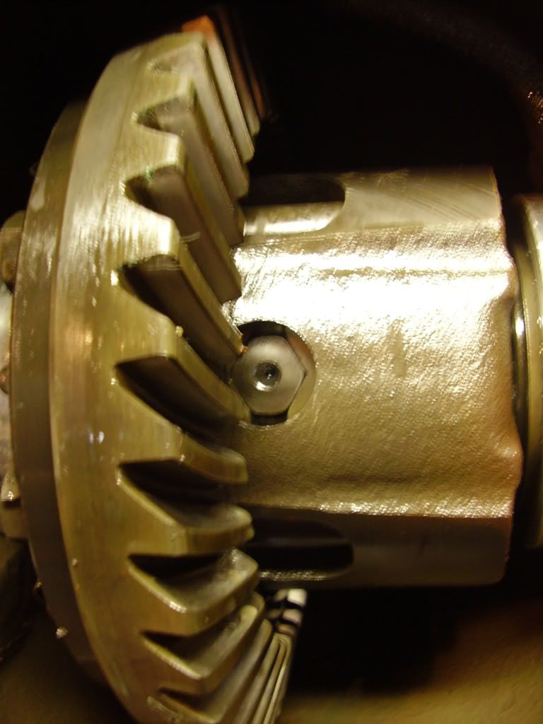

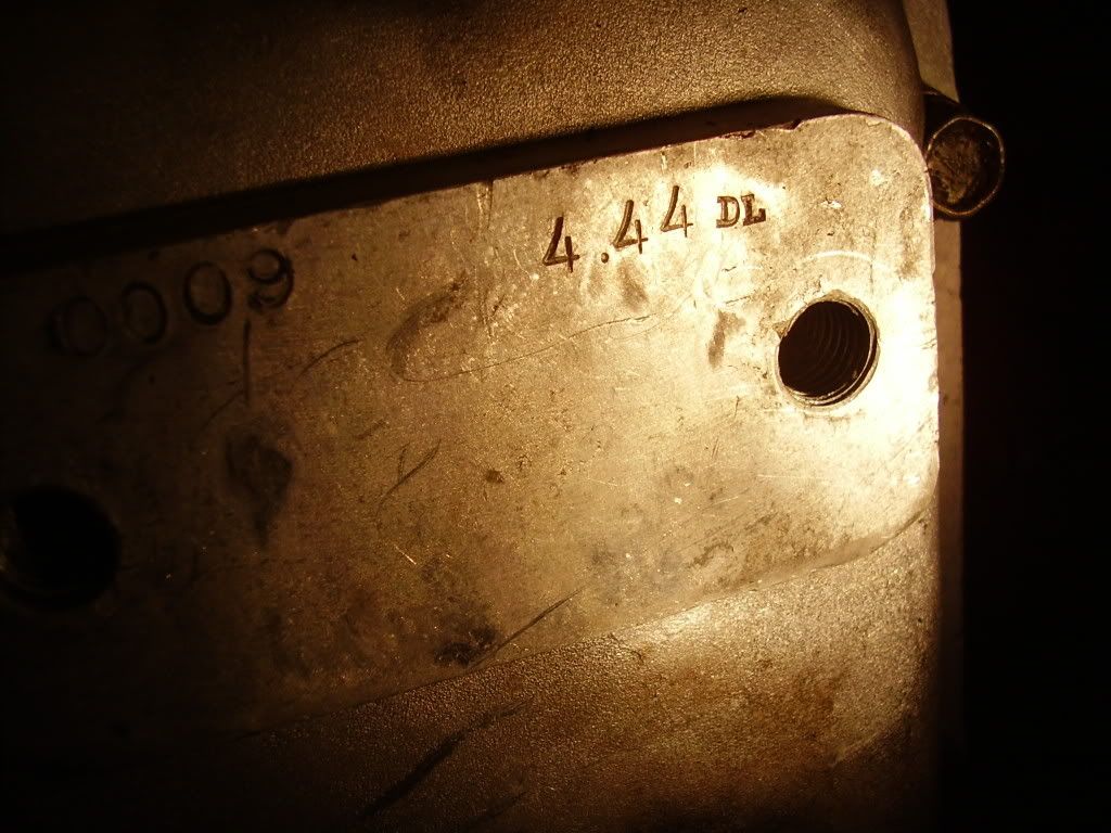

z-ya Posted February 17, 2008 Share Posted February 17, 2008 I got my hands on an R190 CLSD. Do we need photos of one? I can post some photos of people are interested. It's going in the race car in a month or so. Interesting looking case. Cover has same bolt pattern as R180, but is deeper to clear the 190mm ring gear. Also, the ratio is not stamped on the ring gear, but on the cover in two places. I've got an R200 3.9:1 CLSD in there now. The R190 is a 4.44:1. Should actually get it into 5th on the straights now. Should pull a little better up hill now too. Link to comment Share on other sites More sharing options...
JMortensen Posted February 18, 2008 Author Share Posted February 18, 2008 Yeah, we could use a picture. Is it a 2 pinion LSD? I think most or all of the R190's were. Link to comment Share on other sites More sharing options...
z-ya Posted February 19, 2008 Share Posted February 19, 2008 The cover says 4.44 (which is a very common ratio) but the ring gear has a 4.625 stamped on it. R190 CLSD photos: R190 left, R200 right. Link to comment Share on other sites More sharing options...
