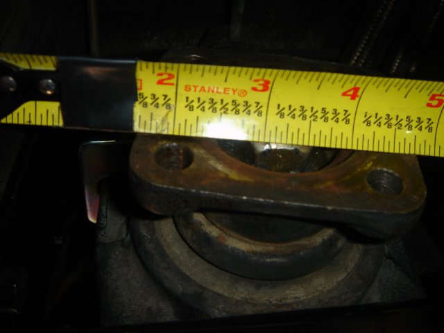

ktm Posted March 16, 2008 Share Posted March 16, 2008 For the R200 swap into a 240z, when swapping the pinion flange on the R200, do NOT use the flange from a 1975 280z. The bolt spacing and diameter was different for this year and this year only. Thus, the driveshaft will not bolt up to the differential. Link to comment Share on other sites More sharing options...
z-ya Posted March 16, 2008 Share Posted March 16, 2008 ktm said: For the R200 swap into a 240z, when swapping the pinion flange on the R200, do NOT use the flange from a 1975 280z. The bolt spacing and diameter was different for this year and this year only. Thus, the driveshaft will not bolt up to the differential. I have never seen this. As far as I know, all Z differentials from 70-83 have the same input flange bolt circle. Yes, the ones on the R200 are round instead of rectangular in shape, but the bolt circles are the same (just put one in a few weeks ago). The Z31s have a different bolt circle, so when you swap in a Z31 CLSD, you need to swap the input flange from a 75-83 R200. Link to comment Share on other sites More sharing options...
ktm Posted March 16, 2008 Share Posted March 16, 2008 Ok, you made me go out, crawl under my car and take pictures. z-ya, it's documented over at Zcar.com believe it or not. The 1975 R200 used a 10mm diameter bolt instead of an 8mm diameter bolt, and the bolt spacing is slightly wider than the "standard" bolt spacing. Following are the pictures of my driveshaft flange and the 1975 differential flange. You can clearly see that the bolt hole on the differential flange is larger than the driveshaft, that the spacing of the recess' are different (center of flanges), and that the bolt spacing is different. Link to comment Share on other sites More sharing options...
z-ya Posted March 17, 2008 Share Posted March 17, 2008 Learn something every day! I guess I've never had my hands on a 75'. Thanks for the photos! Link to comment Share on other sites More sharing options...
