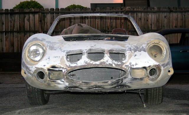

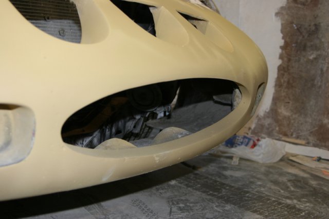

I've modified the front end of the body to include an oval mouth opening, ground air scoops and smaller circular brake cooler vents.
Six weeks later and this is where I am.
The before and after pictures are included.
I am pushing to get this project wrapped up this summer!

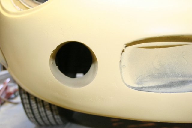

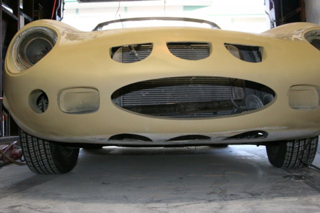

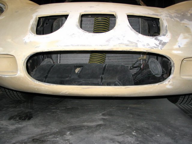

...if I am understanding this and your previous post correctly, are you saying that you have re-molded/shaped and welded your stock Z sheet metal to form a GTO body??? (convertible that is). If so, you've got a lot of explaining to do.
I can't wait to here how you did it.
Agent ONE, welcome to HybridZ. I purchased an already completed Alpha One. Tore it down and did a complete rebuild. It's been 2 1/2 years since I began. Final stages now, should be completed in a couple of months. So let's just round it up and say 3 years.
Zerrari,
Sorry if I wasn't clear in my post. I made the fiberglass body from molds that my dad had. The more I look into it - it seems that the body molds were made from the alpha kit. There were a few things I wanted that the alpha kit lacked. So I created an oval mouth, smaller circular air vents, bottom air scoops and centering the fog light locations. It has taken some time, but it coming together.
Thanks for the clarification espeery and welcome. Keep us posted on your progress; I'm sure I'll have some questions for you as my project progresses.

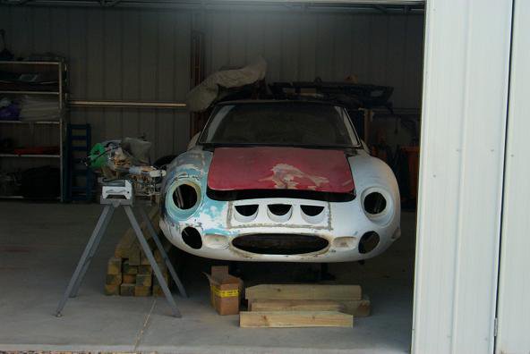

been a lurker for years, now finally joined. i have a "work in progress" it's been sitting in the garage for about 3 years waiting for me to have time to work on it (too many other projects)
i've started reshaping the nose & vents to be the "right" shape.
