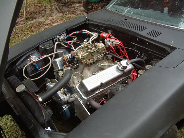

jnjdragracing Posted January 4, 2007 Share Posted January 4, 2007 Well I used a Lawn Mower cable, and made a bracket. I attached a photo of the setup I used with a single Carb. I used the same setup with 6-71 supercharger but had to use a longer cable and had to make a diffirent bracket. Never has giving me an issue. John Quote Link to comment Share on other sites More sharing options...
