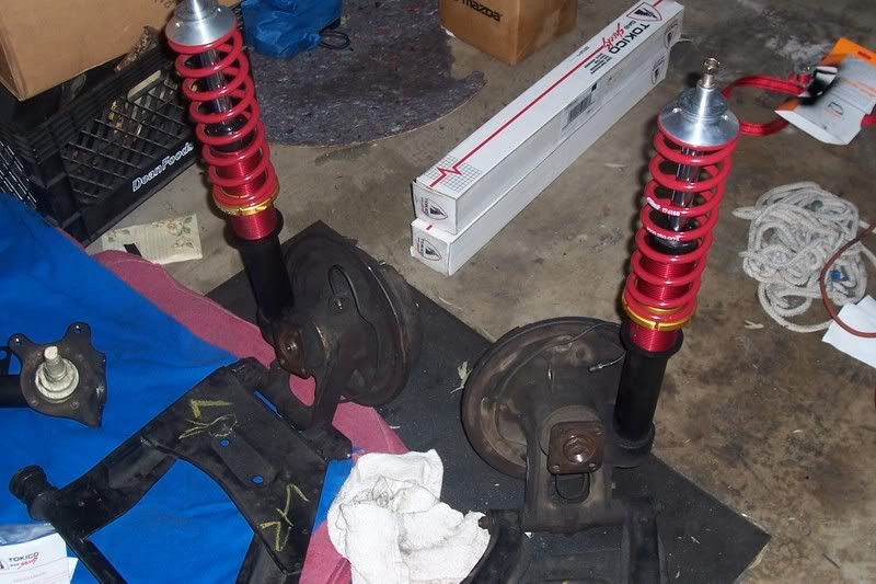

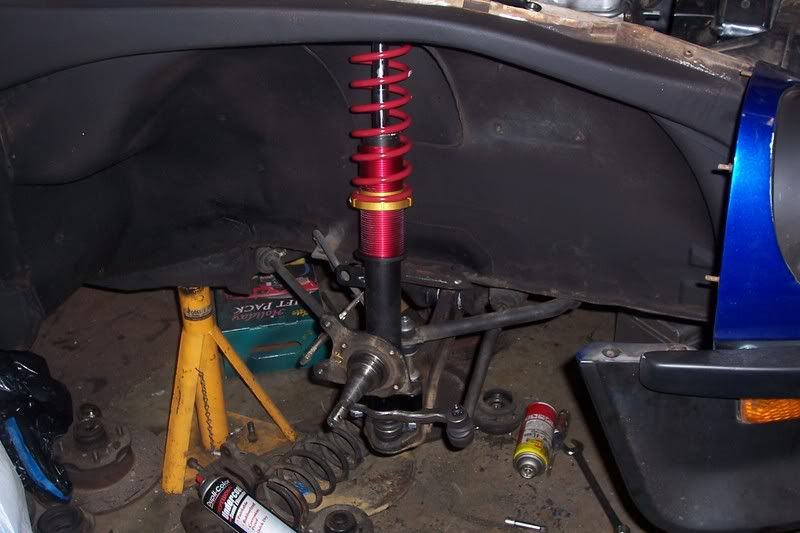

Yorgee Posted January 17, 2007 Share Posted January 17, 2007 Thanks Arizonazcar for your an excellent installation guide for 240z camber plates. I'm currently in the process of installing some coilovers on my Z and I was able to finish the front two camber plates last weekend. I based a lot of what I did on the guide I found on Arizonazcar and thought it would be a good idea to take some picture of my process as well. It never hurts to show these kinds of procedures, never know when someone might need the info and I'm hoping it can help someone. (just excuse my welding...haha) http://geocities.com/yorgola555/camberplateinstall.html I'm still planning on putting a little bondo to smooth out the strut towers. Is there something better I could use?? Quote Link to comment Share on other sites More sharing options...

Yorgee Posted February 2, 2007 Author Share Posted February 2, 2007 Yah I decided to take off the bondo last night, never thought about the bondo cracking though, that's a good point. I'll leave it how it is for now and maybe try the liquid metal later on. And as for the washers under those bolts, I just had them off because I was moving the bolts around to make sure the camber plate would be able to slide freely both ways. Update: I picked up my coilovers at Vildini Motorsport yesterday, and they did an excellent job. I was able to install the front 2, they look awesome. Quote Link to comment Share on other sites More sharing options...

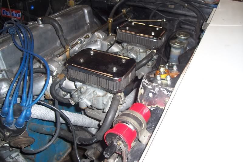

gjc5500 Posted February 4, 2007 Share Posted February 4, 2007 very nice work. do u like those webbers? not trying to change the topic Quote Link to comment Share on other sites More sharing options...
Yorgee Posted February 4, 2007 Author Share Posted February 4, 2007 very nice work. do u like those webbers? not trying to change the topic ha, thats cool, I don't mind the topic switch. I think these carbs pull a lot better than the SU's, and the SU's that I had before were built by Ztheropy too. The SU was more like a burst a power but slowly died as the engine rev'd up. Not to mention the sound the webers make, they sound awesome. I was just dropping my car off of the car stands when I noticed my front rims were hitting the tie rod ends. I think the bump steer adapters MSA sold me are the wrong size... Quote Link to comment Share on other sites More sharing options...
