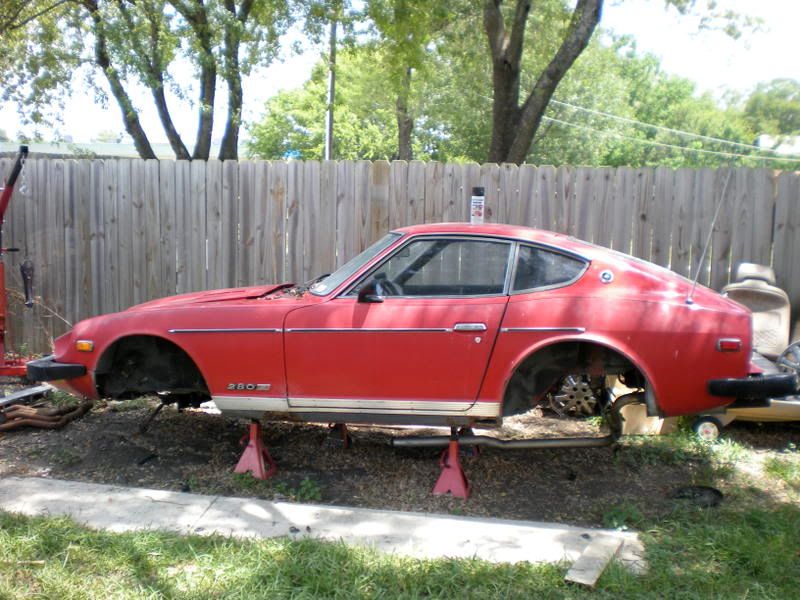

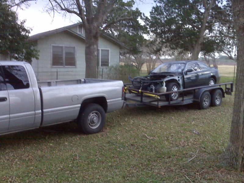

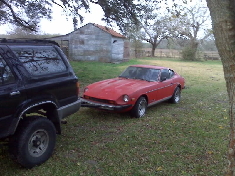

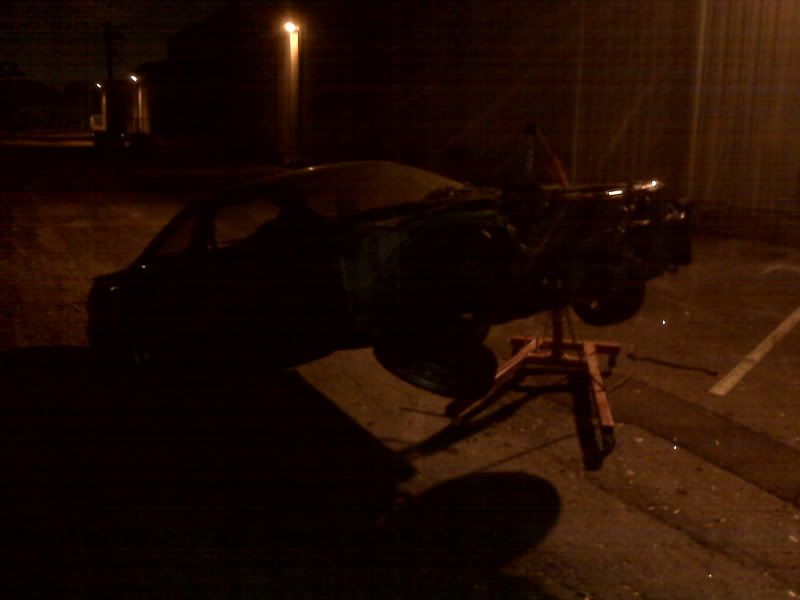

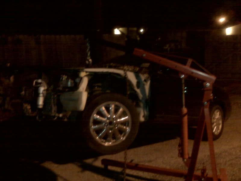

91_4x4runner Posted December 12, 2007 Author Share Posted December 12, 2007 On Saturday after work, I decided to finally ditch the SC (which later turned into taking it to our farm). After exhausting all methods of loading it back onto the trailer, we decided to lift it up with the engine hoist and back the trailer under it. Aside from being an incredibly stupid idea, it worked quite well. For reference, you can sort of see why I got such a sweet deal on the SC in the second picture, it has excessive wheel travel. Moreso, it has a strut that was literally sheered off, a damaged inner fender, and a broken a-arm. Once we got it to the farm, unloading it was as simple as chaining it up and pulling it off. And finally, getting the Z out of the barn and onto the trailer. It took a while due to approach/departure angles, but we finally managed to do it. My dad lent me one of his old Optima batteries to see if anything in the car still worked. Lo and behold, it actually cranked over (yes, I checked the oil and coolant first, both were clear). Even the dome light functions. Hopefully this coming weekend I'll have time to drop the gas tank, clean it out, install a new fuel pump and start it up. Also, after a more in-depth inspection, rust is a bit worse than I remember. Several holes under the battery tray, tons along the rocker panels, and some beginning along the hood. Oh well, it will be one fast rustbucket. I'm going to start searching for a rust-free chassis to work on once I get everything going in this pile. Quote Link to comment Share on other sites More sharing options...

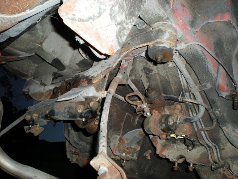

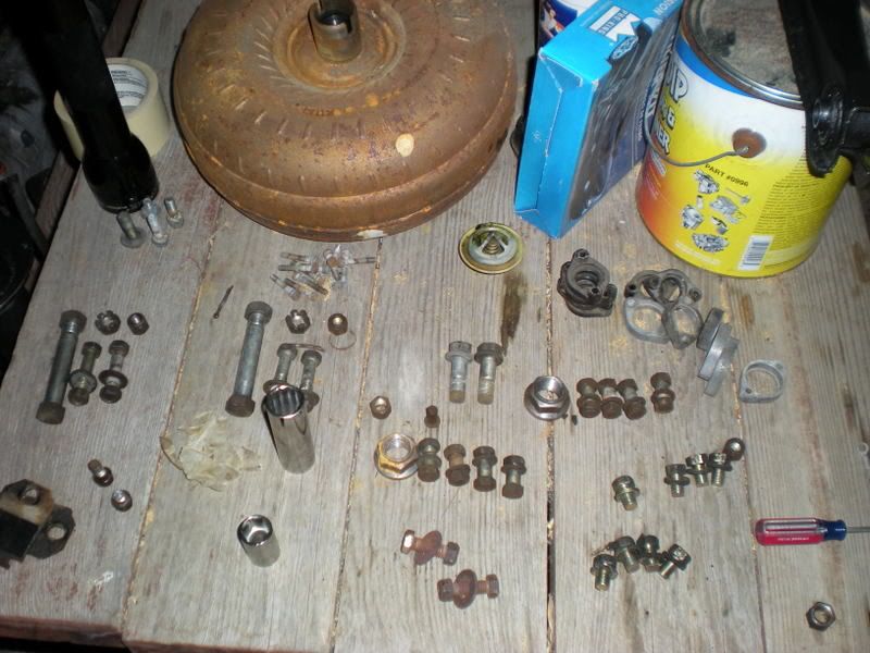

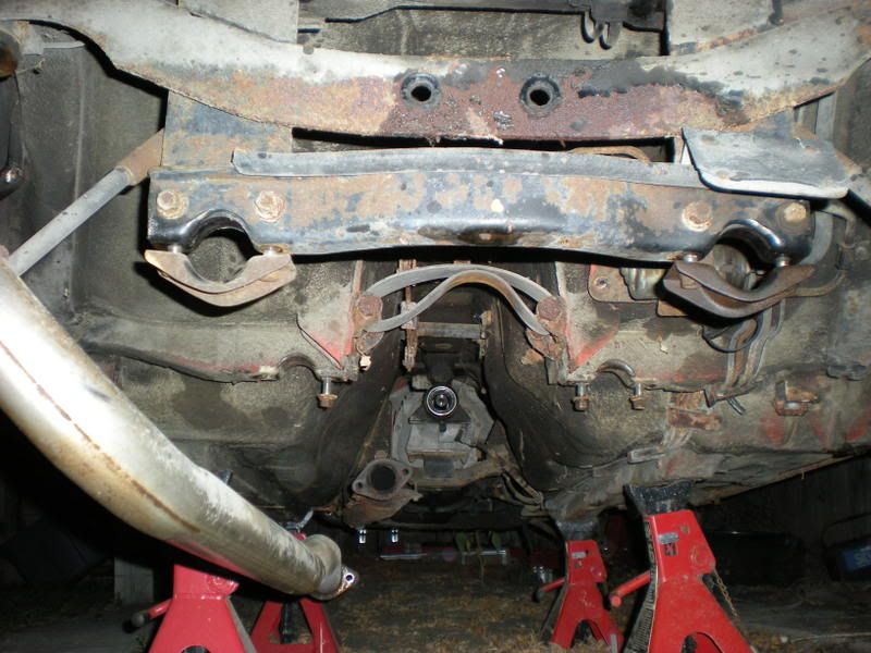

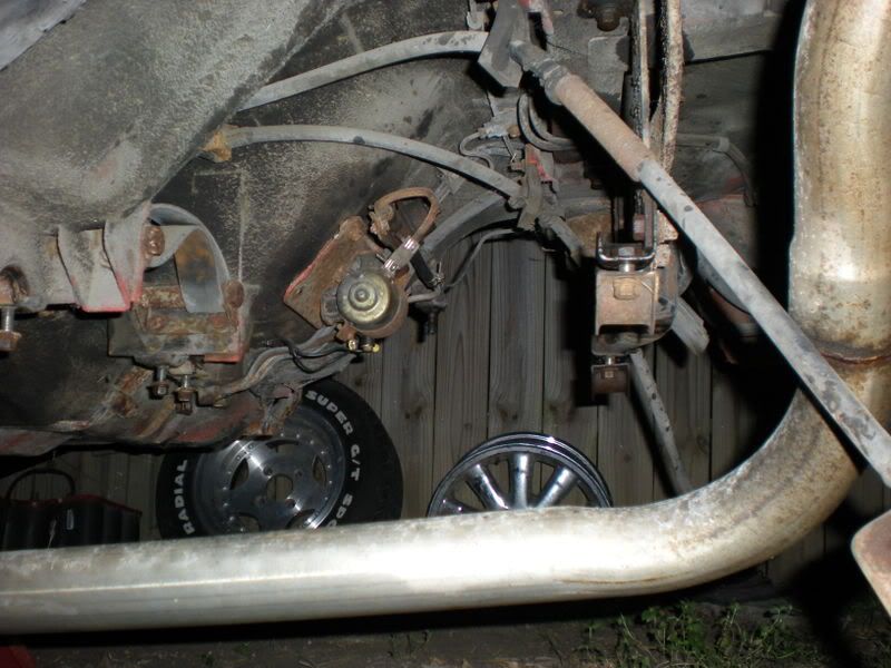

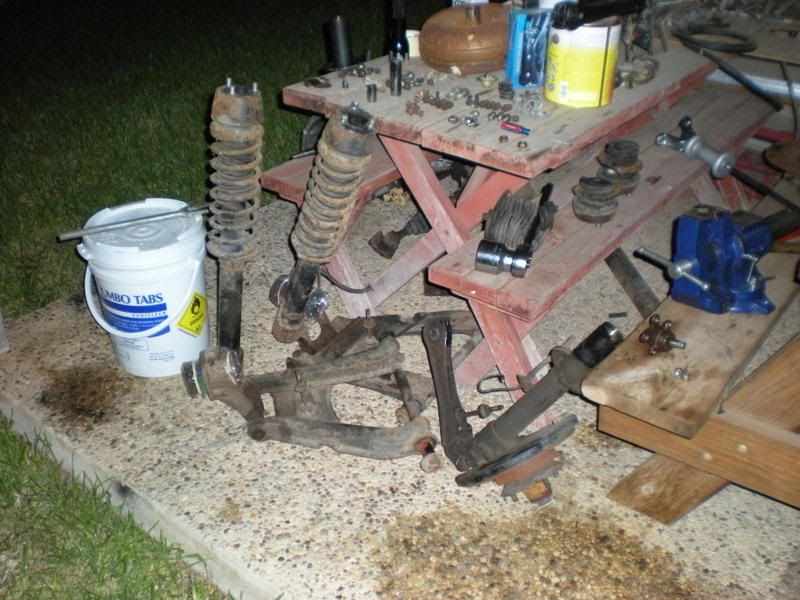

91_4x4runner Posted July 17, 2008 Author Share Posted July 17, 2008 Here are some of the pictures that I took this evening: I hope nobody tries to steal my car and drive off with it Clear left: Clear right: Clear to taxi: New rust formation.... it's almost like its own ecosystem! If you look off to the left on the bench, you can see my painted but unassembled strut assembly... it must be the best looking part.... off the car: Rear end hiding under the table, waiting to be tackled. Bolt collection table... mostly from the front; some from the back: Cleaning table... two spindles complete with shot bearings. Comments? If you look down the center of the tunnel, you can see that one of the bolts holding the control arm sheared off.... it should be fun getting that out. While I'm at it though, I can remove the bolt that sheared off on the opposite side, holding the sway bar..... GRRR Quote Link to comment Share on other sites More sharing options...

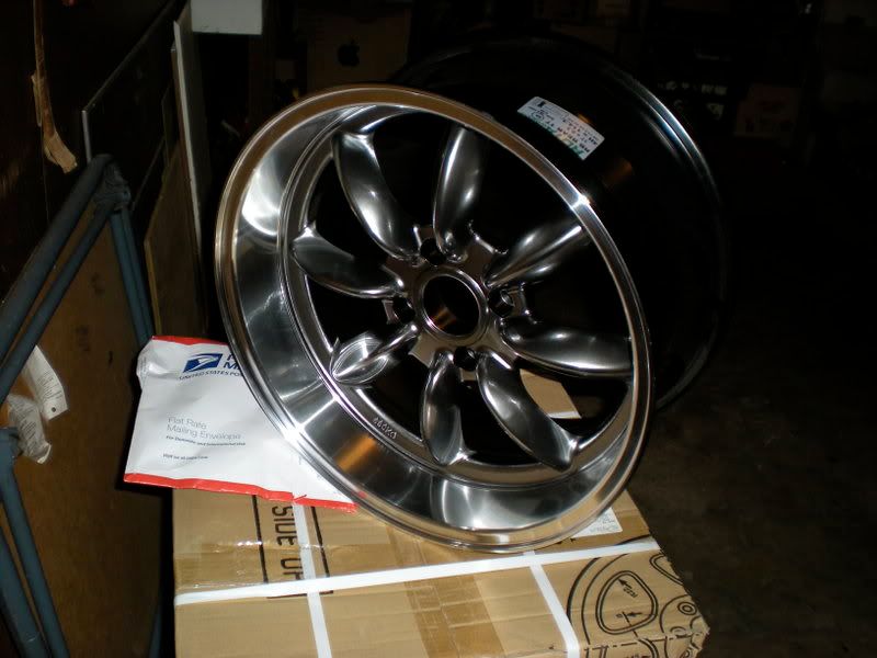

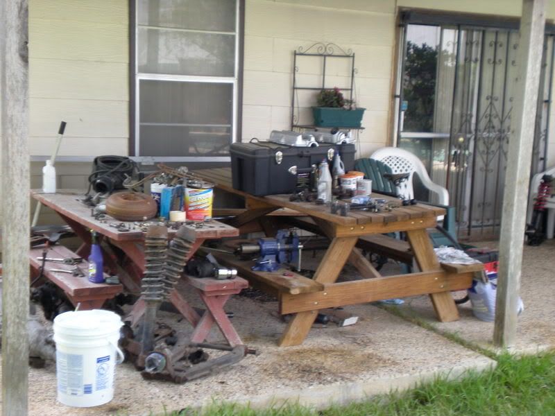

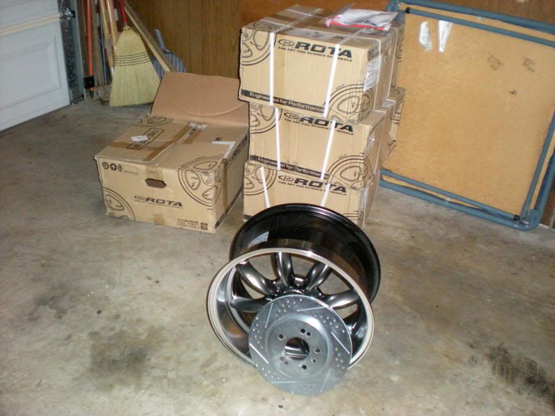

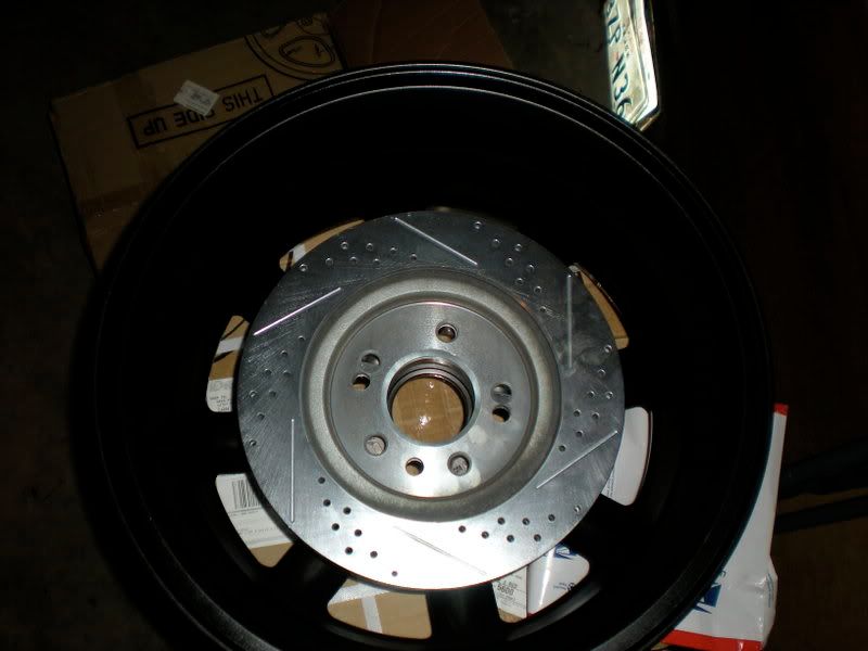

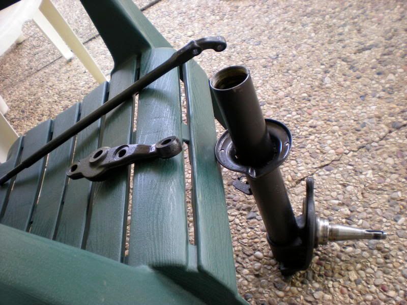

91_4x4runner Posted August 6, 2008 Author Share Posted August 6, 2008 Got some pics: New Rota's... I think that the brakes will fit just fine now : Strut assemblies off the car...soon as I get my front brakes, they'll be going on: All my crap....: As she sits now: Quote Link to comment Share on other sites More sharing options...

JSM Posted August 11, 2008 Share Posted August 11, 2008 I started pulling the 4-speed out this afternoon. As soon as I lowered it some, it just started gushing trans. fluid out of the rear of the transmission. At least 2 quarts. If I don't go partying tonight, I'll put the 5-speed in. Otherwise... it's going to wait until Monday. Looks like you parked it and started taking the suspension off. The driveshaft was off in the one pic and then you started taking the trans down. I'm thinking it was gushing fluid because you didn't drain it first!! You seriously need to consider some additional Jack stands. I'd be very uncomfortable under that. Quote Link to comment Share on other sites More sharing options...
91_4x4runner Posted August 11, 2008 Author Share Posted August 11, 2008 I felt the same way about the jackstands at first, but its actually quite stable (knock on wood). I've shaken it quite a bit and given it some big pushes and impulse hits (falling against it) and it still hasn't moved... But essentially yes, I parked it, pulled suspension, pulled drivetrain, and pulled the transmission. Are you telling me that the rear of the transmission isn't a sealed unit? I didn't drain it because I figured it was all sealed (like most transmissions?). That means I'll have to use a damn pump to fill the other.... jesus. This whole project kinda just sprung out of nothing... At first, the plan was buy the car, replace struts/springs and drive it. Then, after leaving it at the farm for a while, the rear drums locked. I figured while I'm at it, upgrade. So I bought rear discs. I looked at the front brakes as well, rusted and barely able to turn... upgrade that too. No biggie to replace it since I'm going to do the springs/struts. While its apart, I might as well do some rust prevention... paint everything and get new bushings.... It just keeps adding on every time I work on the car. That "while I'm at it" thing. Quote Link to comment Share on other sites More sharing options...

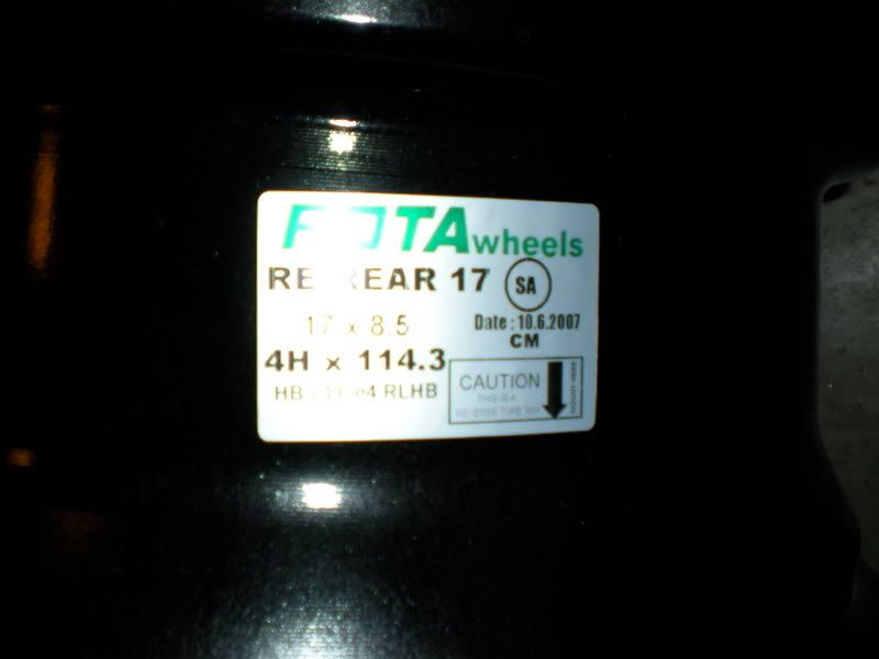

JustinOlson Posted August 11, 2008 Share Posted August 11, 2008 What color are your rotas? Justin Quote Link to comment Share on other sites More sharing options...
91_4x4runner Posted August 11, 2008 Author Share Posted August 11, 2008 What color are your rotas? Justin Hyper Black 17x8.5 Quote Link to comment Share on other sites More sharing options...
JSM Posted August 12, 2008 Share Posted August 12, 2008 But essentially yes, I parked it, pulled suspension, pulled drivetrain, and pulled the transmission. Are you telling me that the rear of the transmission isn't a sealed unit? I didn't drain it because I figured it was all sealed (like most transmissions?). That means I'll have to use a damn pump to fill the other.... jesus No it is not a sealed system. It is very easy to drain and refill. If nothing else I'd feel better if you added some jackstands. Do it for me! . No, I'm not gay just concerned. Quote Link to comment Share on other sites More sharing options...
