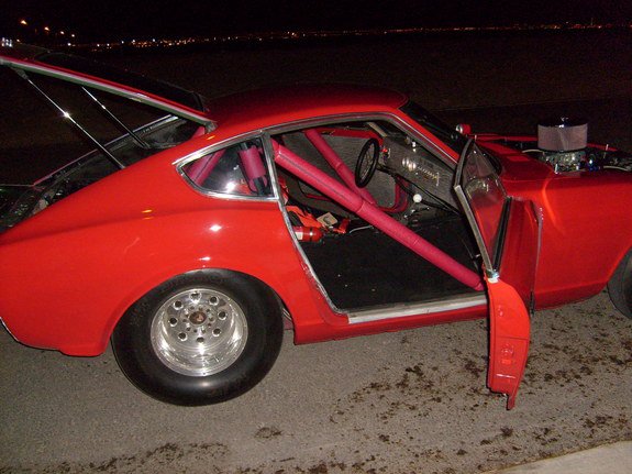

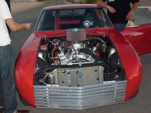

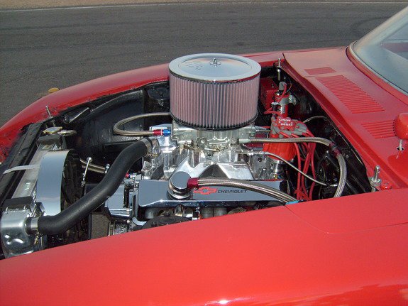

SHAI Posted August 20, 2007 Share Posted August 20, 2007 Guys and Girls, I've been waiting for 2 years to post this. I finally finished the car. I already got my first sponsor from a local brake shop without even racing the car at the drag strip yet.. I would like to thank JNJ Racing, Jon from Phillips Performance, and Doc. You guys are great and I appreciate your help and advices. The car is backhalfed with a ford 9", 4.88 gears, TH350 built tranny by Coan Racing, 9" 4500 converter by Coan with a trans brake (trans is rated to 1500 HP). All Aeromotive Fuel System backed up by the A1000 pump and Adj. fuel pressure reg., -8AN lines to the reg. and back to the cell. Cutsom made for the car, a Griffin 3 row aluminum radiator, B&M tranny cooler with -8AN lines to the tranny. Billet aluminum Meizere water pump and a 4500 cfm electric fan. MSD Ignition, Custom made long tube design headers (jet hot coated), and much more... Motor is a 400 SBC, original 2 bolt main bored to 4.165 inched modified with Cat billet steel splayed 21 degree 4 bolt main caps/ angle cut/ arp main studs. Block - magnaflux inspected/ decked .010 to zero piston deck height. Forged 4340 Eagle steel crankshaft rated to 1200 HP and 10,000 RPM, 6" 4340 steel rods, Forged ultralight pistons, stepped dish with valve relifes. Rings - TSI Race Rings, AFR 210 Racing Heads and a matched AFR intake manifold. Demon Carb. and all Lokar cable assem., Milodon oiling system, all ARP! Here is the best part, before we put the motor into the car, we dynoed it, and it made at 7200 RPM - 625 HP at 10.6:1 CR! 91 octane baby.. I will be participating at the next PINKS ALL OUT episode in Las Vegas. If you have any other questions, please don't hesitate to pm me. Link to comment Share on other sites More sharing options...
