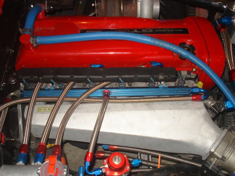

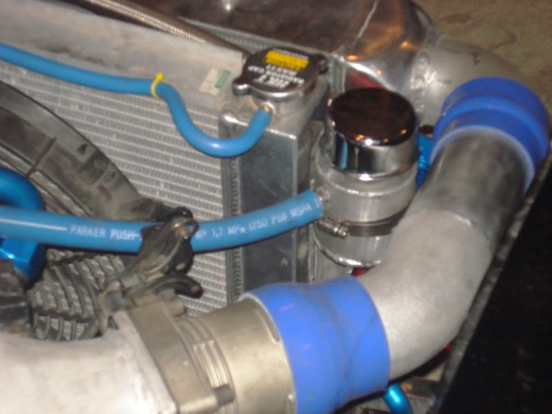

stony Posted December 22, 2007 Author Share Posted December 22, 2007 Latest pics.... all that is left is the throttle cable, clamp down all the loose plumbing and wiring the engine. Hope to have some video of it running by mid jan. breather/catch can Made a bracket so i could use the stock injector harness case. I think it cleans up the engine SOOOO much versus loose wires. Quote Link to comment Share on other sites More sharing options...
RB26powered74zcar Posted December 22, 2007 Share Posted December 22, 2007 stony said: Made a bracket so i could use the stock injector harness case. I think it cleans up the engine SOOOO much versus loose wires. Funny you bring that up.... I just purchased one of those off ebay (since I had already sold mine) so I could do the same thing you just did... Your right, it makes the motor look so much cleaner.... BTW, I see where you marked on the plenum for vacuum sources, I'd not put them up on the top like you have marked.... might as well make it look nice. I'd put them facing the water tank, or even underneath on the bottom. I've seen plenum's where the plumb in for a vacuum source up top side and it looks like pooh to me... (just my opinion) What did you mount it to? Are you going to use a CAS this time around? Things sure are looking good Stony... bet you can't wait, huh?? Quote Link to comment Share on other sites More sharing options...
stony Posted December 22, 2007 Author Share Posted December 22, 2007 Quote What did you mount it to? I cut up the old vacuum balance tube to make the mounts. I was only able to use the middle mount but it works fine. Quote Are you going to use a CAS this time around? Yea the Vpro needs it. Quote Things sure are looking good Stony... bet you can't wait, huh?? Damn skippy. It's gonna be hard not to touch it over the Zmas holidays BUT its a different story for new years :> Oh shoot just remembered i still have to change the timeing belt ( been sitting too long) .... cool i have something to do tomorro :> Quote Link to comment Share on other sites More sharing options...

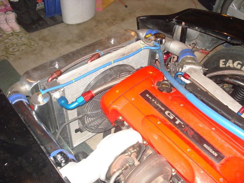

stony Posted February 27, 2008 Author Share Posted February 27, 2008 well the front clip is mounted minus the hood fasteners and some extra bracing. Hood off. Hood on. Hopefully with any luck we will have it on the dyno this weekend and have some numbers. Still have to wire up the gages and some other minor stuff but all in all the big stuff is done Quote Link to comment Share on other sites More sharing options...

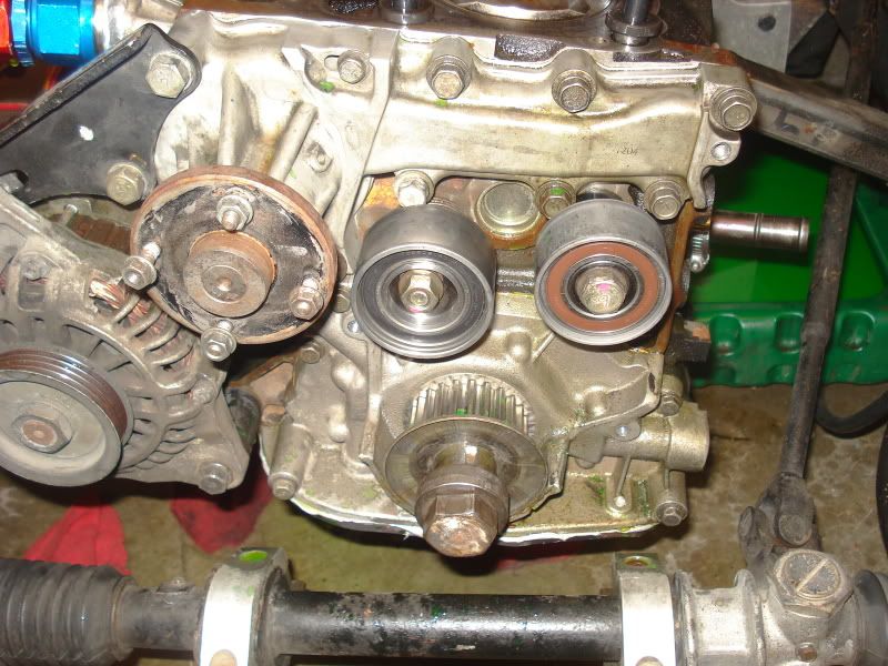

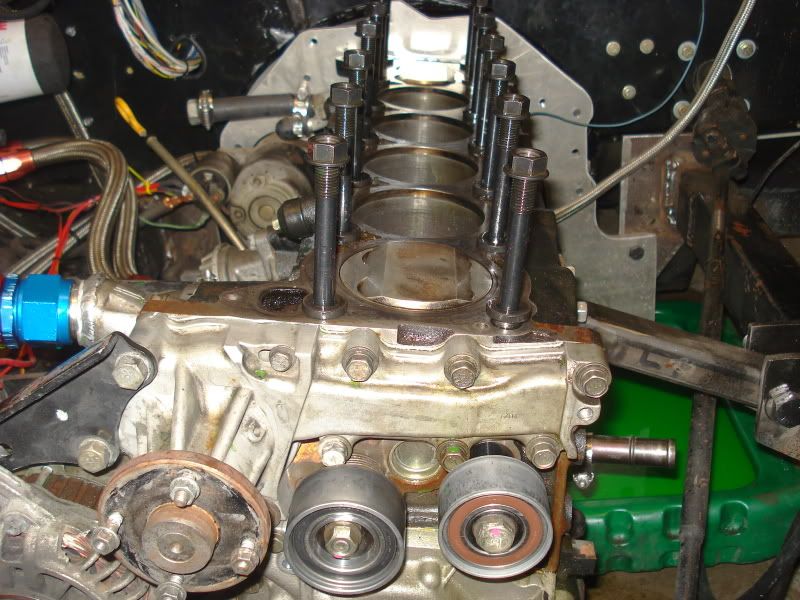

stony Posted April 11, 2008 Author Share Posted April 11, 2008 Got the motor stripped down to the long block last night. I have to pick up a pulley puller today so I can get that ATI damper off. Then the cams and head... tonight should have a good idea what is causing my leak :> Thanks goes out to ANDY for hooking me up with a cometic HG thing looks pretty good. Hope to have everything back together and back to the dyno soon for some more tuning. Once we get it close I can concentrate on all the safety crap that has to be updated to run at the track. Quote Link to comment Share on other sites More sharing options...

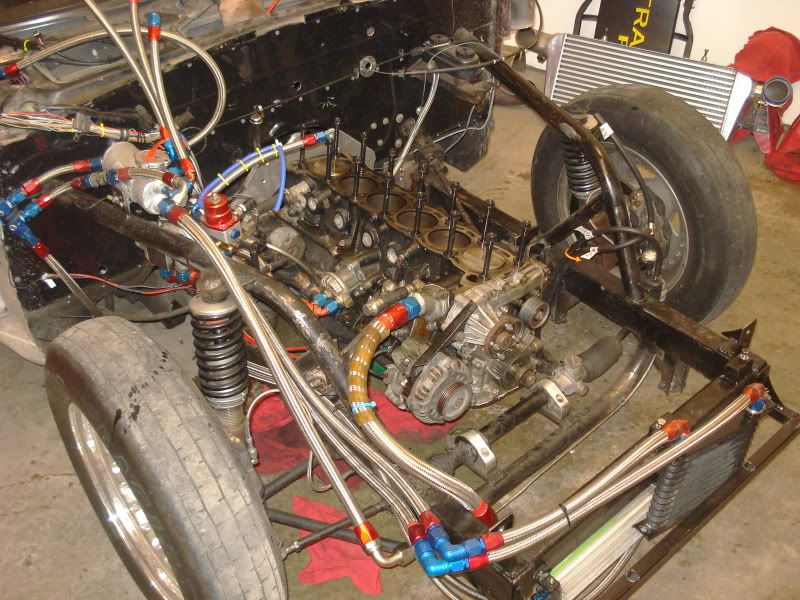

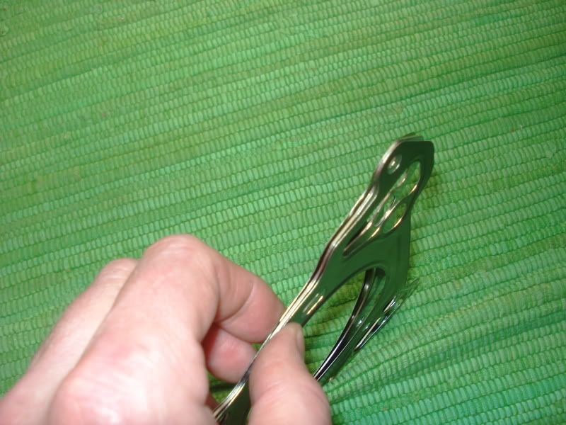

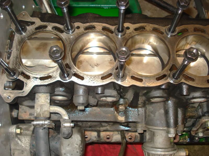

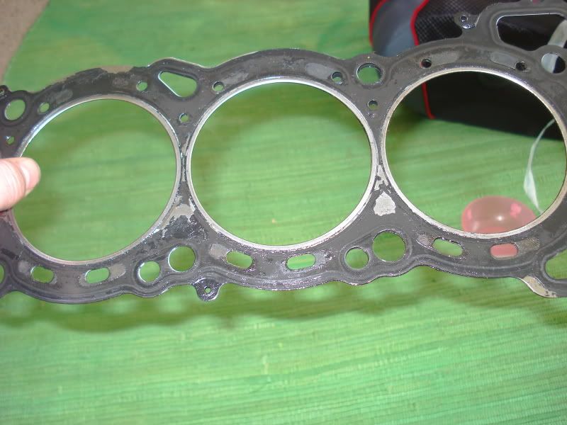

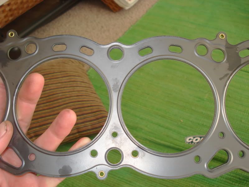

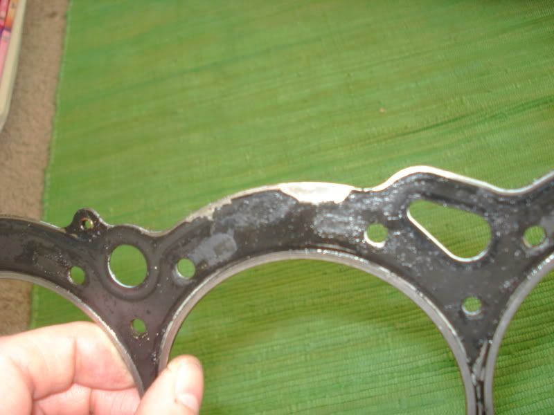

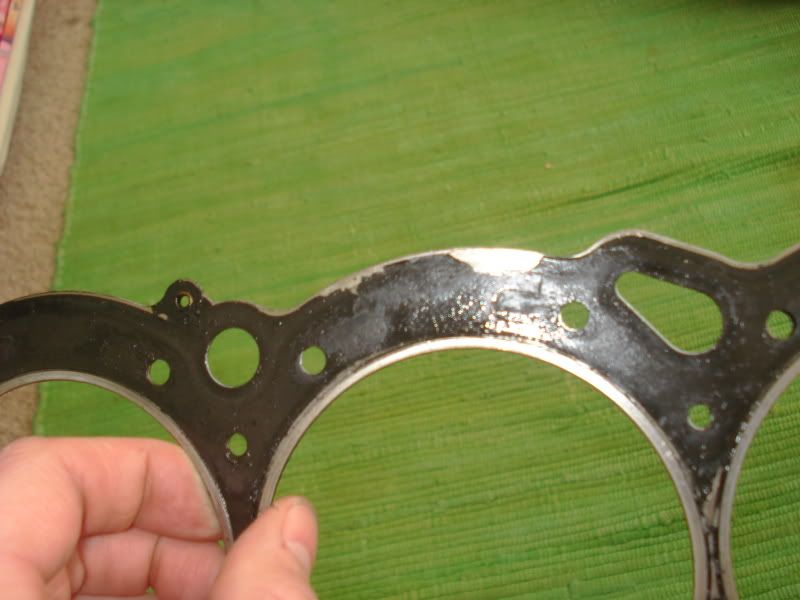

stony Posted April 11, 2008 Author Share Posted April 11, 2008 Well I got everything off…. And the good news is there is no real damage. The head gasket looked like ass though. Missing material here and there look like it may have been reused several times. Anyways here are some pics of the disassembled head and block. Hope to have everything ready to go back together Sunday night before I go back to work. Quote Link to comment Share on other sites More sharing options...
stony Posted April 11, 2008 Author Share Posted April 11, 2008 Well after further review…. It was the HG you can see in the pics the missing material. That was exactly were it was leaking from between the head and block. The Cometic looks a lot better and is visibly thicker even though the old one was supposed to be a 1.2 mm also Water jacket passages are over twice the size of the old one to so it should flow more water thru the head. Quote Link to comment Share on other sites More sharing options...

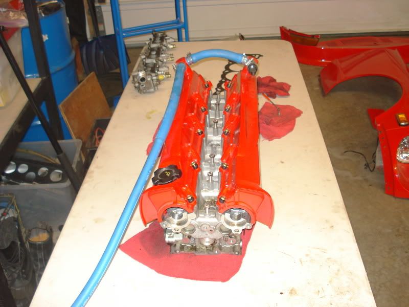

BirdmanZ Posted April 12, 2008 Share Posted April 12, 2008 Any chance we can get a picture of the port work on the JUN head? Quote Link to comment Share on other sites More sharing options...
stony Posted April 12, 2008 Author Share Posted April 12, 2008 OOpppsss sorry already installed the head. Nothing special just squish removed and intake runners smoothed out. The head did have to be clearanced for the cams. Quote Link to comment Share on other sites More sharing options...
