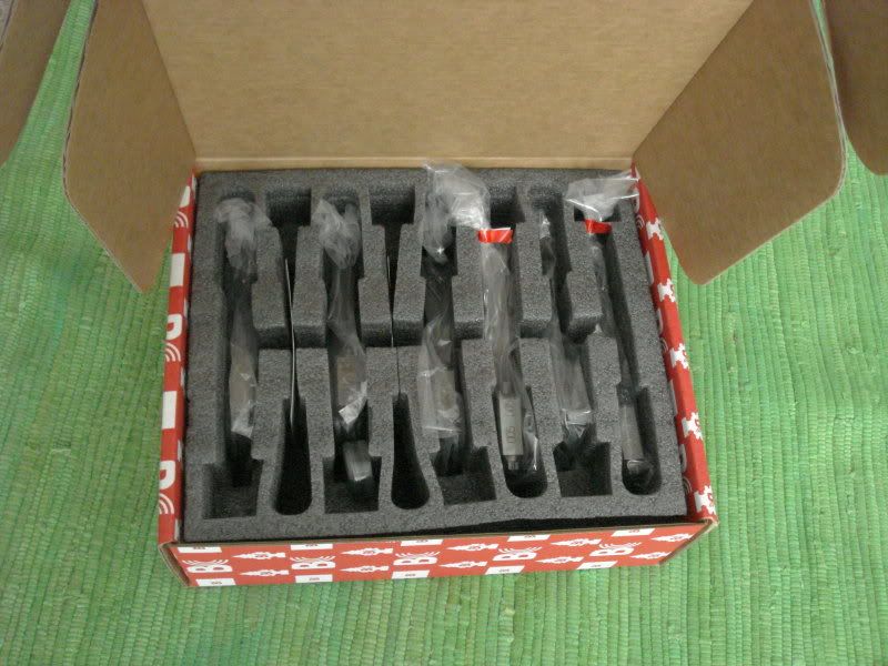

stony Posted May 10, 2008 Author Share Posted May 10, 2008 Couple more updates. The Brian crower rods are here. The r33 crank and all associated seal and gaskets to get the motor back together are in the mail from japan (thanks CHEFTRD AKA Matt your a lifesaver well rb saver ) After thinking about it for a while I have come to the conclusion the reason i didn't see and increase in HP when i went from 22psi to 24psi was because my alternator was bad... it wasn't putting out anything... zip, zilch nothing to the charging system so I was only running on battery power ( bad battery at that) Once we got up in the rpm the voltage steadily dropped from 12.5 down to 11.3!!! at one point it coughed and we thought it was the plugs... The new alternator is on the way with the crank and should solve that problem and we may see a significant jump in power next time just due to the fact we will have a stronger spark with the fully operational charging system.... Quote Link to comment Share on other sites More sharing options...

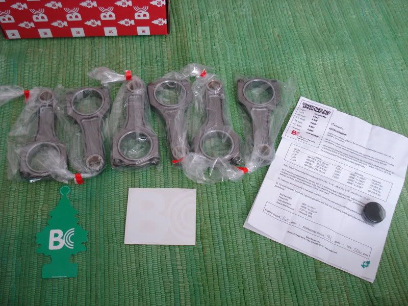

stony Posted May 10, 2008 Author Share Posted May 10, 2008 some pics Nice Box... Nice packaging full spec sheet with assembly lube and some stickers...the pine tree thing is kinds gay but hey... Quote Link to comment Share on other sites More sharing options...

pirate87 Posted May 12, 2008 Share Posted May 12, 2008 stony said: ...the pine tree thing is kinds gay but hey... HAHAH, I looked at the pic before I read that and thought: "man, that pine tree is pretty f'in dope" I gotta ask though... what scent is it? Quote Link to comment Share on other sites More sharing options...
stony Posted May 12, 2008 Author Share Posted May 12, 2008 No scent just a sticker??? Quote Link to comment Share on other sites More sharing options...

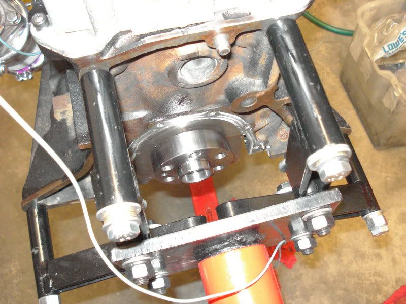

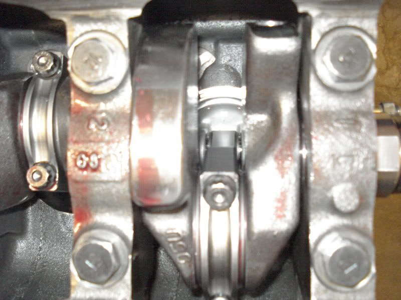

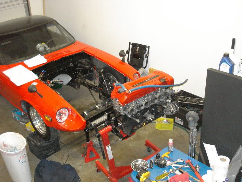

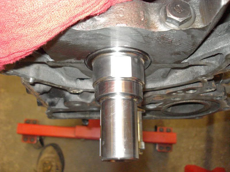

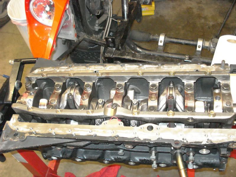

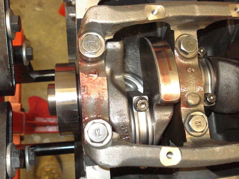

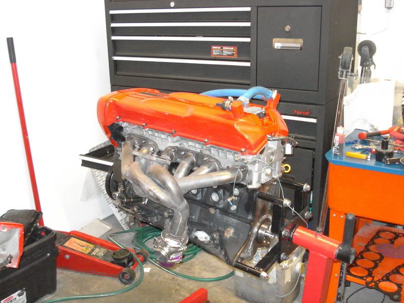

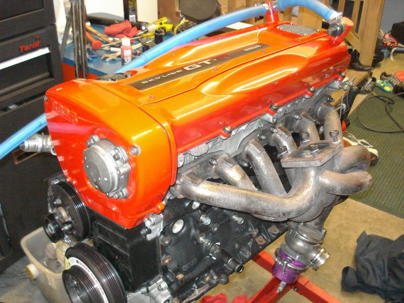

stony Posted June 12, 2008 Author Share Posted June 12, 2008 Ok here is a little update. The motor is rebuilt and should be ready to drop in soon. Here are some pics. Quote Link to comment Share on other sites More sharing options...

stony Posted June 12, 2008 Author Share Posted June 12, 2008 Careless said: so you're going to do the measurements and take it to the machinist and tell him what to get on his readings? I'm wondering if that's what I should do too, but tools and the hand differ. where does one get a nice set of inside mics? lookin good, man! Hey since you asked ... We going off the number off the crank and block, and measuring as a backup i ordered a set of Standard size Calico coated bearing from MAZWORX and all my oil clearances cam in at .038-.036 on all the rods and crank bearings!!!! The crank i received from ChefTRD was Perfect!!!!! every journal was exactly the Same!!!! Quote Link to comment Share on other sites More sharing options...
