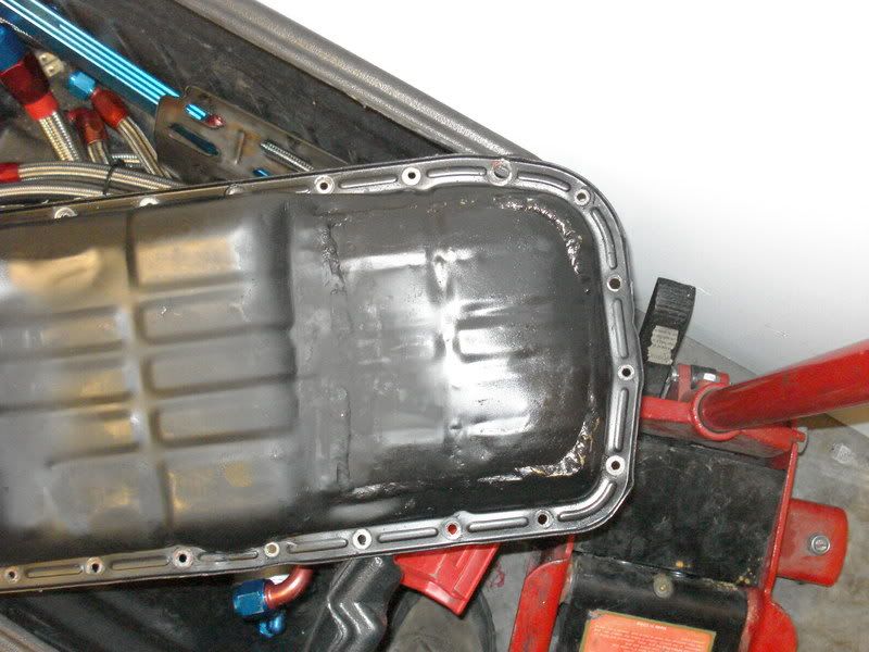

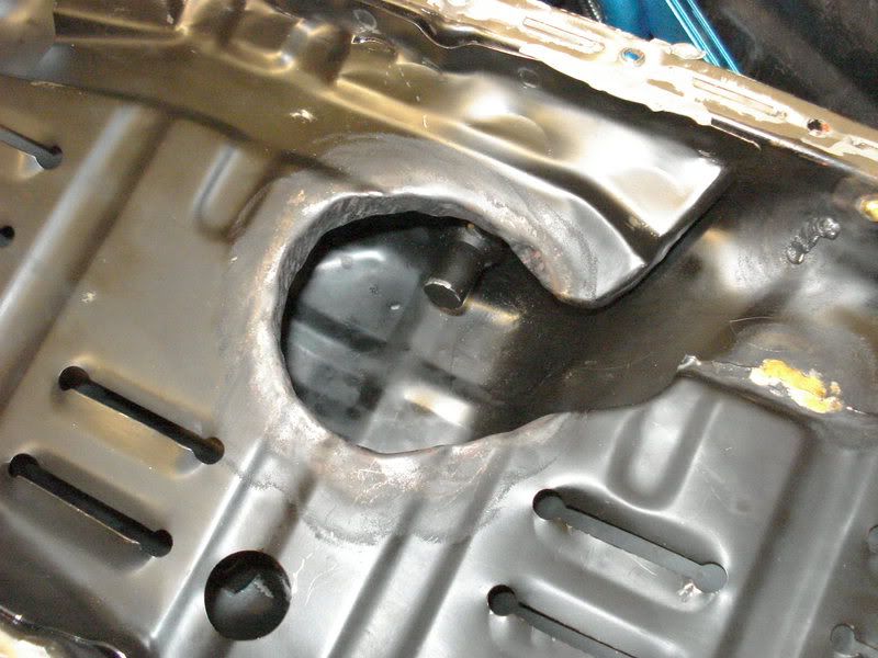

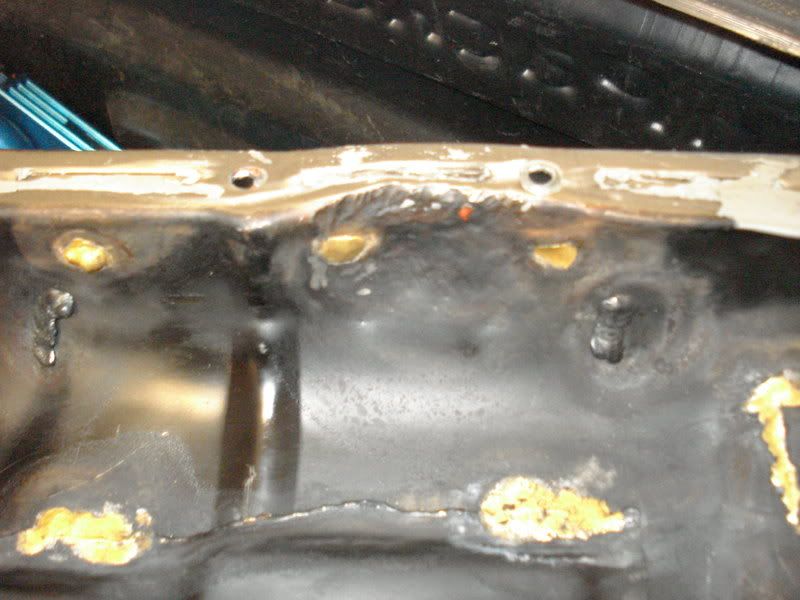

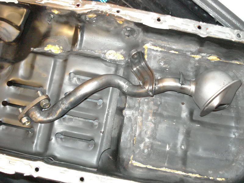

stony Posted June 12, 2008 Author Share Posted June 12, 2008 I cant remember who asked this either but People have wanted to see my oil pan and pick up for a while... well here it is. Area that was cut out and enlarged. Modified the area where the pickup drops down Heated and beat out the area where the pickup bolts to the block, It wasn't enough to use a regular bolt I had to use a Allen head and it worked fine And last but not least the pickup. This is 2 rb25 pickups that were cutup and welded together. Quote Link to comment Share on other sites More sharing options...
