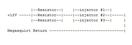

zilvia_gt Posted January 14, 2009 Share Posted January 14, 2009 BTW, nice find of the 2 ohm 25w resistors. How much do those cost? They look easier to mount. I found them on ebay; item #250107058986. They would work great for your dual bank set-up. However, I don't think they'll work for my application. The rb26dett is triggered individually buy the ecu (via the negative signal) so I guess I'll have to wire separate 6 ohm resistors between the injector and the 12V power source. At first I was thinking I can wire just this one resistor to the 12V power source, since it's 2 ohm and 25 watts, then attach all the positive side wire of the injectors to the resistor, but I'm no longer sure if this will work or not. Quote Link to comment Share on other sites More sharing options...
Zmanco Posted January 14, 2009 Share Posted January 14, 2009 At first I was thinking I can wire just this one resistor to the 12V power source, since it's 2 ohm and 25 watts, then attach all the positive side wire of the injectors to the resistor, but I'm no longer sure if this will work or not. No, I'm afraid not. If each injector is fired separately, then you need to wire each one with its own 6 ohm resistor. Quote Link to comment Share on other sites More sharing options...
z-ya Posted January 14, 2009 Share Posted January 14, 2009 Wow, this is the longest thread I've seen to discuss 6 resistors. Regardless if they are fired sequentially or at the same time, you need 6 resistors. You can't sum the inductive load of the injector with the resistive load of the resistor, and then just use Ohms law to find the total resistance. You want an independent circuit for each injector. Just get the OEM Nissan resistor pack and be done with it. It is designed to be mounted in the engine compartment and ruggedized for long life. Pete Quote Link to comment Share on other sites More sharing options...
getoffmyinternet Posted January 14, 2009 Share Posted January 14, 2009 They are likely all fired separately since they each have their own wire and resistor going through the whole wiring loom, but don't leave it up to us to figure out what's best, just mimic the oem pack! Quote Link to comment Share on other sites More sharing options...
