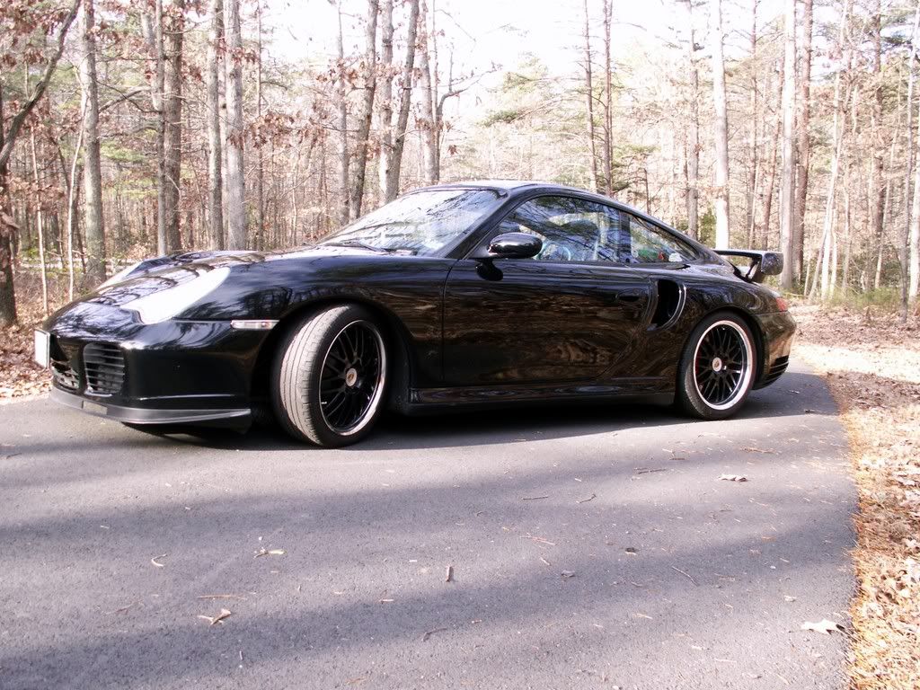

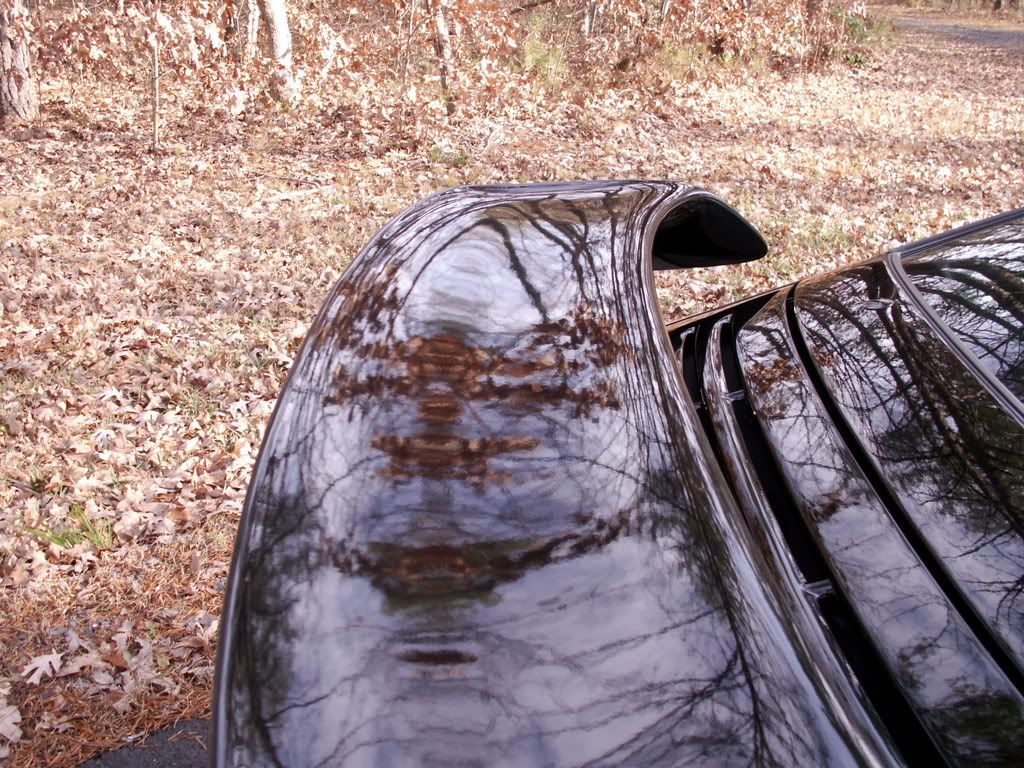

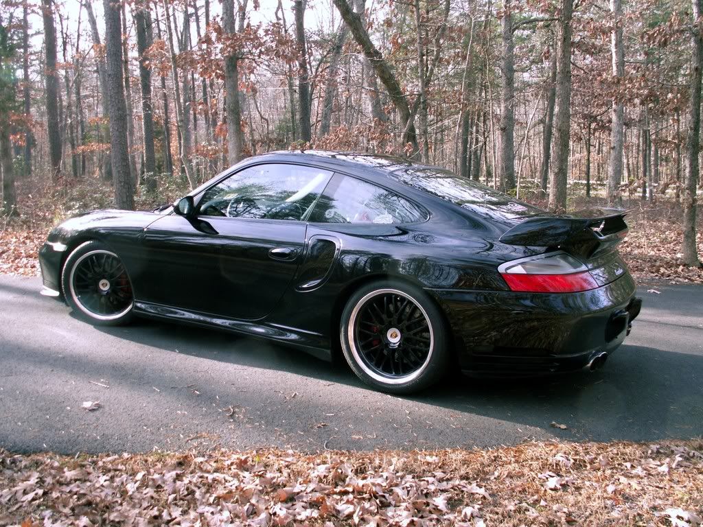

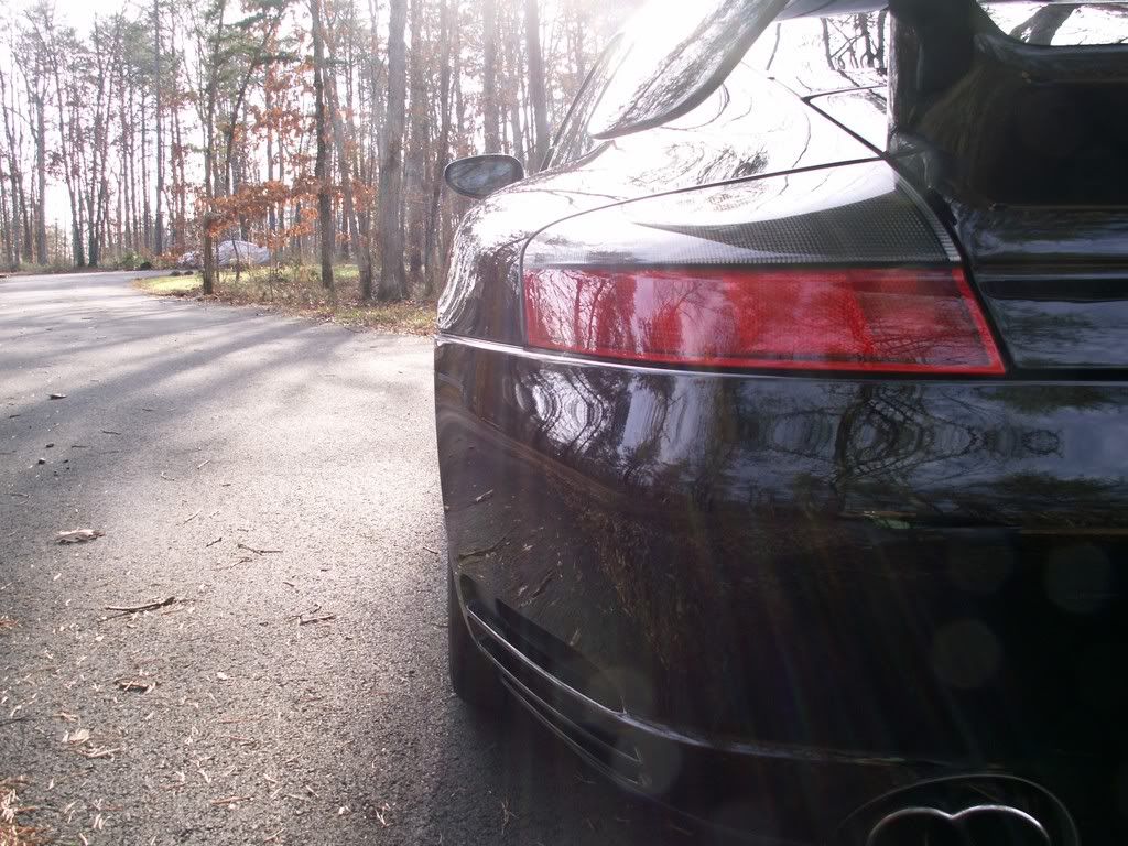

Mikelly Posted December 26, 2007 Share Posted December 26, 2007 Talk about timing... Xmas eve day I spent time washing, claybaring, then drying the porsche, and then I used my Porter Cable 2724 and the following: Stage 1: Optimum Polish on an Orange pad Wipe off with micro fiber towel. Stage 2: Zaino Z-AIO on with a white pad Let dry then wipe off with a MicroFiber... Pics speak for themselves... It took 3 hours from the time I started washing the car. I'm extremely pleased with this new process and will never go back to the "Zaino" 6 stage process... Gonna try and unload some of my Zaino "products". Make sure to buy the proper polishing/buffing hardware/pads to go with it. They make the results as much as the polish/wax you choose to use. Those pics were taken yesterday before the masses swarmed our house for Xmas lunch/dinner! Mike Quote Link to comment Share on other sites More sharing options...
