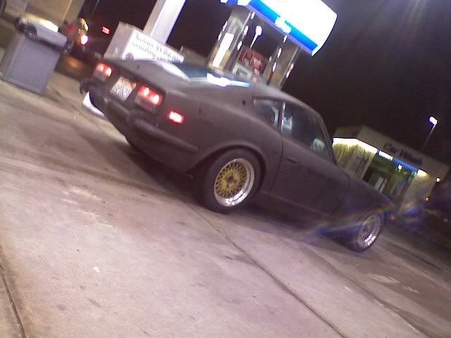

Mikey Posted January 25, 2008 Author Share Posted January 25, 2008 Finally got it out and PedalToTheFloorOhSnapINeedToBleedTheBrakes at every light. I bled them by myself for the first time, but wasnt as successful as i thought. Quote Link to comment Share on other sites More sharing options...
JMortensen Posted January 25, 2008 Share Posted January 25, 2008 You know the master cylinder test right? Slow light pressure on the pedal. If it goes to the floor, needs replacing. Hard pressure will force the seal hard against the bore and will mask a bad master. So it may not be just a bleed. I'd suggest a new one rather than a reman if it does go that route. Quote Link to comment Share on other sites More sharing options...
