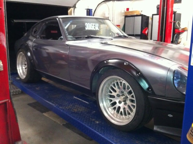

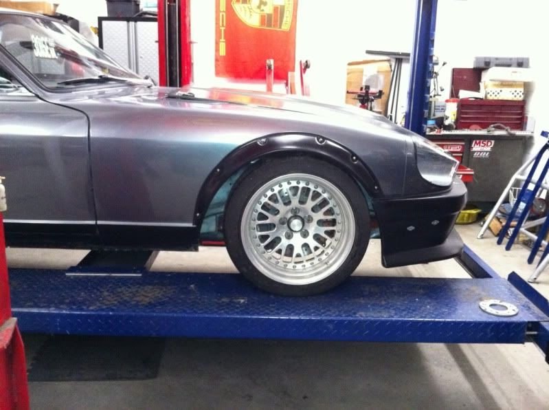

J.Huff Posted September 24, 2011 Share Posted September 24, 2011 So I was wondering what CCWs would look like on my car, and since I still have Jim's red Zcar at my place... For some reason Jim decided he needed to run the same tire size as his C5Z06 had, and bought 17X9 fronts and 18X11 rears. He also had them offset in the rear so wide that I bet there's nearly and inch clearance at the rear strut housing... So if I order a set (and I likely will because these are gorgious on my car) they'll be 18s, probably with black centers. Mike Excellent choice in wheels....I just purchased a set of black (bead blasted) CCW classics and you won't be disappointed! It appears that our cars will look nearly identical in color, stance, and wheels. It appears that I may need to find a new paint color to keep from this happening. Quote Link to comment Share on other sites More sharing options...

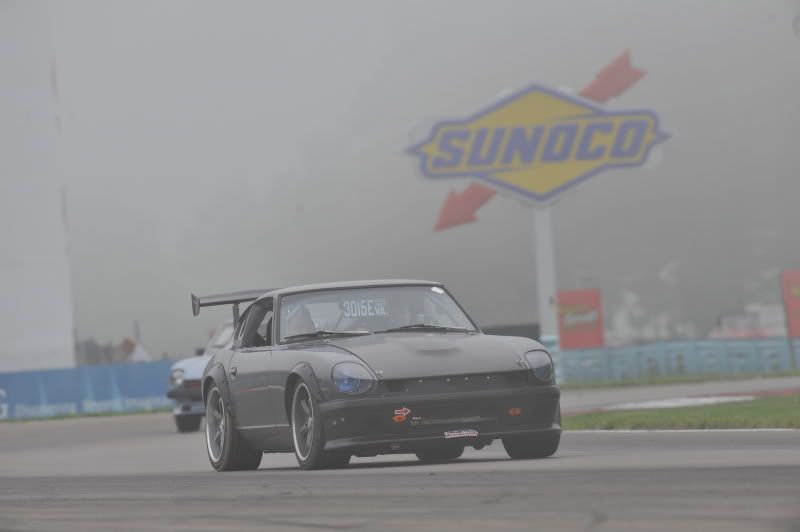

Mikelly Posted September 26, 2011 Author Share Posted September 26, 2011 Pics of my car on Watkins Glen for some "touring" laps... Was nice to see the profile of the car with it loaded up under "some" acceleration into corners... I also wanted to see ground clearance, because a couple of the guys who were in the blue car behind me had said it looked as if the exhaust was "on the ground" and it clearly "is not". Mike Quote Link to comment Share on other sites More sharing options...
thehelix112 Posted September 26, 2011 Share Posted September 26, 2011 Looks good Mike. I know you were having teething issues so likely didn't get a chance to do any tuning, but did you get any temps across the fronts there? Looks like it might like a bit more negative camber? Also what sort of wing is that again? Thanks, Dave Quote Link to comment Share on other sites More sharing options...
Mikelly Posted September 26, 2011 Author Share Posted September 26, 2011 (edited) Dave I had zero issues with coolant temps, but had issues with OIL temps, and honestly I'm 99% sure it was due to the whole Autometer gauges/crap sensors issue. I have previously checked the coolant temp sensor several times and had the gauge read 210-220 degrees, yet a probe type pyrometer shows the top of the head at the senser port to read in the 180-185 degrees. I'm pretty sure I'm just gonna replace the oil temp and water temp with mechanical gauges. However, I've started thinking about AIM units, although I don't see a ton of weight from the swap and the cost is steep... So based on what I was seeing from the gauges, I was fine when running hard and in free air. I saw zero temp escalations from the car when behind other vehicles and at normal cruising speeds (50-70mph). I did see hot oil temps lugging at low speeds (15-30mph for lenghty periods of time) and that hot temp issue was due to the problem below... I had significant fuel loading issues at low speeds (15-30mph) due to the secondary fuel pump overdriving the regulator. The temporary answer there is to cut off the carter fuel pump until I'm "moving". It pulls fuel into the surge tank, and from the surge tank the Holley blue pump draws it on thru. "Maybe" it's enough, but I don't want to starve the motor under WOT... According to the Chassis guy, the numbers are at 2.5 negative front and rear, but I agree, after seeing the pics... could use another half to full degree... I'm moving to hoosiers, and wider tires, so we'll see what the wear turns out to be soon... The wing was a cheap part from EBAY. Don't have a make/model. I made the uprights to get the wing into clean air where it can do its job! Mike Edited September 26, 2011 by Mikelly Quote Link to comment Share on other sites More sharing options...
thehelix112 Posted September 27, 2011 Share Posted September 27, 2011 Hehe, I meant tyre temps. Difficult to break a car in if you can't trust the gauges though Dave Quote Link to comment Share on other sites More sharing options...

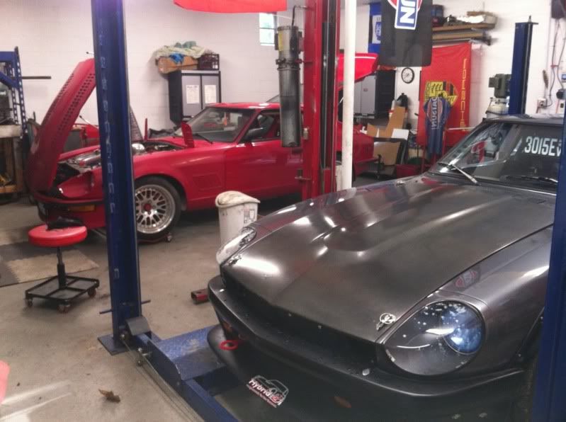

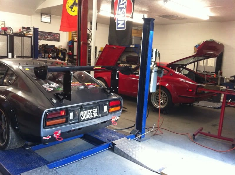

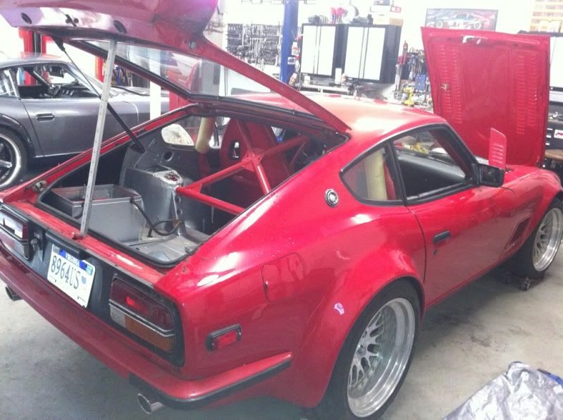

Mikelly Posted October 15, 2011 Author Share Posted October 15, 2011 So it's been six days since the Porsche was sold and I have decided to get the red Zcar in the shop and start looking at what it's going to take to get it sorted for its owner: Getting ourselves quite the Zcar garage going now... Sorely miss the black beauty though... Mice had made a nest in the car two years ago, and I have no clue what we may find... There is rust also in the engine bay, the rear hatch strut towers, and various other places from where the car has been in and outdoors. Also, it appears that the rear flare on the driver's side had cracked under the paint, and now moisture has frozen and lifted the paint/bodywork over time. There are also other areas where the paint has been nicked or rust has come through. Fortunately it's all surface rust and the timing of getting the car out of the weather is probably very good... This much I already know it needs: Starter replaced Steering shaft replaced Conversion from Fuel injection to Carburetor (unless owner wants to convert the system to FAST or other ECU) Wiring sorted All fluids flushed Paint/body work I'll be having a discussion with the owner to see what he wants to spend and is willing to do. My goal is to get the car into a state of operation such that it can move under its own power. Then it'll be up to Jim to decide on the rest. Mike Quote Link to comment Share on other sites More sharing options...
garvice Posted October 15, 2011 Share Posted October 15, 2011 Mike, Nice workshop, couple of questions though. How did you get the red Z in there? I noticed the wheel dollies, but couldn't see a way in. Also, is that a four post hoist and a two post hoist in the one bay? Is the four post hoist hard to work around when the car is on the two post? I have a two post and find it very good to work around, just trying to work out the benefit to you having a four post aswell. Quote Link to comment Share on other sites More sharing options...
Mikelly Posted October 15, 2011 Author Share Posted October 15, 2011 (edited) Garvice, My fourpost lift has wheels for it to move around. What I do is move the lift forward at an angle and then we can get the car in at about a 45 degree angle thru the opening. Now, on the situation with the twin post and four post lift, I find having both combined works very well. Especially when setting a car up and trying to work out bumpsteer, it's nice to have the twin post to work the platform of the fourpost so you can simulate the travel of the suspension on all four wheels. What's more, I've not had any issues working around each of them to get work done. Mike Edited October 15, 2011 by Mikelly Quote Link to comment Share on other sites More sharing options...
