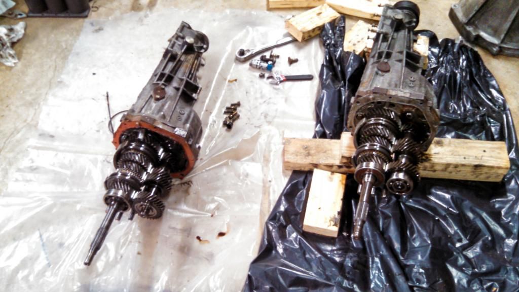

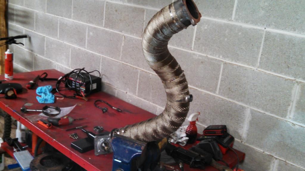

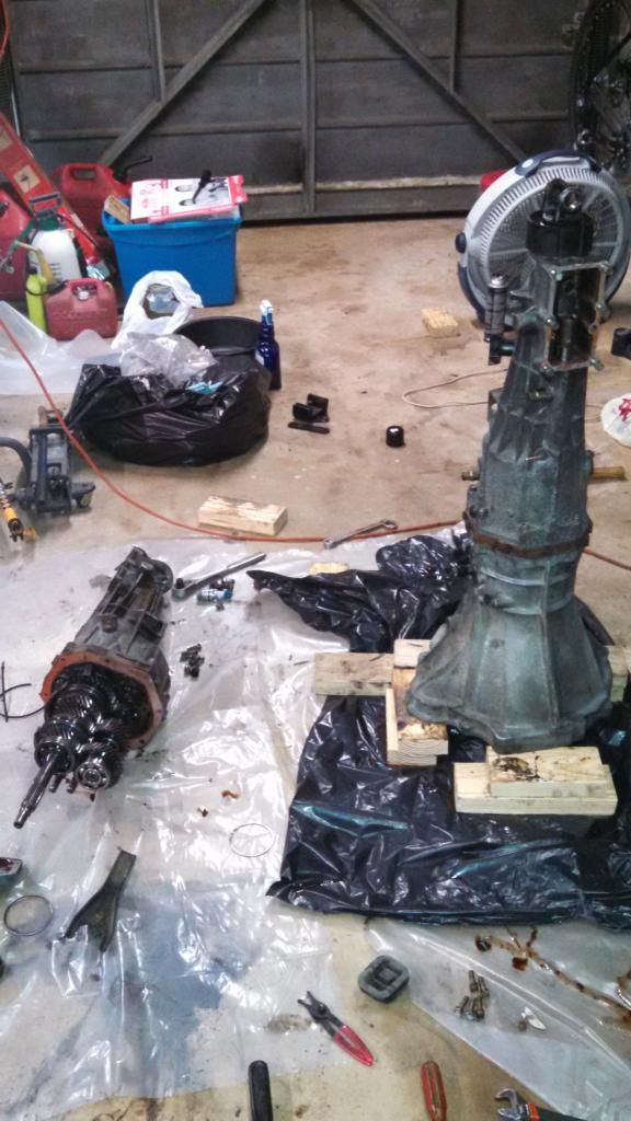

wigenOut-S30 Posted September 15, 2014 Author Share Posted September 15, 2014 (edited) Wow, it has been a loooooooooooooooong time since I have updated this thread... Well in 2011, I went back to school to finish up my BA degree.. In the middle of that, (2012ish) I broke the KA trans.. I didn't want to work on the Z and lose focus of school.. I finished school and my Z just sat for a pretty long while.. I lost motivation, Well I am motivated again and back working on the Z.. I found another KA trans and took my old one out and apart. I found the original 280ZX counter shaft bearing is what failed. I ordered a new counter shaft bearing and installed it on the KA trans and then swapped the bell housing.. While the Z was down, I replaced the leaky front main seal and wrapped the down pipe. I am installing a new boost gauge and soon will install a water temp gauge and oil temp gauge. I hope to be back on the road here soon and back in boost. Edited September 15, 2014 by wigenOut-S30 Quote Link to comment Share on other sites More sharing options...

wigenOut-S30 Posted September 16, 2014 Author Share Posted September 16, 2014 I like it a lot better, I make about 400 wheel and 400ish TQ.. it has taken the abuse over the last 5 years. The only reason it failed on me was because of the 280ZX countershaft bearing.. it was the original out of my ZX. I have a brand new nissan OEM countershaft bearing in the new KA trans now.. I should be putting it back in tonight.. I might be going Z32 trans pretty soon and the full KA swap with driveshaft and trans mount might be up for sale soon. Quote Link to comment Share on other sites More sharing options...
wigenOut-S30 Posted September 18, 2014 Author Share Posted September 18, 2014 New KA trans is in !!!!! Fluids filled and drive shaft bolted up.. Now onto bolting up the exhaust, and putting all my stuff together in the engine bay!!! Quote Link to comment Share on other sites More sharing options...
