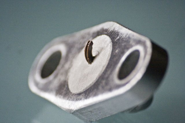

TrumpetRhapsody Posted June 27, 2009 Author Share Posted June 27, 2009 PM sent, thanks Daeron. Found the culprit that killed my turbo Seems somehow some rtv found its way to the oil feed, and blocked it. No oil to the turbo = death. I can thank the PO for this one I'm sure, dunno how rtv would get to be floating around in the oil. Quote Link to comment Share on other sites More sharing options...

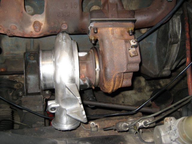

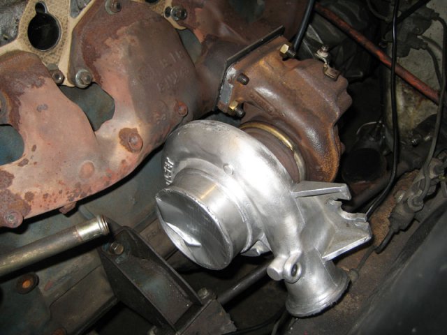

TrumpetRhapsody Posted July 9, 2009 Author Share Posted July 9, 2009 Well, I was talked into going ahead with the Holset swap instead of tracking down another stock T3, and I've bought some nice goodies get things going... but more on that later. I don't know why, but my early HY-35 wasn't a bolt on affair like it should have been. Aside from drilling out the bottom two flange holes (knew about that), I also have had to clearance my manifold and make a spacer. Once I account for the spacer and a gasket on each side, I should have about 2mm of clearance between the housing and manifold. I had a friend cut me a flange to mate to the hotside, and I'll need to pick up some 3" piping to custom make a d/p to interface with my current exhaust setup. Hopefully I'll be able to do most of that tomorrow. Aside from that, once the rest of my goodies get in i'll need to mock up the intercooler piping, fabricate a bracket for the wastegate actuator, and figure out a way to attach my BOV to the charge pipe (pics of that issue later). Quote Link to comment Share on other sites More sharing options...

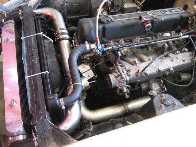

TrumpetRhapsody Posted July 12, 2009 Author Share Posted July 12, 2009 So the holset is officially in. I had it running for awhile, got all the shmootz burned off, everything up to temp. I'm waiting on some couplers to get the intercooler attached, and I still need to fab a bracket to get the wastegate actuator to work. Also, the hood won't close due to coupler interference, so I need to pull the IC and trim the core support to center it more. After all that it'll be BOOOOST. I can definitely say that this process was a huge PITA. It's nice to have the holset on, but I wish I had just gotten another T3 to hold me over. But, what's done is done! Quote Link to comment Share on other sites More sharing options...

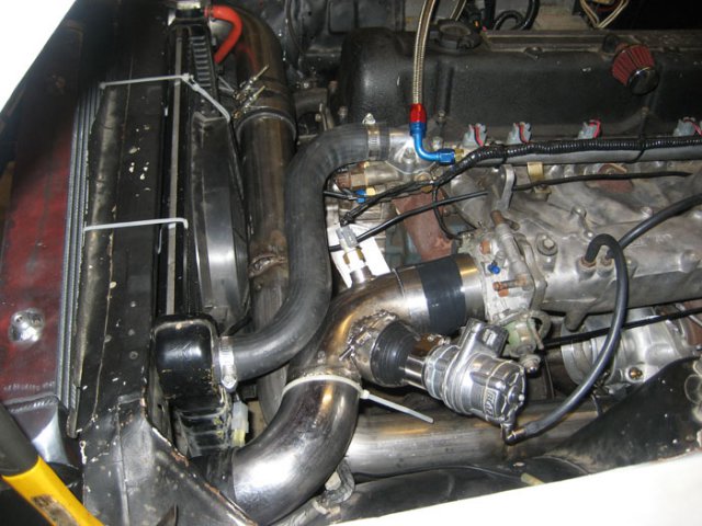

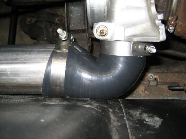

TrumpetRhapsody Posted July 16, 2009 Author Share Posted July 16, 2009 My couplers came in yesterday, but I had to go pick them up from the post office this morning. I had a bit of time left over before I had to be in for work, so i went ahead and installed them. The angles aren't perfectly ideal on all of them, but they should work for now. A bit of modification and finagling and I might get a better result, but that'll be for later. After work I'll fab up a bracket for the stock wastegate actuator, and start tuning! Quote Link to comment Share on other sites More sharing options...
TrumpetRhapsody Posted July 16, 2009 Author Share Posted July 16, 2009 The Holset Z lives! I'm getting a nice solid 7psi, good boost response, and everything feels very solid. I'm having to richen up my map quite a bit, as expected, but so far nothing over 50% dutycycle, and I'm getting good AFR numbers. Pics and vids to come Quote Link to comment Share on other sites More sharing options...
