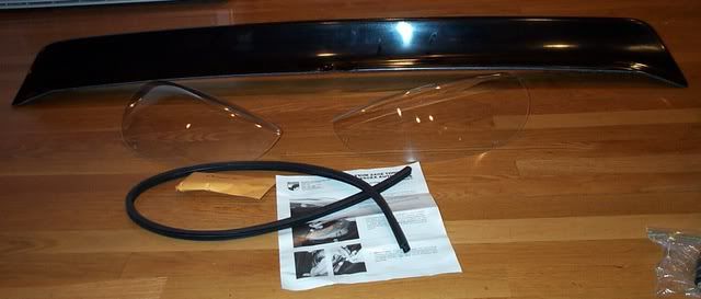

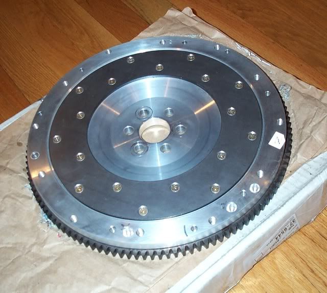

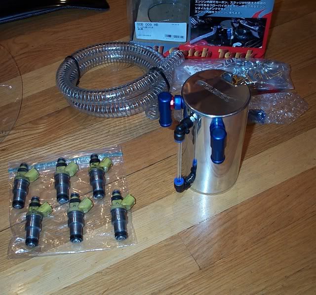

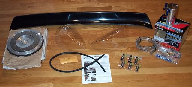

I got some parts in from MSA today: BRE rear spoiler, clear headlight covers, Cusco oil catch can, and two polished block-off plates. I also got my Fidanza flywheel and Supra 295cc injectors in, and should be getting my downpipe and ported intake manifold in soon. Here's some pics:

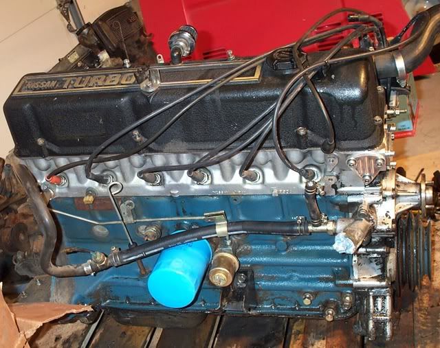

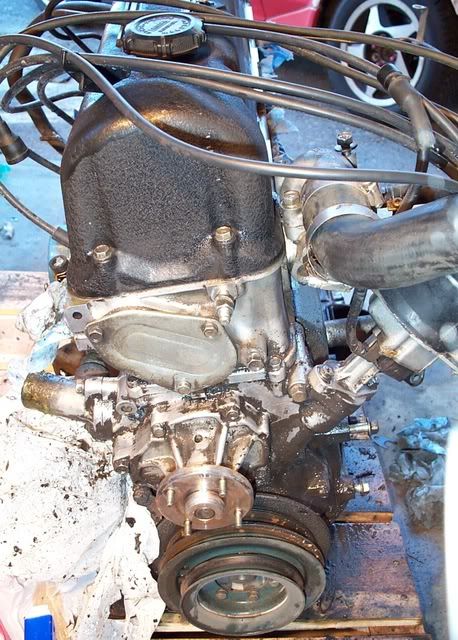

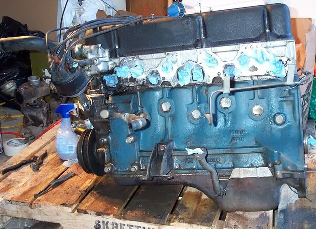

I also got some more cleaning done on the engine tonight. 26 years of grime is a PITA to remove! I'm not looking for car show-winning cleanliness, just clean enough to work with. It will get a major cleaning when I get it rebuilt, probably next year.

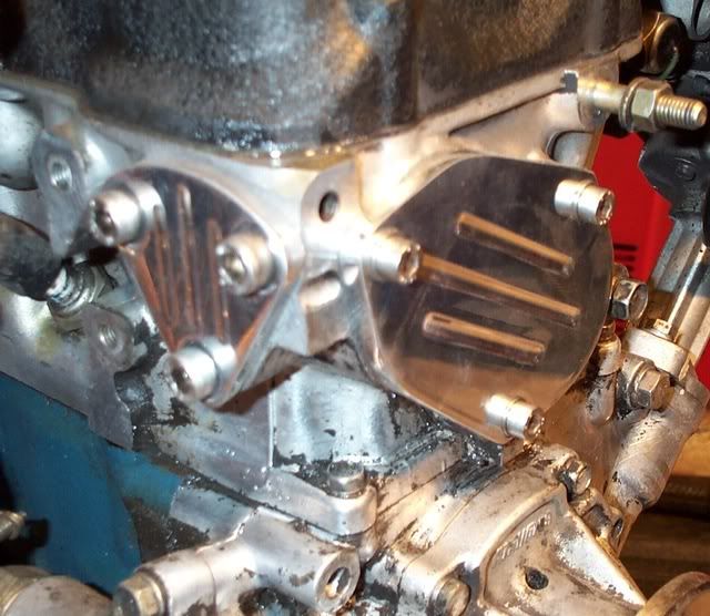

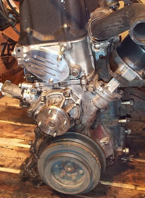

My shiny new polished block-off plates...if only the rest of the engine could be so shiny. :(
When I get a full gasket kit in, I'm going to take all the accessories off the front and give them a proper cleaning. It's just not working with everything assembled.

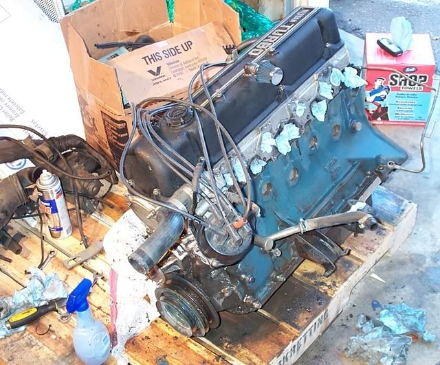

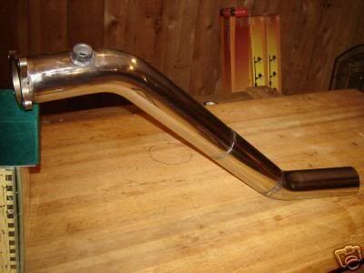

Just a small update: I got my downpipe in and bought an engine stand at Autozone so I could get the engine off the pallet and work with it more easily. Cost me just under $75, with a trip to Lowes to get bolts and washers to mount the engine. Now I'll be able to turn it upside down when I need to replace the oil pan. I'll be ordering a gasket kit shortly, and once I replace the major gaskets I can start putting everything together. The transmission should hopefully be ready in a week or two if everything's on time.
