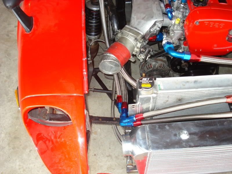

same radiator in the new car.

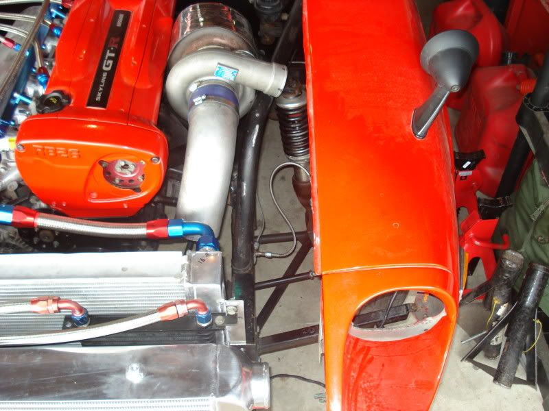

The intercooler i have is the 4 inch thick, 12 inch tall, and 24 inch wide core.
With this one if you cut off the inlet and outlet that the end tanks come with and weld on some 90s they point right at the openings in the stock Z core support that the tubing need to go Thru.
That is one of the reasons i went with the cheapo initially was if i had to cut i didn't want to buy a 1500 intercooler, cut on it and mes it up :>
But since its working fine i will keep it for now :>
