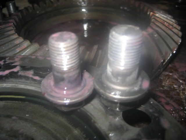

Guest 3ftyZ Posted March 30, 2008 Share Posted March 30, 2008 I have a question about this, forgive me as I'm still learning. Yes, i have read all the FAQ's but am still a bit confused. The difference between the 12mm and 10mm bolt is what? Length, width, shoulder size, thread depth? ...or all of the above? Racinjitter - when you say a sleeve is needed for this to work in an R200 (which applies to me), is this a sleeve for the shoulder? I'm not quite sure what this is as I have not seen the innards of my r200 or a 12mm v. 10mm setup. I would like to purchase this LSD if i can figure out what it will really take to get this set up properly. Also, I have a 73 240z running an r200 and i have a spare r200 as well. I purchased the car with the r200 installed so I am not positive this LSD will work for my application, how can I determine the LSD mentioned in this thread will work for me? TIA, 3ftyz Quote Link to comment Share on other sites More sharing options...
SATAN Posted March 31, 2008 Share Posted March 31, 2008 I have a question about this, forgive me as I'm still learning. Yes, i have read all the FAQ's but am still a bit confused. The difference between the 12mm and 10mm bolt is what? Length, width, shoulder size, thread depth? ...or all of the above? Racinjitter - when you say a sleeve is needed for this to work in an R200 (which applies to me), is this a sleeve for the shoulder? I'm not quite sure what this is as I have not seen the innards of my r200 or a 12mm v. 10mm setup. I would like to purchase this LSD if i can figure out what it will really take to get this set up properly. Also, I have a 73 240z running an r200 and i have a spare r200 as well. I purchased the car with the r200 installed so I am not positive this LSD will work for my application, how can I determine the LSD mentioned in this thread will work for me? TIA, 3ftyz The difference is in the diameter of the bolt threads. See... If you have 29 spline input shafts then the diff Jason mentioned should work just fine. You can either make the spacers to fit around the 10mm bolts to take up the 2mm of play. OR, you can tighten the bolts down to the appropriate specs. I have READ that that is good enough. Or you could have custom bolts made with the 12mm shoulder. Tapping out the ring gear is something you might not want to do. I was thinking of having this done and decided against it for a couple reasons. I would have to take it to a machine shop to have it done since the ring gear is hardened. SINCE it is hardened it would most likely cost a ♥♥♥♥ load to have 10 holes tapped. They would have to have a tapping method to where the tap would not go all the way through the other side into the actual teeth of the ring gear. I just decided to torque mine down and hope for the best. With 10 of them holding that bitch, I really dont see it breaking. The other thing that has been bothering me is that everything that I have read says that the 84-89 r200 ring gears all use the 12mm bolts. I along with others have pulled them apart to find they are actually 10mm bolts. Mine was a CLSD out of an 88 turbo z. I'm wondering where all the info came from that said they are supposed to be 12mm. Quote Link to comment Share on other sites More sharing options...
jeffer949 Posted March 31, 2008 Share Posted March 31, 2008 i didnt use spacers on my bolts when i did my swap into a 3.54 out of a 82zxt its been in my car for a month or so now and been down the track probably 10 times and still no issues. Quote Link to comment Share on other sites More sharing options...
SATAN Posted April 6, 2008 Share Posted April 6, 2008 The difference is in the diameter of the bolt threads. See... If you have 29 spline input shafts then the diff Jason mentioned should work just fine. You can either make the spacers to fit around the 10mm bolts to take up the 2mm of play. OR, you can tighten the bolts down to the appropriate specs. I have READ that that is good enough. Or you could have custom bolts made with the 12mm shoulder. Tapping out the ring gear is something you might not want to do. I was thinking of having this done and decided against it for a couple reasons. I would have to take it to a machine shop to have it done since the ring gear is hardened. SINCE it is hardened it would most likely cost a ♥♥♥♥ load to have 10 holes tapped. They would have to have a tapping method to where the tap would not go all the way through the other side into the actual teeth of the ring gear. I just decided to torque mine down and hope for the best. With 10 of them holding that bitch, I really dont see it breaking. The other thing that has been bothering me is that everything that I have read says that the 84-89 r200 ring gears all use the 12mm bolts. I along with others have pulled them apart to find they are actually 10mm bolts. Mine was a CLSD out of an 88 turbo z. I'm wondering where all the info came from that said they are supposed to be 12mm. I just wanted to point out the fact that I am an idiot! The bolts out of the 88 z31 turbo diff ARE 12mm. The bolts that came out of the Q45 diff are 13mm. I could have swore that I measured them before, but I guess not. I actually did this time. It is 12mm for the z and 13mm for the Q. Sorry guys. Quote Link to comment Share on other sites More sharing options...
