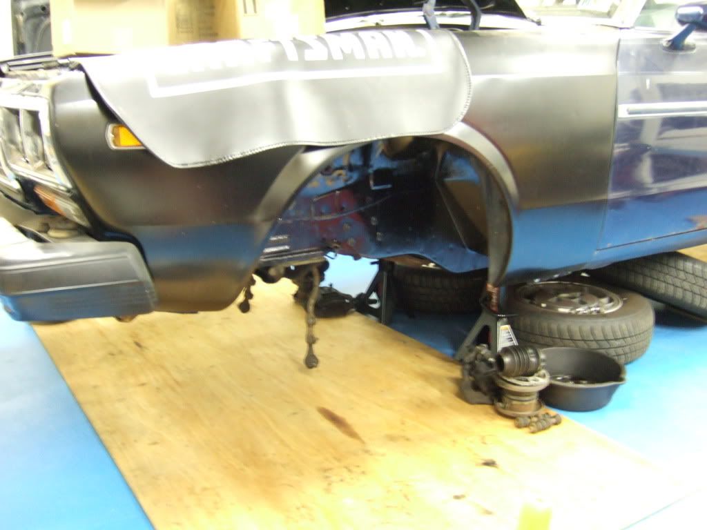

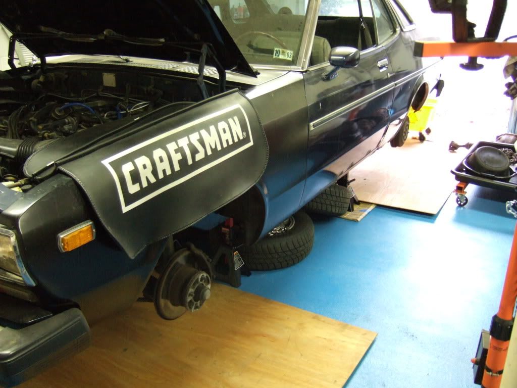

So after much pondering and after selling the Versa I have decided to keep the 810 for good!! This past weekend the 810 was put up on jack stands and the tear-down has begun.
Front Suspension
I have started on the front suspension and will work my way to the rear. Since the front calipers are no longer available (NLA) from Nissan, in working with Steve Golik (zcarnut) another 810 owner I sourced Brembo Nissan Maxima vented front rotors and Toyota 4X4 4 piston front calipers. The front rotors will need to be machined to match the lug pattern and rotor hat opening to accept the 810 front hub. I also sourced Addco front Nissan Maxima front sway bar which is an upgrade to the 810. Also Energy Suspension urethane lower control arm, tc rod, and tie-rod end link dust covers. The Earl’s store in Lawndale California built the stainless steel braided lines from Mr. Golik’s specs.

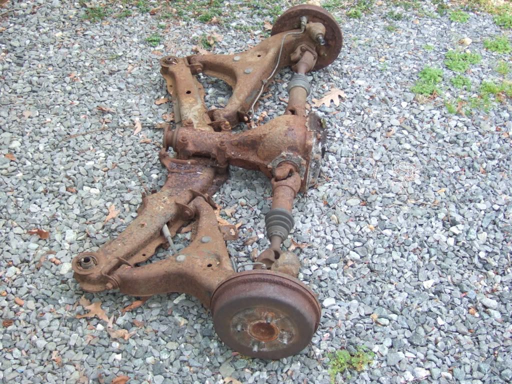

Rear Suspension
Again many thanks to Mr. Golik! I sourced a complete 280ZX Turbo rear suspension assembly. The rear suspension on the 810 is identical to the S130 or 280ZX. I purchased new Brembo 280ZX Turbo rear rotors and remanufactured 280ZX Turbo rear calipers. I also purchased Addco 280ZX Turbo rear sway bar, Nissan cross member bushings and Energy Suspension lower control arm urethane bushings. This will give me rear disc brakes and rear sway bar.
The entire suspension will be power coated and the under belly will be POR-15.

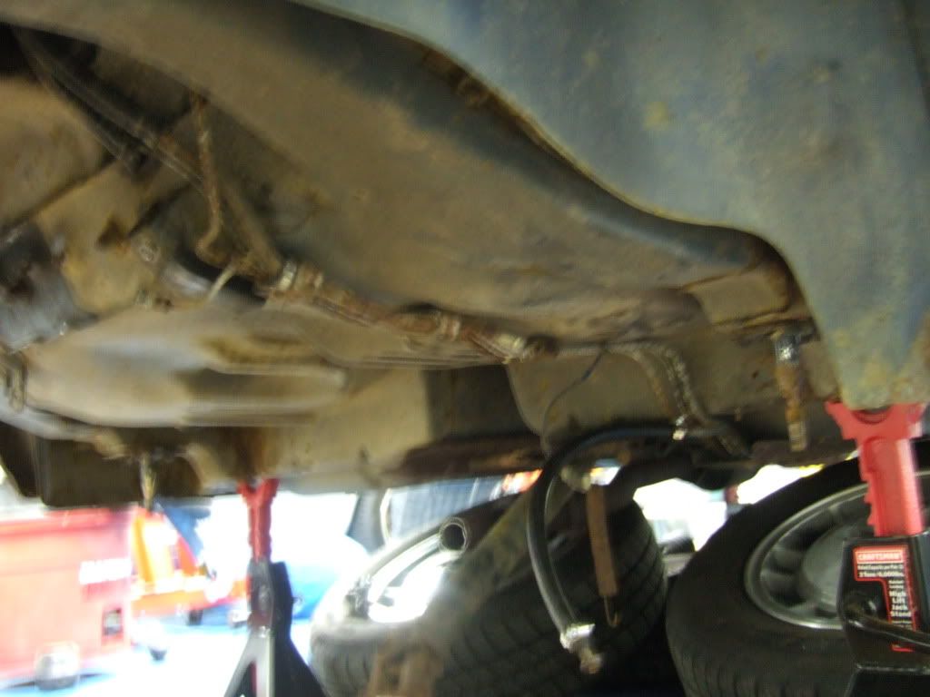

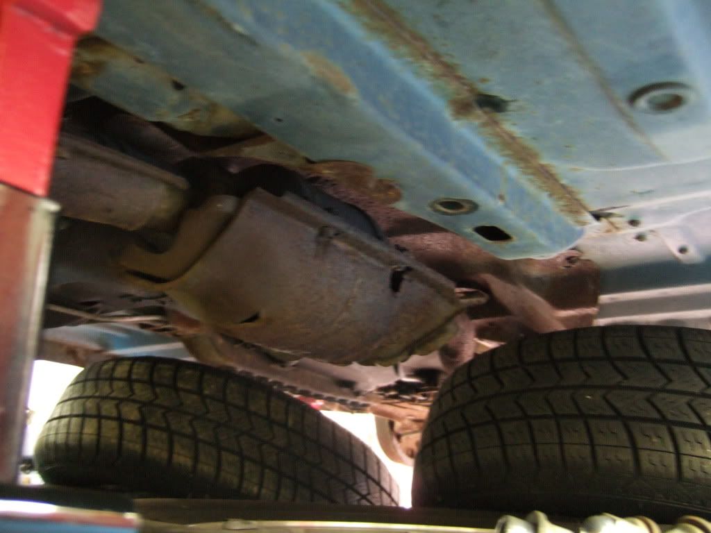

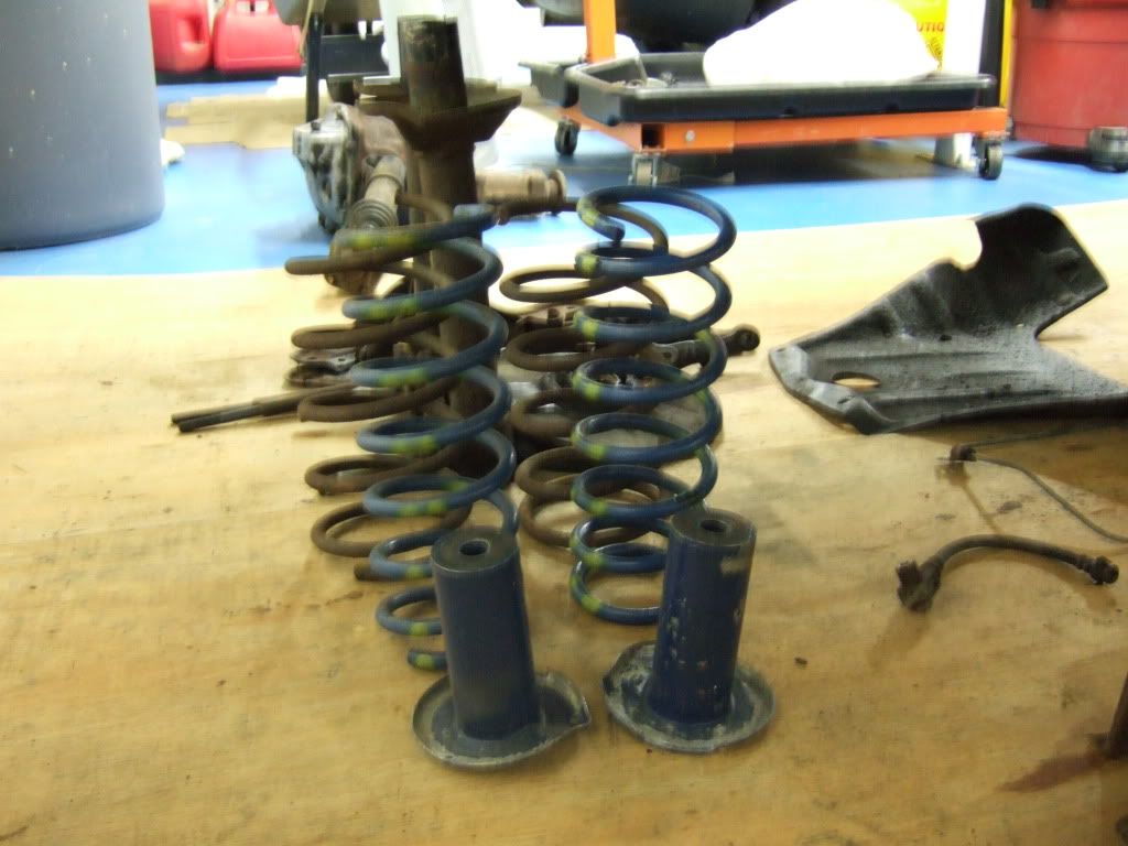

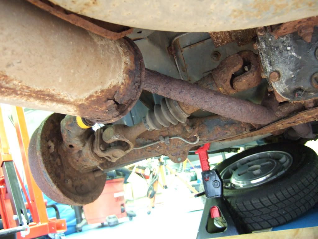

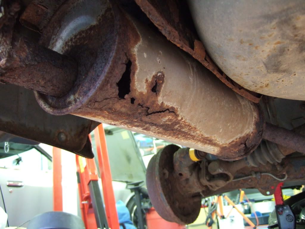

Well after a long and tiring weekend the following was completed:
• Front and Rear Suspension gutted
• All parts disassembled and ready for degreasing, bushing removal then powder coating.
Old 810 Suspension:
What's left of the stock exhaust
Ready for Powder coating
Front Suspension gone
Rear suspension gone

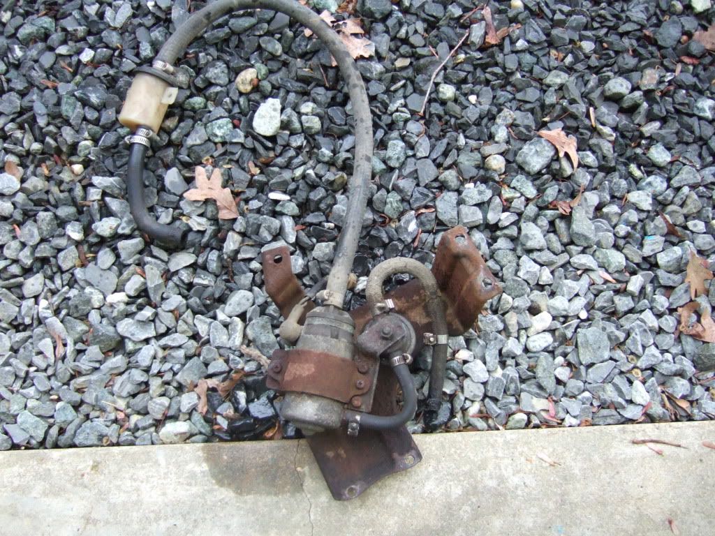

Stock fuel pump removal..yuck
