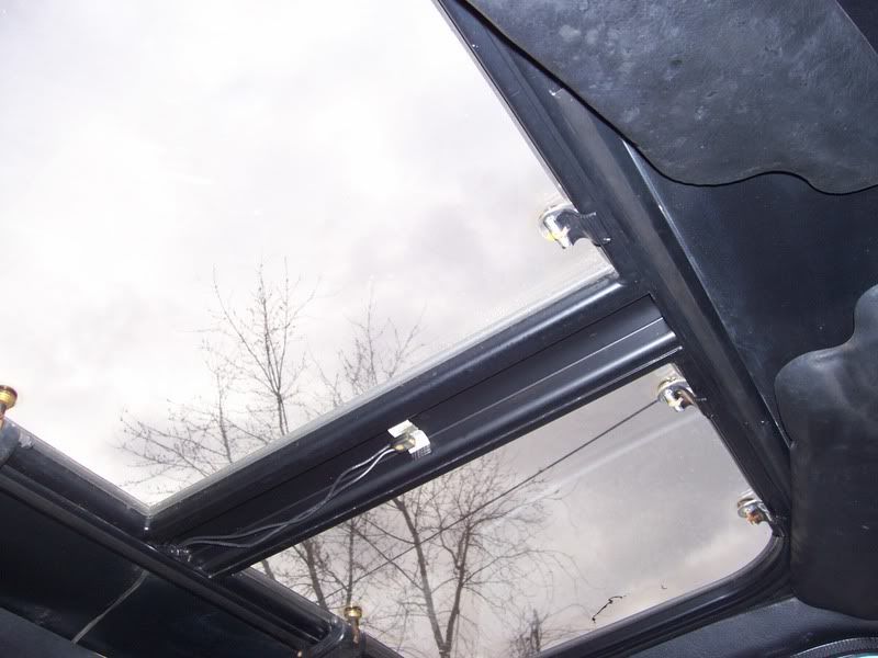

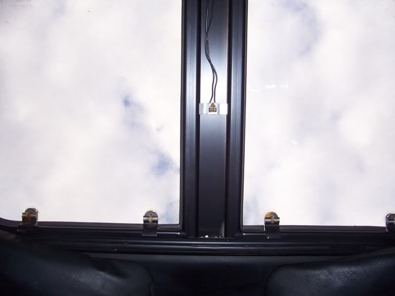

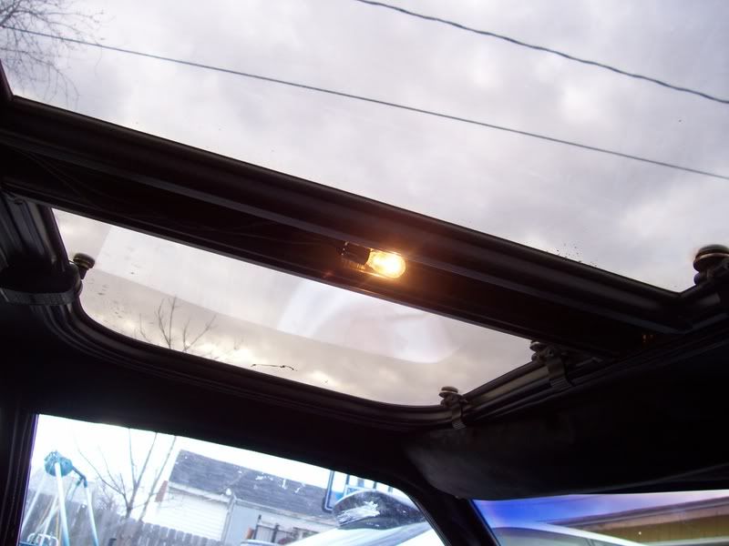

chrism Posted May 7, 2008 Share Posted May 7, 2008 That's gotta suck. I would opt for a bike before using the minivan. I noticed the other day that my battery was dead and come to find out, the dome light decided to start working. It's not very bright so I didn't see it on in the daytime. The next morning the car would not run good. Charged the battery and the car was fine until the next day. Charged the battery again and noticed that evening that the light was on. Do like deja suggested and pull the fuses to the circuits that are not needed. Process of elimination. Quote Link to comment Share on other sites More sharing options...
midnight-z Posted May 7, 2008 Author Share Posted May 7, 2008 I though it was a dead bulb the first time I set foot in it. on the second day I cleaned out the car and took it out & put it back in and it started glowing I could not make it stop it I took it out its now an empty slot what is it for ???? plus I have the normal dome light like every one else. today I took out the battery and all fuses and created a lable chart & cleaned inside fuse holder clips tomarow Ill finish it second I will diagnous the electrical harness and alternator Quote Link to comment Share on other sites More sharing options...

Daeron Posted May 13, 2008 Share Posted May 13, 2008 All hell broke lose when that dinky battery was placed on to the Z Chances are that the dinky battery had more juice in it than your previous one. The light on the roof that you are having issues with is not a stock light. No 280Z ever came with a sunroof like that, and they all came with the same dinky dome light behind your headrest in the ceiling. If that light that you showed is powered by the stock dome light wires, then nevermind... BUT if that thing has its own wiring (which seems like a reasonable possibility) then your entire problem may lay with that. http://s170049317.onlinehome.us/V8-240z/Files/Datsun/Wiring/Common%20Electrical%20Testing.pdf read that page, it should help you understand how to use a multimeter, and with any luck reading that and solving your problem will make alot more about automotive electrical systems "click" in your mind. Quote Link to comment Share on other sites More sharing options...
midnight-z Posted May 19, 2008 Author Share Posted May 19, 2008 I took out the holder and cleaned front to back. But I have not been able to use any electric testing devices beacuse my brother took them all to his house , Until next sunday. When I need them the most! I mostly cleaned the wheels and washed the car & sanded & primered rust past few days Here is more pics of the wierd bulb I been having trubole finding sunroof pieces on the web, I wonder how much it is for the oem plastic cover that goes over that gap A british dude said he had sunroof datsun pieces they seem to be rare I'll have to wait for my stimlator tax to arive and my fuse box. Quote Link to comment Share on other sites More sharing options...
Daeron Posted May 19, 2008 Share Posted May 19, 2008 None of the cars came from the factory with a sunroof. I imagine some dealers may have added them as options, but the "common wisdom" that I grew up with says that any aftermarket sunroof in a Z roof will eventually leak (something to do with both the flex from a unibody car, and the fact that the roof curves both from front-to-back and side to side.) For that reason to my old man (and therefore, to me until proven wrong) a car with a sunroof is not the greatest option... I would suggest trying to find a way to disconnect that light and any associated wiring from the power source. Since it IS non-factory, the closer you can get to where they tapped into the factory wiring, the better. Another reason I brought up the non-OEM aspect of the sunroof is to point out that they are NOT all the same; any tim you may find someone with the cover pieces, make sure you get accurate measurements on what you buy and what you need before exchanging money. Size, shape, screw location, anything that may be of importance. There is no "standard;" even though one thinks there can't be too many different brands out there, it is just an aftermarket sunroof. You can buy one from JC Whitney and put one on any car, in theory. Also, if you can find a Harbor Freight store near you, cheap digital multimeters can be had.. ie, under $10. Even at home depot they sell some for as little as $15. If you have access (ie, can borrow) to a GOOD meter, then a five dollar cheapie is a VERY valuable tool to have in your own pocket; I've only personally owned one decent meter, because my dad and my uncle have a few good ones around.. so when I need reliable numbers, I use my uncle's Fluke. 99% of my testing, ballpark figures are good enough, and the series of $5 multimeters from harbor freight have been more than sufficient. Hope I'm helping Quote Link to comment Share on other sites More sharing options...
midnight-z Posted May 20, 2008 Author Share Posted May 20, 2008 I thought they were special order from the Yokohama factory as a optoin or something. Because saw about 5 sun roof Z's online one hade a all metal moon roof that would go up an back like a Prelude the others had one gaint window that opens up it looks like a pro job & it doesn't leak I thought the wiring was exposed by the owner that tryed restore the cars interior. I'm missing alot of plastic rivets for panels I'll try using honda ones The meter my brother took was a bad ass digital multimeter I'll wait until saturday Quote Link to comment Share on other sites More sharing options...
