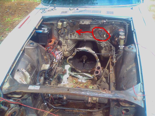

Gritz Posted July 7, 2008 Author Share Posted July 7, 2008 Well as planned my brother and i pulled the engine today.....And what a mess it was...35 years of grim and dirt.... Pressure washed everything down...and finished with fresh coat of gloss black....sorry for the crappy pics... Quote Link to comment Share on other sites More sharing options...
280Zone Posted July 7, 2008 Share Posted July 7, 2008 after you said you painted and all, but... The two holed thing on the firewall needs to be moved back. Quote Link to comment Share on other sites More sharing options...
Gritz Posted July 7, 2008 Author Share Posted July 7, 2008 280Zone said: after you said you painted and all, but... The two holed thing on the firewall needs to be moved back. ok, for what reason? Quote Link to comment Share on other sites More sharing options...

RUSSJZ-ZED Posted July 9, 2008 Share Posted July 9, 2008 280Zone said: after you said you painted and all, but... The two holed thing on the firewall needs to be moved back. That's the position of factory aircon in/out on a RHD car,it stays where it is, he needs a slightly different (in the size department) "two holed thing" for his heater in/out. Quote Link to comment Share on other sites More sharing options...
