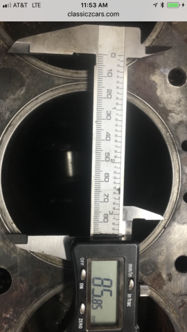

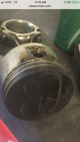

madkaw Posted December 13, 2017 Share Posted December 13, 2017 86mm pistons not sure what I’m seeing as far as the ‘ring’ around the bore Quote Link to comment Share on other sites More sharing options...
