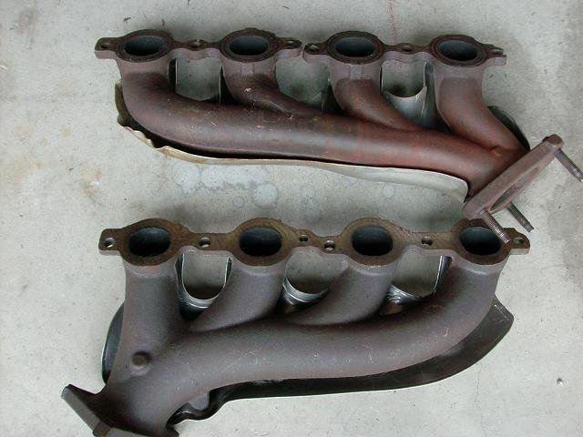

yessir Posted August 27, 2008 Share Posted August 27, 2008 planning a turbo lq9 swap,,, currently trying 2 get all the parts 2gether that i will need,, ive noticed that the flipped truck manifold is popular among tha f-body guys and was wondering if anyone has done it in a Z? if it will fit or any other info??? Quote Link to comment Share on other sites More sharing options...

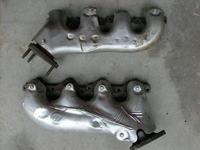

Scottie-GNZ Posted August 27, 2008 Share Posted August 27, 2008 Before you even figure out if they will fit the Z chassis, they can only be used if you have no a/c compressor and a high-mounted alternator or both compressor and alternator high-mounted. If that is all OK, then the issue is clearing the steering shaft. I have a pair from a 5.3L you have cheap to help me clean out the garage. In the pics, the one on top would be on the drivers-side. Quote Link to comment Share on other sites More sharing options...
yessir Posted August 28, 2008 Author Share Posted August 28, 2008 plan on relocating alt 2 passgr side head,,,no power steering,,,also plan on usin johnscars mouts Quote Link to comment Share on other sites More sharing options...
Scottie-GNZ Posted August 28, 2008 Share Posted August 28, 2008 Awesome. You are in a position to use those manifolds. I assume the engine is not already in the car, so maybe someone can look at the manifold on top in the pic and tell if it will hit the steering shaft. The lowest point of the manifold is directly under the front port. I think it will fit. Quote Link to comment Share on other sites More sharing options...
