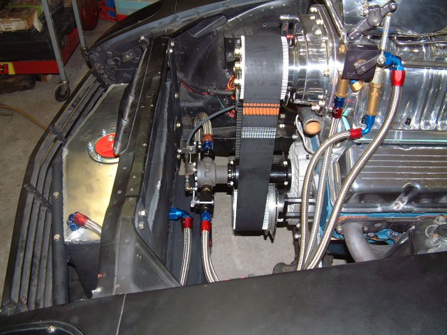

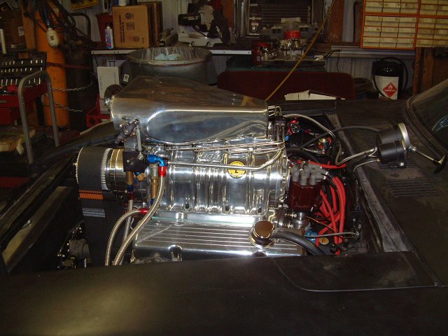

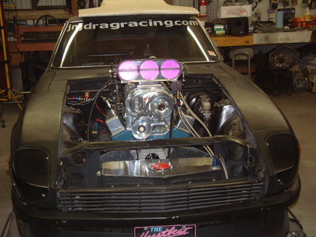

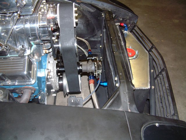

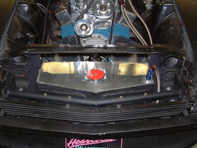

jnjdragracing Posted September 16, 2008 Share Posted September 16, 2008 Well since out last mishap at DNI Drags resulting from bent valves etc. I decided to sell all my upper blower set up and switch to Alky. Sent the blower off to Littlefield to get restripped and clearenced for Alky. Contated Good Vibrations and ordered my Alky setup, Bought a used Bird catcher and rebuilt the engine. Running Alky requires more compression so I had to use Jerry's Dart 230 steel heads witch have been cut to I think 43cc and a 30 Thousands copper head gasket which should bring my compression from 8.5 to around 10.5. The Dart 230 heads have 2.08 intakes valves verses my 2.05 intake valves. Had to order a new Alky roller cam and also have my dish pistons fly cut. Other than that all is the same 355 cu motor. Spent all weekend fabbing up a new fuel cell that would fit in front of the car and also added a little extra front end protection to protect the cell from any mishap. Made the braided fuel lines tonight. Still have to take the feul cell out and chemical seal it. Hope to fire up the monster this weekend. Still need to add the blower restraints. We are getting it prepped for Silver Dollar race way in October. John PS: we will see just how much the little R200 can handle. Quote Link to comment Share on other sites More sharing options...
