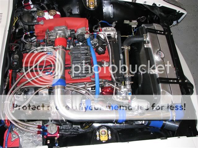

karl Posted March 8, 2009 Author Share Posted March 8, 2009 I finally got the car put back together and have been test driving for two days now. Paint took a lot longer then expected, with the 5 knee surgeries and 2 major back operations with enough titanium rods, screws cages and even a computer implanted back there im not as fast as I used to be!!. I painted the car myself, it was my first paint job. It turned out very good I think and so do most others. It's wimbledon white not bright white like my engine bay. I've upgraded the engine a bit, I've added 550 RC injectors, lexus AFM and a 57 trim turbo. Now its been awhile since i've driven something fast, i've been driving my F250 for ten months as the datsun has been in rebuild jail, WOW the car is very fast. With the super stiff frame, power steering, mazda control arms, sound deadening and coil overs the car is nothing like it was before, it's much better. No squeaks, rattles or groans. The radiator will not keep it cool in traffic so I orderd a Flex-A-lite Black Magic 3300cfm shrouded fan and an aluminum 3 core rad., hope it works because Baton Rouge traffic is a bear. The body seal kit I obtained from Motor sport Auto was ok but the door seals are a little difficult. Im not complaining, im glad there is something avalible, they just don't seal that well. I'll post a pic in a day or two. I've been doing this stuff for 25 years and this site inspired me to do another even with my busted up body, just a little bit every day even if it's just sanding part of a door and the next thing you know it's done. Thank you Hybridz and members for all the great info, be careful and god bless you all. Quote Link to comment Share on other sites More sharing options...

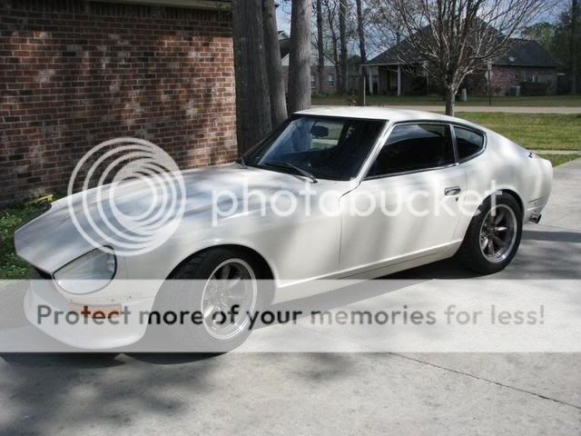

karl Posted March 11, 2009 Author Share Posted March 11, 2009 These are some pictures of my car I took the other day. Quote Link to comment Share on other sites More sharing options...
timbo1jz Posted March 12, 2009 Share Posted March 12, 2009 wow, that thing is super clean and sweet. Nice Job! Thats a badass ride! Quote Link to comment Share on other sites More sharing options...

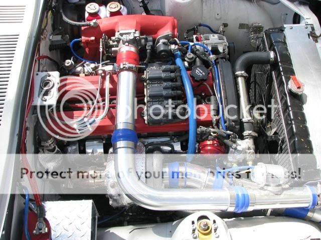

karl Posted March 30, 2009 Author Share Posted March 30, 2009 Engine upgrades! new radiator, fan and some plumbing. Took the car out with new 57 trim turbo and 550cc injectors, this thing is stupid fast when boost kicks in. I do not know why people give this engine such a hard time. I was going 60 mph and went to pass a guy, boost came on and I was laying down two black stripes while passing him. When I turn off the boost controller the car is as easy to drive as an econo box Quote Link to comment Share on other sites More sharing options...

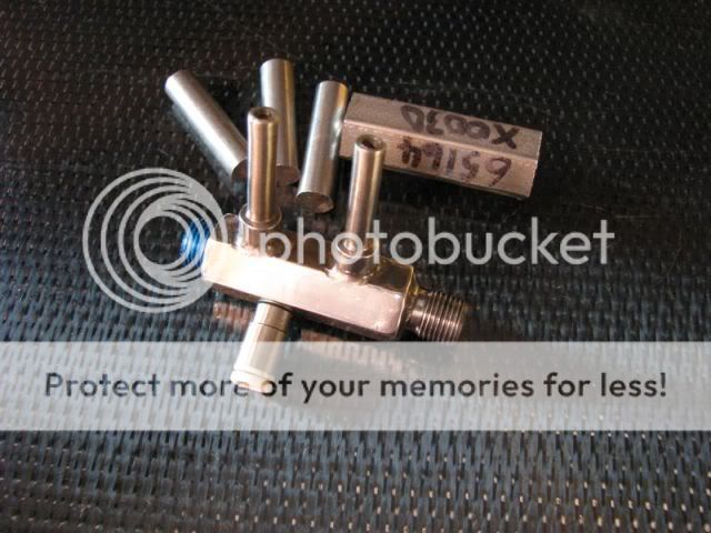

karl Posted April 4, 2009 Author Share Posted April 4, 2009 OK I'll work on a video as soon as I solve the hesitation problem, I wouldn't want the video to be lame. I have friends that know how to post videos on Youtube because I am clueless. Here is another picture of the car and a vacuum block that I fabricated yesterday out of stainless steel, It will attach to the rear of the manifold. The fitting with the plastic end on it goes to my Blitz boost controller. IMG]httIMG]http://i490.photobucket.com/albums/rr262/Karltritr6/Datsun3541.jpg[/img]p://i490.photobucket.com/albums/rr262/Karltritr6/Datsun3551 Quote Link to comment Share on other sites More sharing options...
karl Posted April 4, 2009 Author Share Posted April 4, 2009 OK I'll post a video as soon as I fix the hesitation problem, I wouldn't want to post a lame vid. Here are a couple pictures. I fabricated a vacuum block out of stainless steel scrap. I will connect to the rear of the manifold. The fitting with the plastic end is for my blitz boost controller. Quote Link to comment Share on other sites More sharing options...
