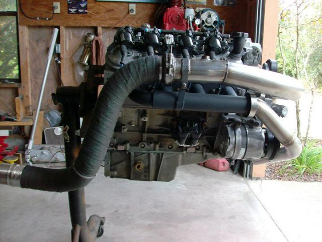

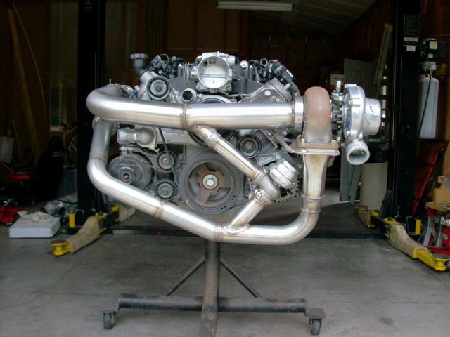

rdsk8ter Posted December 21, 2008 Share Posted December 21, 2008 It does go in for about 1/2 inch pictures dont really do it justice I will let everyone know how it works. It will be a while before I fire it. heavy85 said: The sharp cut you have right at the inlet to the turbo disturbs the flow. Turbo manufacturers have told us that they want nice even flow velocity going into the turbo. Target is something like a 1/2 a meter of straight length to develop uniform flow but since that's usually not feasible we have to rely on CFD (computer simulation) to find a good compromise ... or borrow from NASA Try with and without and see if you see any difference. If you dont see any difference the only thing may be a degradation in turbo life - cant hurt to test and see what you find. Internet search and you will find stuff on diesels using flow straighteners and claims of performance. Cameron Quote Link to comment Share on other sites More sharing options...

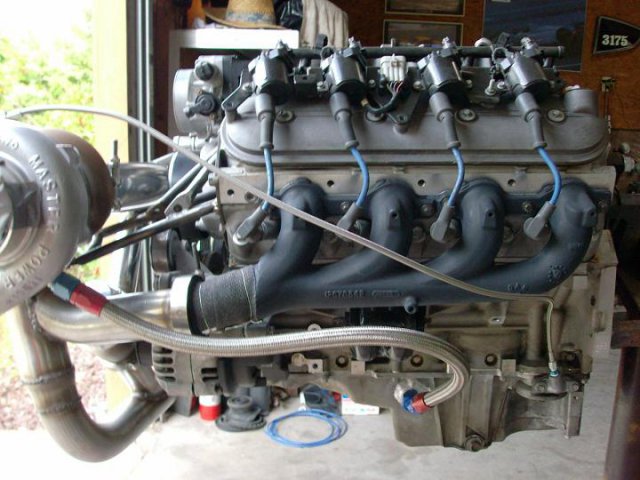

timbo1jz Posted December 25, 2008 Share Posted December 25, 2008 sweet build! you are an awesome fabricator! Quote Link to comment Share on other sites More sharing options...
turbotalon1g Posted December 27, 2008 Share Posted December 27, 2008 Hey is that a stock bottom end? Quote Link to comment Share on other sites More sharing options...
ColtGT4g63 Posted December 27, 2008 Author Share Posted December 27, 2008 Thanks guys, Ya the bottom end is stock. Quote Link to comment Share on other sites More sharing options...
