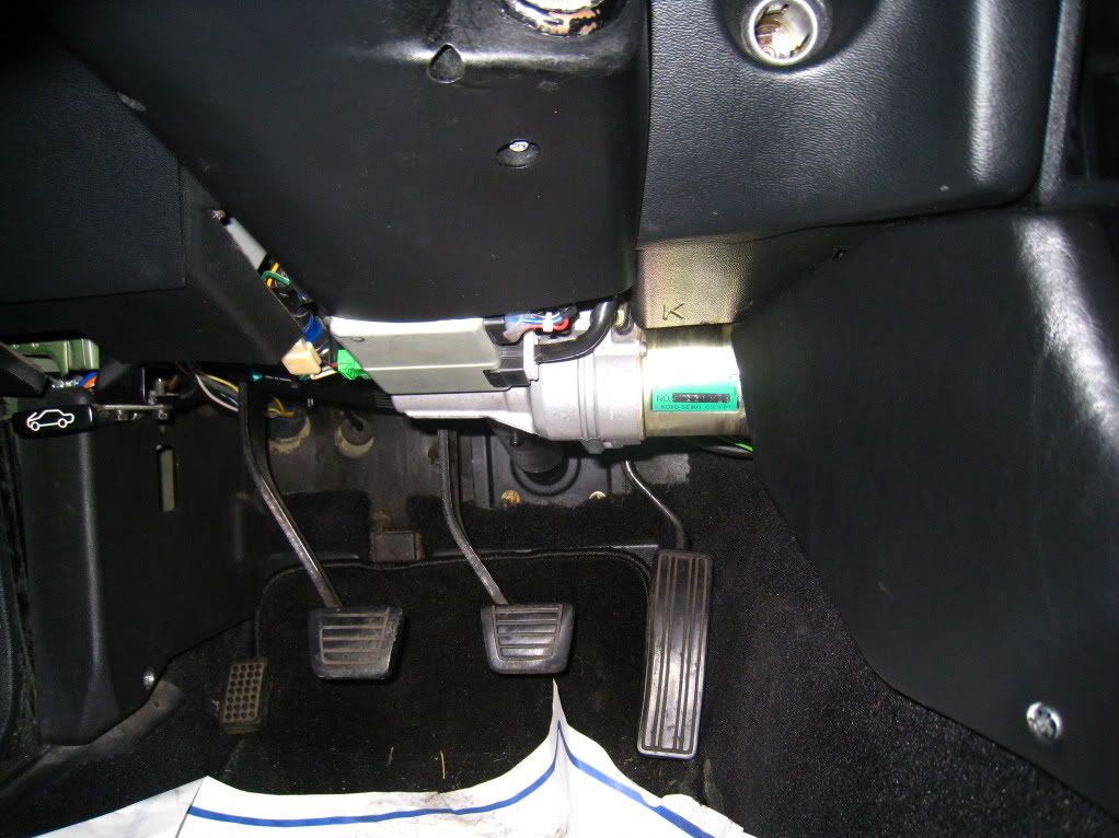

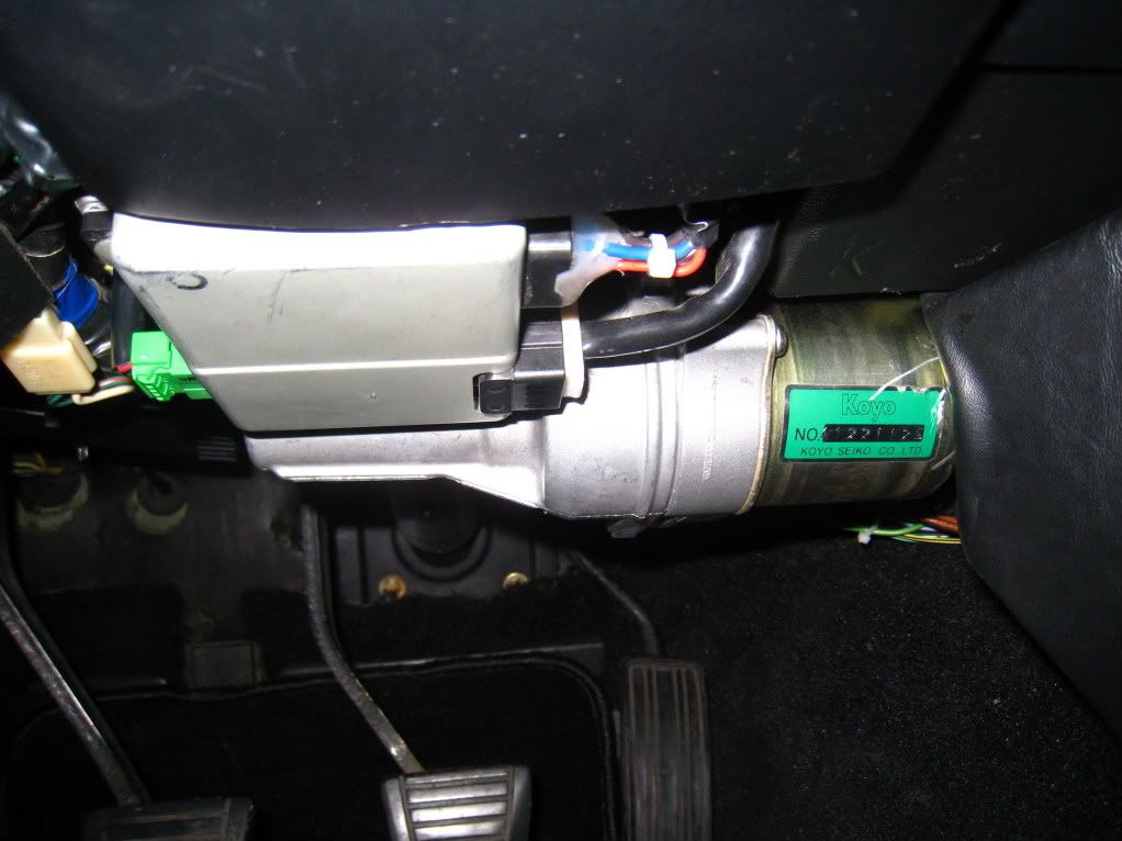

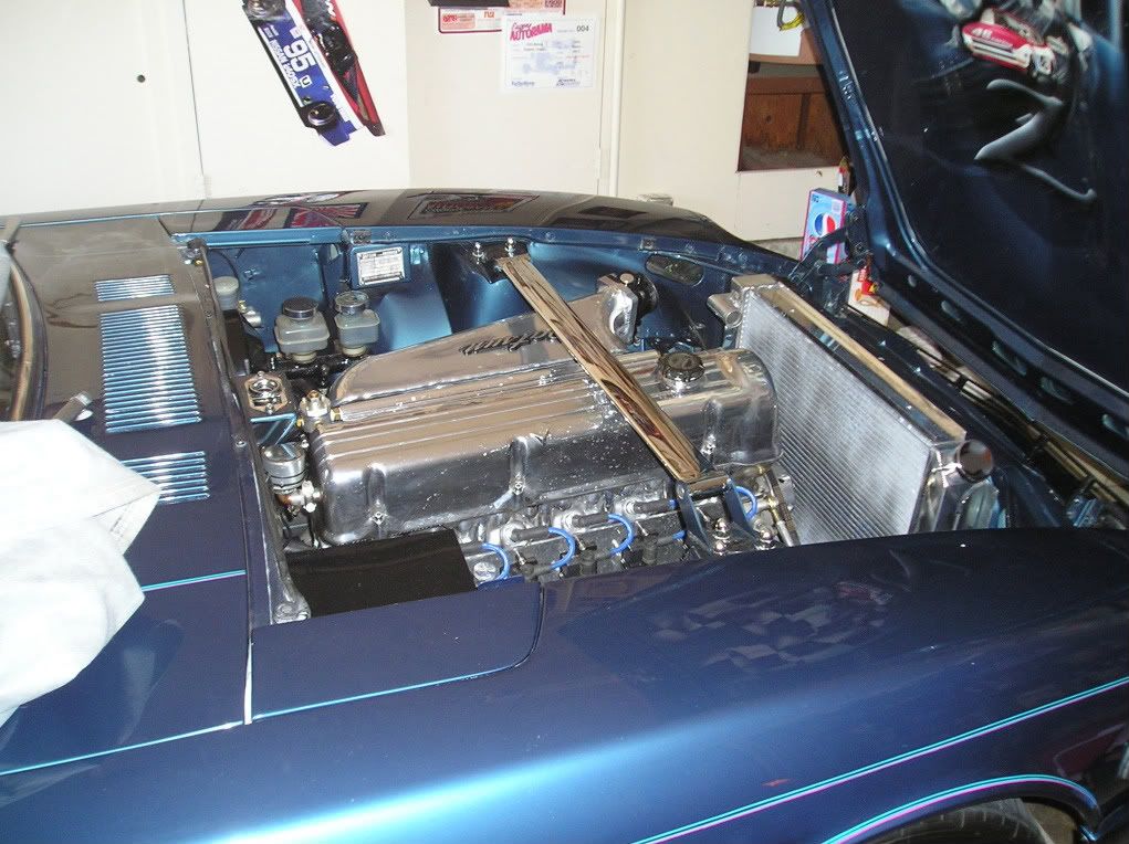

Today I picked up my '76 280Z 2+2 from the shop with my new electric power steering installed. Wow, does it make a difference on how the car handles. I purchased this unit from Brian K. of zcarbum@aol.com fame. Thank you Brian your product it is a seriously very nice addition to my car.
The unit was installed by Dustin Rinehart of Peak Performance in Eugene, Oregon. All work was extremely well done with a very nice custom application. No wires are showing, in fact I don't think anyone would notice the car even had power steering unless they got behind the wheel and drove it.
I have driven it very little presently as the rain is still coming down and I have a lot of clean to do after the car has sat for the last few months at Dustin's shop.
From the driving that I have done however, it is now a very manageable car. The feeling in the steering wheel is very solid and gives you confidence in the handling of the car. Now instead of using muscle by armstrong when trying to steer the car at a stop, it is a two finger job. Very easy, but not too easy to the touch. There is no noice associated at all with the opertation of the ps when in use.
I will be painting the bottom portion of the (motor) black just to hide it from the most discerning eye. Now on to my next project.
