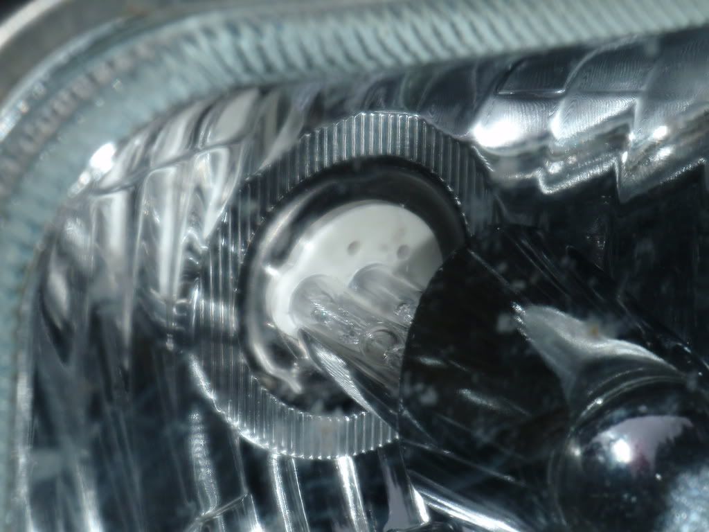

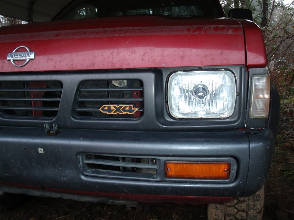

Here is the H4 housings containing the HID's in the Hardbody.
H4 housing...
Close-up of the HID bulbs in the H4 housing...

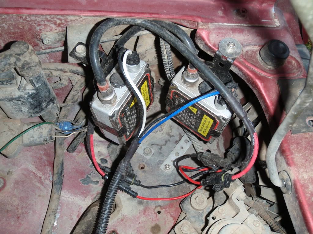

Here is both ballasts for the drivers side...

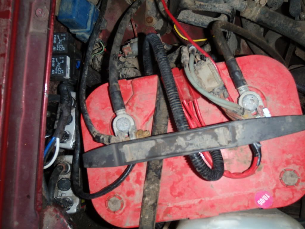

And, here is the load harness/relays/passanger side ballasts mounted and tucked away...
PS: I would like to say that the bulbs work magnificantly, however I wish the housings refracted the light differently. So I may switch up to a Hella H4 housing someday... The low beams are a bit to focused, and the high beams are absolutly redicilous, projecting a beam over 20' high and well past both sides of the road.

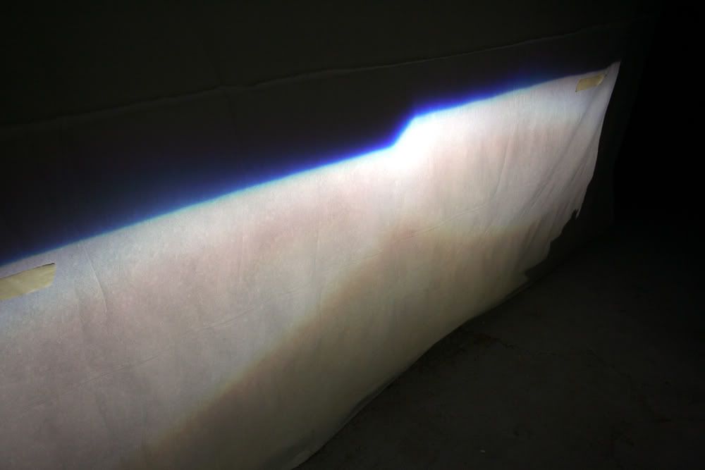

Back on topic, show me so dropped in HID bulbs in crappy housing with a real HID cutoff like this:
I've never seen any proponents of drop in HID bulbs post their cut off.
I agree 100%. The thing is, there is no HID that will look like this unless you have a proper projector housing to spread the light correctly...

Yes, it's meant to be that way so that the light beam is lower on the on coming traffic side of the road. The step is higher on the side where the street signs and such are, for obvious reasons...
Here is how you want to aim them (The bottom one is correct #C)
