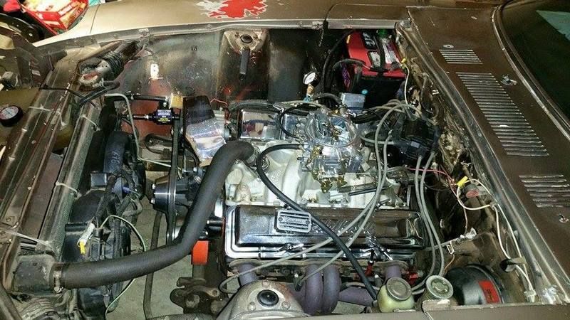

YoSammyT Posted April 11, 2014 Share Posted April 11, 2014 (edited) Mine is a 355 sbc roller motor. I went with Speed Pro hypereutectic pistons - I figure I'll want a different power plant by the time the pistons need replacing, plus they're a little bit lighter. I used powdered rods, Erson roller rockers. Holley 3310 carb. Intake, aluminum heads and roller cam are all good and designed to generate power from 1,500ish rpm to 6,000ish rpm. I built it with low-end power in mind, wanted power straight from idle. Cam has specs for good power (and a nice idle too), approx 520-530 lift, but is still extremely responsive. Summit Racing electric fuel pump. ARP bolts & studs throughout. TH350 transmission with a 2500 stall converter. Edited April 11, 2014 by YoSammyT Quote Link to comment Share on other sites More sharing options...

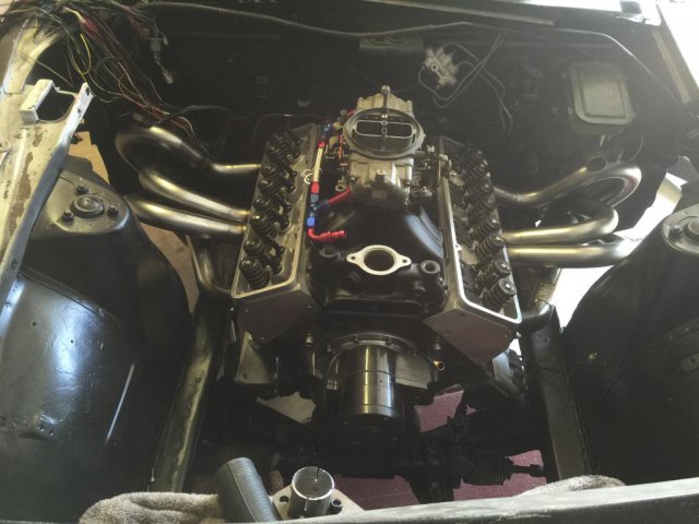

egzlilgituarboy9 Posted April 11, 2014 Share Posted April 11, 2014 Hi, Egzlilgituarboy9 and YoSammyT can you give some engine specs? Full roller motor, mahle forged Pistons, Eagle h beam rods and forged crank, custom grind cam, dart pro 1 heads, edelbrock super Victor intake, holley ultra 750cfm race carb, moroso road race oil pan, meziere electric water pump, custom long rube headers, ati harmonic damper. Quote Link to comment Share on other sites More sharing options...

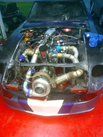

gunsaler111 Posted May 4, 2014 Share Posted May 4, 2014 78 z.... small turbo... Quote Link to comment Share on other sites More sharing options...
