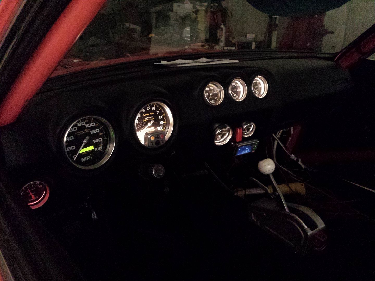

I’m going to try and get the dash in tomorrow. Also need to finish installing torque converter bolts. Then do A LOT of cleanup before final wiring.
