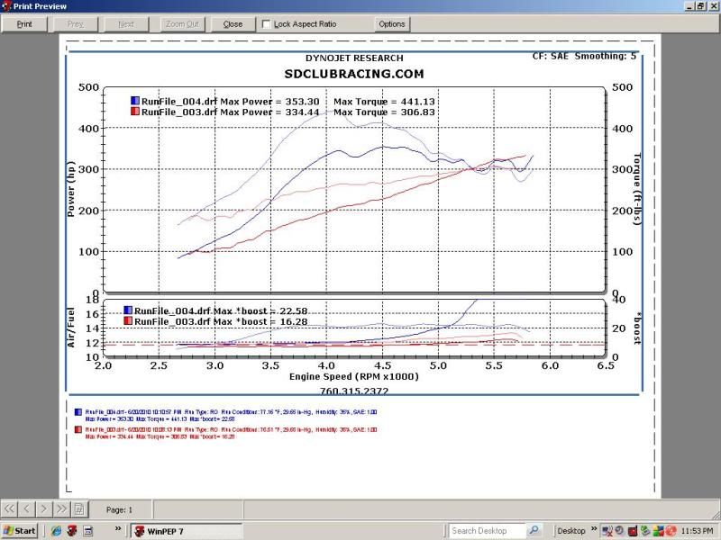

subtle_driver Posted June 27, 2010 Author Share Posted June 27, 2010 (edited) $150.00 throw-away (sr20de swap rescued) ka24de with $30 ebay manifold, $35 used 35mm wastegate and junkyard $80 holset turbo, Throw in $6 each Rx7 injectors with a $9 ford probe fuel rail (honda inlet hose), $20 stock turbo Neon intercooler, and stock ECU with home made chipped daughter-board ($20) Makes more power and a lot more torque than your average LS1 to the wheels. I'm not a hater, just saying that if you think you have yo have a lot of money to be fast, you are wrong! It just takes a lot of time and effort and knowledge and extremely well laid plans to make a fast car with less money. Don't throw away money on things that don't work effectively. If i had more money to spend.... Here is the Dyno sheet for all the lazy people to see! I only picked a couple of pulls, we made maybe 7 or 8 pulls and adjusted the fuel pressure, boost controller and timing map. I installed a Blitz dual solenoid controller for that day because I wanted to have a safety margin, on the dyno. You can see the dropping of power on the graph when the safety feature kicked in to lower the boost pressure. I was planning to do a 25 psi and up pull, like we did countless hundreds of times on the track and street, but the hp wouldn't have gone up much more with the stock 2nd gen cams, and I was worried about the stock rods handling much more than 400 foot lbs of torque. When i saw it made over 300hp on the 1st pull, i was like, "Naaah, I'm not gonna blow it up, I want to make the 40 minute drive home." lol. here are the videos, sorry about the video flip microphone getting totally annihilated by the turbo intake sound. Edited June 27, 2010 by subtle_driver Quote Link to comment Share on other sites More sharing options...
