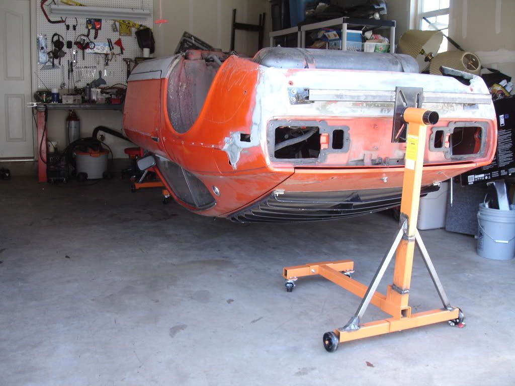

JMortensen Posted August 27, 2009 Share Posted August 27, 2009 to be honest it takes quite a bit of force to rotate the car.. well.. at least keep the car steady.. i guess I am tensing up my muscles to prevent the car from rolling too fast. It looks like you still have a lot of stuff bolted to the shell. Taking some of that stuff off will help. You can add counter weights so that it is less top or bottom heavy, a la zlalomz. Quote Link to comment Share on other sites More sharing options...
proxlamus© Posted August 27, 2009 Author Share Posted August 27, 2009 Hey John.. I pretty much followed your design the best i could via pictures.. could you do me a favor and tell me the center line of your stand? I dont have the height to flip the car upside down. Not like I really need to.. just want to lol. Quote Link to comment Share on other sites More sharing options...
JMortensen Posted August 27, 2009 Share Posted August 27, 2009 40.5". Looks like yours will flip. Quote Link to comment Share on other sites More sharing options...
JMortensen Posted August 27, 2009 Share Posted August 27, 2009 In thinking about this, maybe the offset of your mount is enough to cause a clearance issue. If you have a clearance issue you might lower the mount with your slotted setup. Quote Link to comment Share on other sites More sharing options...
proxlamus© Posted August 28, 2009 Author Share Posted August 28, 2009 I'm very proud of being able to do this by myself!! Its pretty astonishing to see a car upside down!!! The neighbors keep coming up trying to talk to me about it lol. I sat in my garage for about an hour just staring at it with a nice cold beer. haha. Oh and I cleaned my garage *hears clapping in the backround* PS - dont ask about the rear engine stand.. the diagonal support bar has extra steel welded all around it .. cause I ran short of tubing.. so I improvised lol. Quote Link to comment Share on other sites More sharing options...
JMortensen Posted August 29, 2009 Share Posted August 29, 2009 I'm very proud of being able to do this by myself!! Its pretty astonishing to see a car upside down!!! The neighbors keep coming up trying to talk to me about it lol. My next door neighbor, a sweet little 80 year old lady, loved my rotisserie (and the Z). Every time we have some type of get together here everyone gets a trip to the garage to check it out. I have yet to show it to someone who failed to be impressed, and yes, I still think it's cool as hell a couple years later... Glad to see you got it flipped all the way. Especially for things like subframe connectors, that really helps. Quote Link to comment Share on other sites More sharing options...

JMortensen Posted September 5, 2009 Share Posted September 5, 2009 Is it just me or is your bracket flexing/coming apart? Quote Link to comment Share on other sites More sharing options...
proxlamus© Posted September 5, 2009 Author Share Posted September 5, 2009 oh my lol.. it looks like it!! but its not. I'll take another picture when I get home. I purposely made the bracket that way with the 1x1 tubing at an angle into the 2x2 tubing. I was trying to get the 2x2 as horizontal and flat as possible. I know its not the best design.. but its holding. Ill take a close up picture when I get home =) Quote Link to comment Share on other sites More sharing options...
