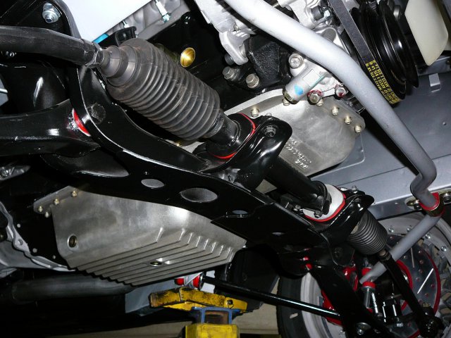

310z Posted November 9, 2009 Author Share Posted November 9, 2009 Oil pan is made of cast aluminim and finned for cooling. Oil pan is also baffled to keep the vital fluid near the pick up. Quote Link to comment Share on other sites More sharing options...
